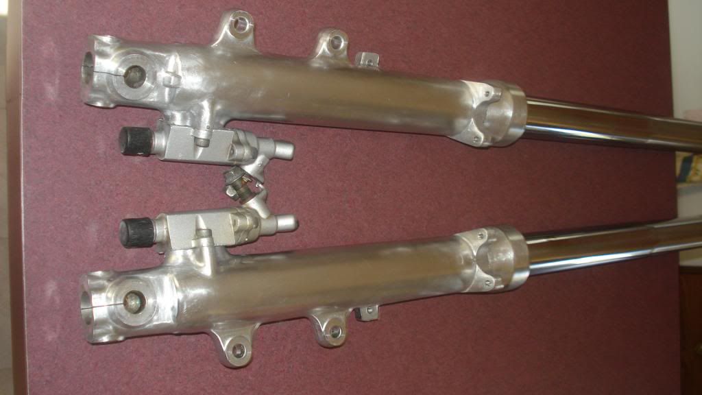

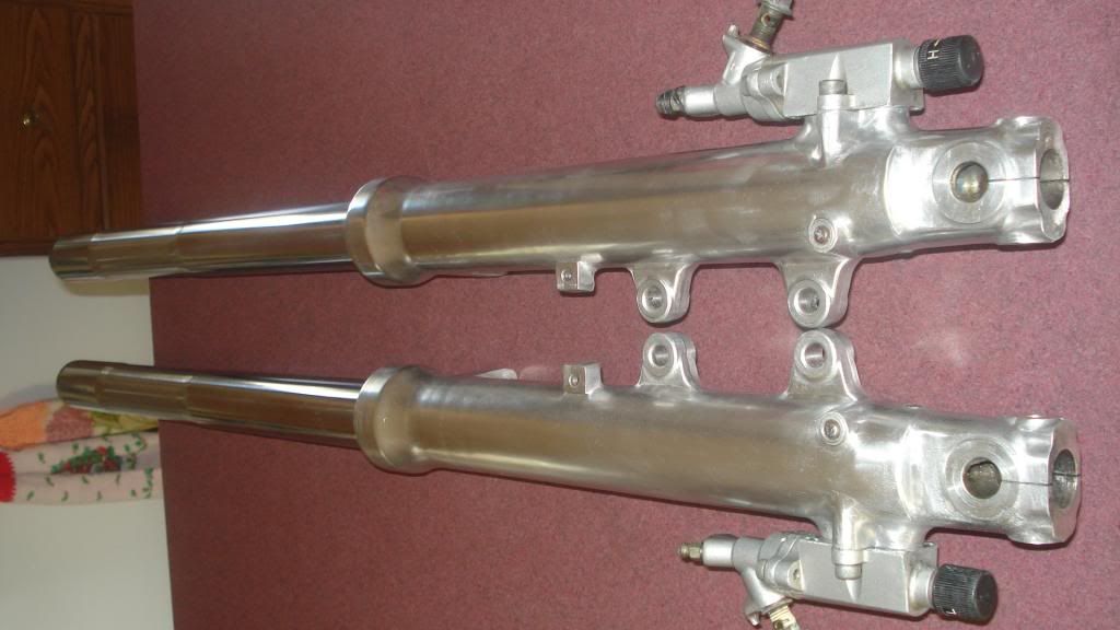

4 days work, about 10 hours of sanding on these not including stripping
the clear coat. They are actually quite rough from the factory.
I've seen pics of the guy that have done this on there bike here. :hi:
I dry sanded 100 220 and then wet sanded 400 then 600. There ready for polishing.
The factory polished areas were still rough. One brush of the sand paper reveals deep
scratches and unevenness. The rest of the surfaces look just like the rims.
I filed the casting lines and worked the areas around the anti- dive blocks best I could.
I won't break those seals now.

Try one of these. Makes life so much easier. Use Rouge Buffing Polishing Compound on the polish wheel after the brown pad to get the old clear coat off.
CraigO
CraigO

Quote from: craigo on January 01, 2014, 05:20:40 PM
I just recently got one just like that.   :yes:
I'll be getting some of the black compound stick, if that's what your talking about. I got the red stuff but I'll use that after the black. That's one hell of a bench grinder. I got a 1/3 hp ace hardware piece of...well, it isn't that good. My buzz grinder has more power and that's what I'll probably rig up with a buffing pad. I got my wheels to do also.
What did you mean by "brown pad"?

craigo
Quote from: Joe Sull on January 01, 2014, 07:05:52 PM
I used red, black, and white rouge.
The brown pad is like a cellious green pad, only not as abrasive and mounts of the bench grinder. Great for stripping off all the crude buildup and clear coat. Makes taking the forks down to bare metal a lot easier.
And yes Pat, your bike has inspired this work. However, as far as the headers,,,, I don't think so. I'm afraid of snapping a bolt or some such thing. You know the old saying about leaving laying shit lie..
