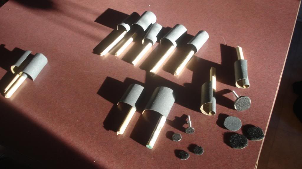

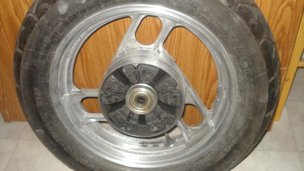

I sat down and made a bunch of sanding implements and with the advice of a board member, I started using Velcro to fasten my sandpaper to the bit. It works great and the sponginess of it takes the place of the neoprene pad I was using. I made a dozen little discs and can change them out as I go without stopping to glue them individually.

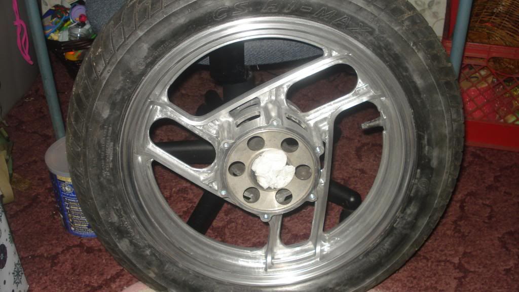

The front wheel is more difficult than the back and I've worked it 12 hours so far. I've removed the raised cast lettering and the casting marks which were on the side you see. My angle grinder with a 120 sanding disc., Cut half the dia off with scissors and no backing disc, Made quick work of that.
The rear has 9 hour of work. I'll be removing all the lettering on this rim also. I'll be removing the wheel weights and getting under those too.
I'm still trying to visualize how I want the wheels to come out.
I have an Idea of how much I'm willing to polish. I don't want to put to much more time into it. So the directions on the metalcast can say's "shiny metal surface".
For the last two weeks or so, I've been looking on the web to get an answer my question.  How shiny the bare metal has to be. I could not find it till tonight when I stumbled on to a kids post. He made a captain America shield and the post told me the answer.  100 grid. I've got it down to 220 now.

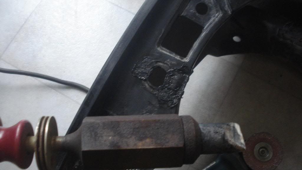

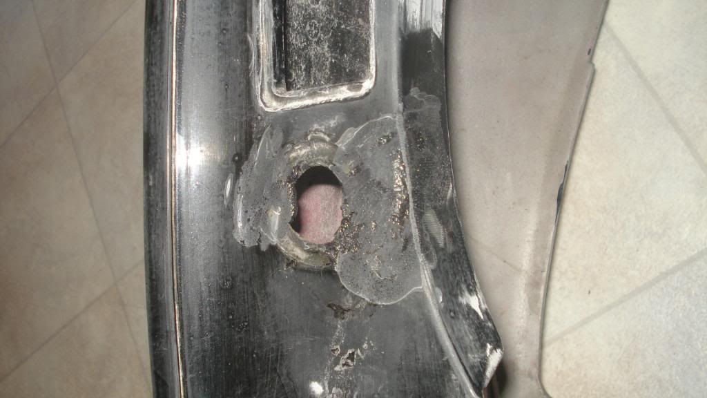

I had a good crack in my fairing and tried my welding skills. A buddy gave me one of the old lead melters that they used on bodywork
back in the day and it worked pretty good. I melted in some abs that I had from a old aquarium filter housing. I got it from both sides.
I got to clean up the hole. You guy have a cigarette lighter in yours? I want to get it working again for a charging output.
After I welded. It sank a little. Maybe if I heat up the area a little more and make sure it stays straight as it cools.
After I hit it with the sander. I could try some jw weld or just sand it a little and see what it looks like.

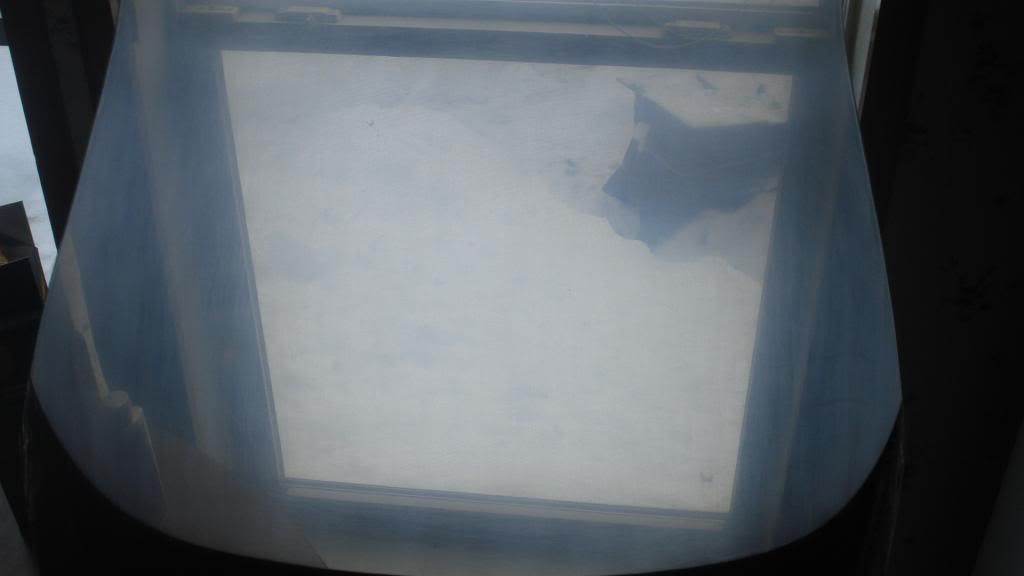

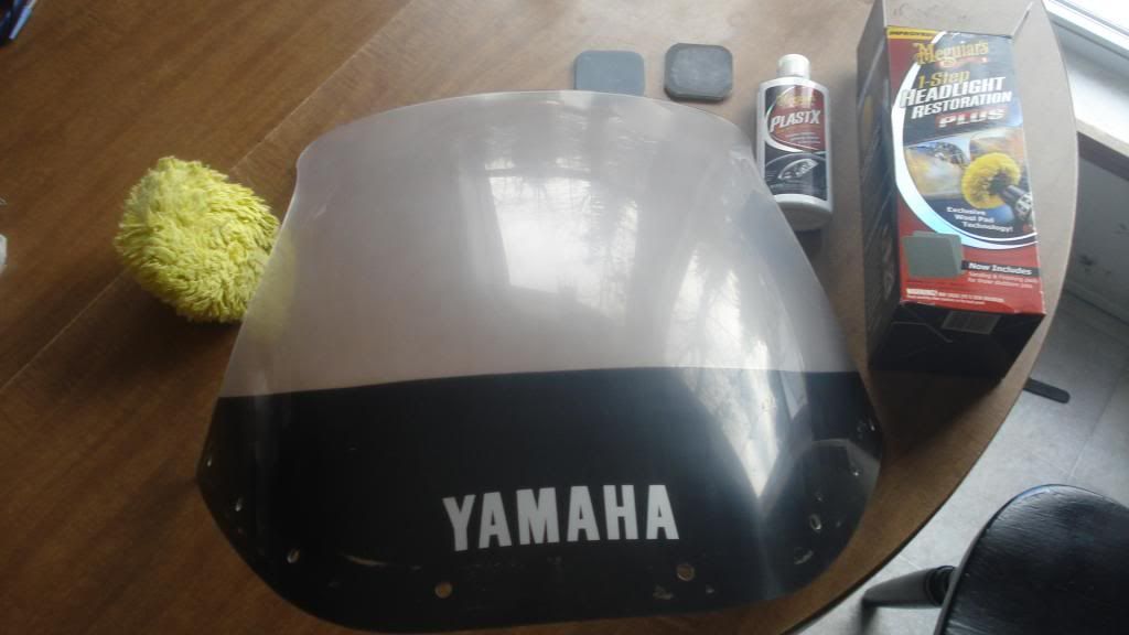

My windscreen was in bad shape so I used the Meguiar restoration plus on it today.
I cleaned it when I got the bike but it made no difference at all. Yellowed and stained
on both sides. The kit comes with 2 little sanding blocks two different grids on each
side ranging from 1800-2400 and the polish. I've already used the kit on my cars headlights
and wasn't sure how the sanding pads would work the second time around so I started
with some 1000 grid I have for my paint job.

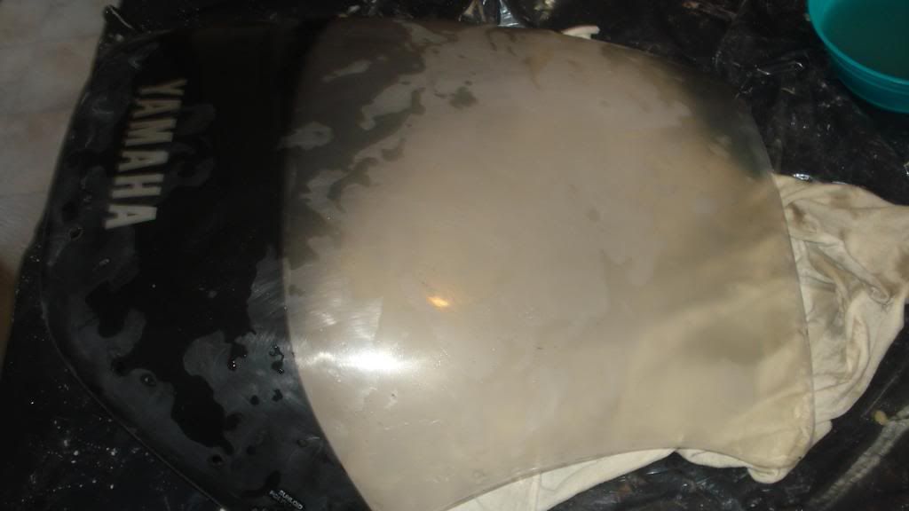

Here's a shot after the 1000.
Working up and down then side to side, I went thru all the kits sanding pads.
Here's a few shots after I finished sanding.
When it came to buffing, I didn't think about it but I found out that I couldn't hold the part
and buff at the same time. I guess I'm not finished buffing yet. The screen has to be bolted
to something so I can have both hands on the drill. I think that if I put the drill in my vise and
then I'll have two hands on the screen, that will work too.

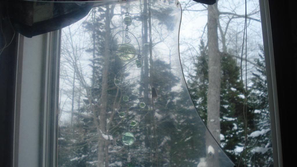

Here's the screen after the partial buffing.

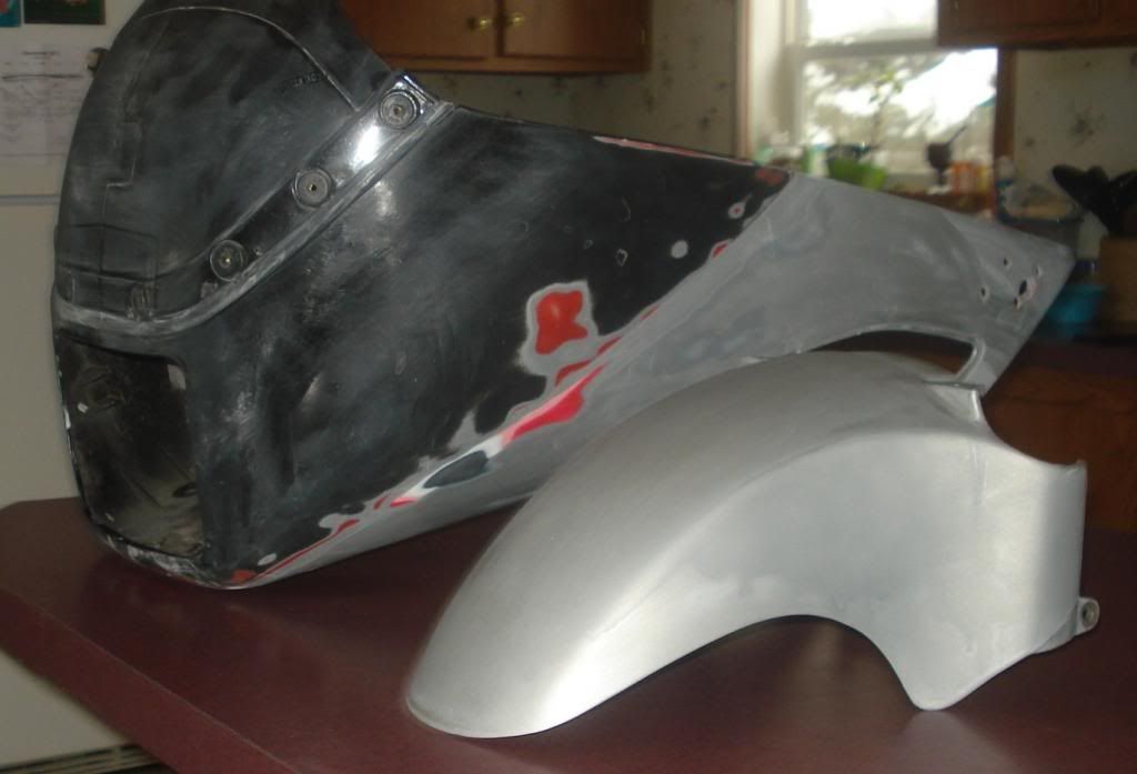

I made my final pass on the fairing and my front fender. Ready for paint.

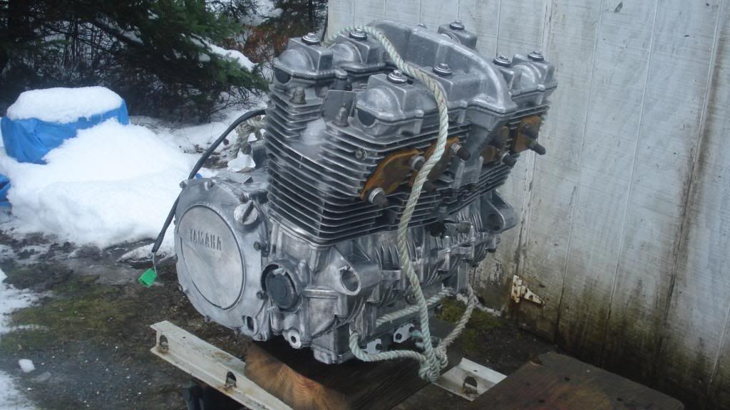

The temp. just made it over 32 deg. today and it's going to be warm thru
the weekend. I'll be able to pressure wash my engine. If I can get that done
I can paint it. My sons got a wood stove in his shop so that's were all these parts are
going next.

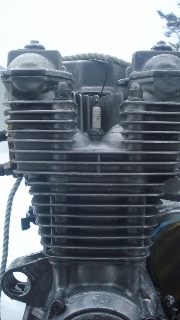

I'm happy as a clam cause I got to pressure wash my engine today.
I borrowed the washer a week ago and have been waiting till the temp
got above freezing. It was 38 deg this morning. I made a sling so I could lift
the engine and bring it outside. Everybody I know went snow machining today.
Just me to get it done. I smeared the last of my paint stripper on the spots
that needed it and let that sit while I set up the washer. She came out good.
One think that I forgot to do is face off the fins I want to polish. I started to but then got
sidetracked. I still got to clean with prep so I guess I can face off those fins, blow the
shavings off and clean with the prep.

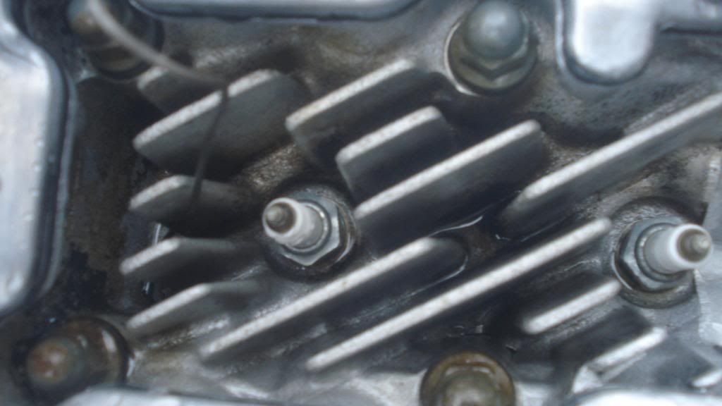

What I was real happy with was the way the top of the head, between the fins
came out. That's were most of the paint stripper went.

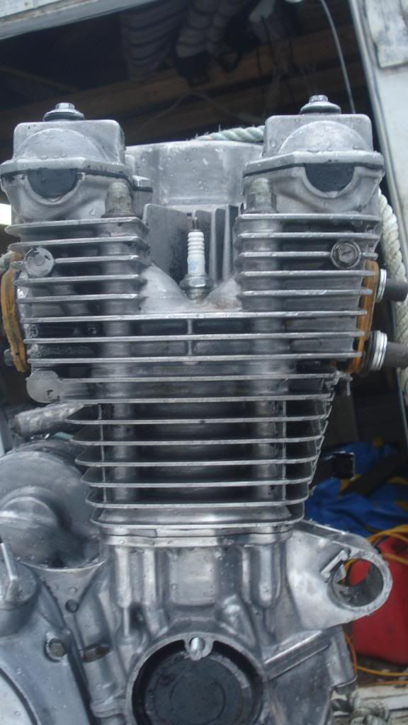

and here's the bottom
There's still a few spot of black but I'm happy with it. Looks good from my house.

Getting the windscreen buffed out looks great.  :good2:
Thanks Fred;
I saved a tidy sum doing that. I'm glad the screen was made out of a good material in the first place. It must be a good lexan.

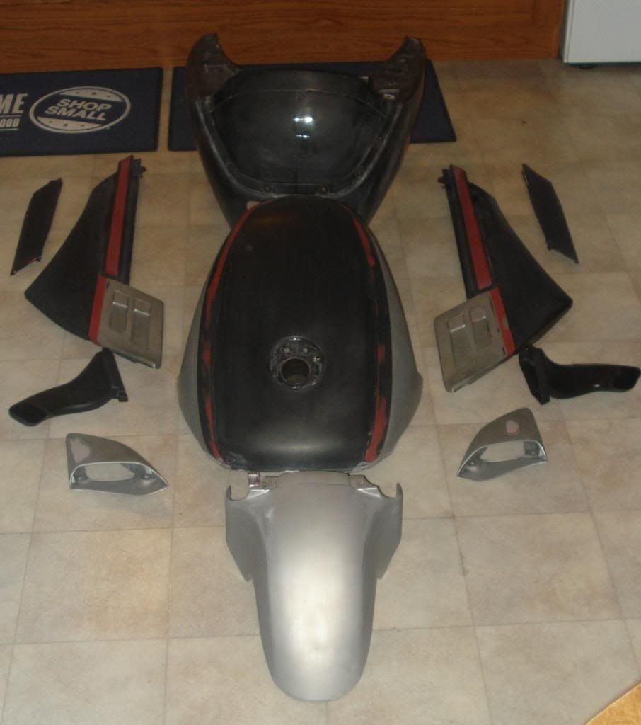

4 more hours on the tank today finished the body prep.
Generator is coming along. A few more times around with sandpaper and it'll be ready for the metalcast.
