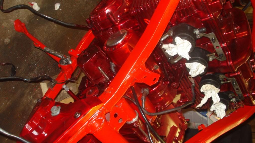

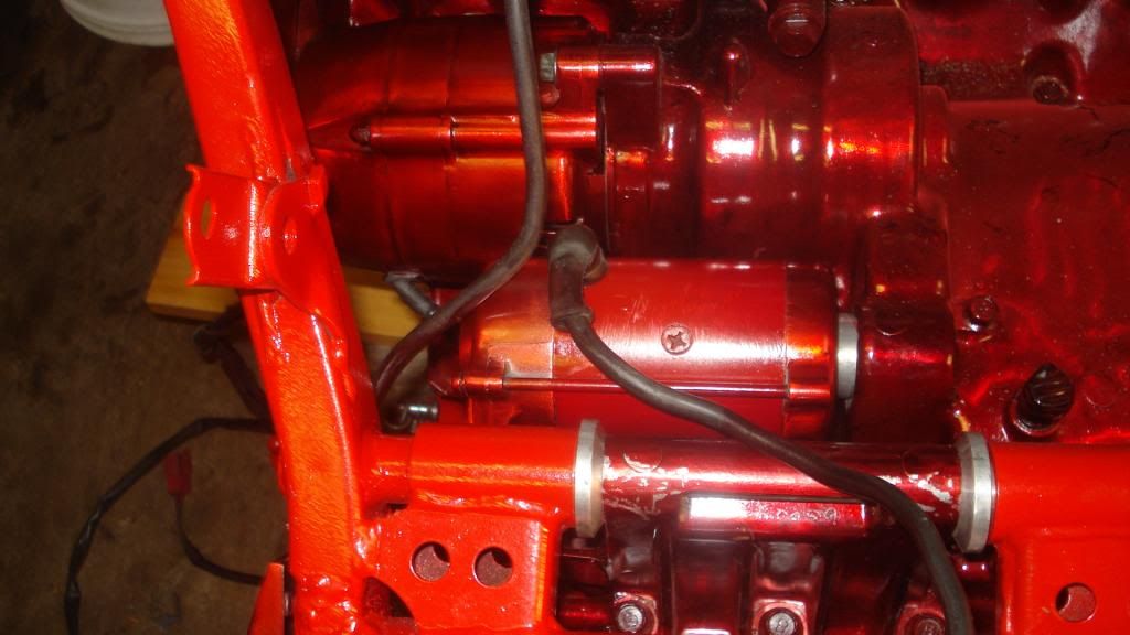

I thought the starter housing mounted closer to the upper case. Is that right?

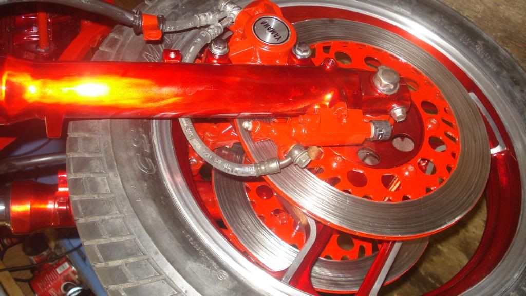

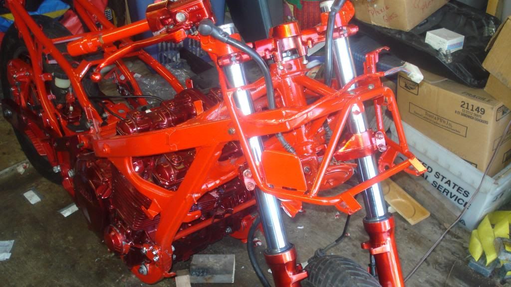

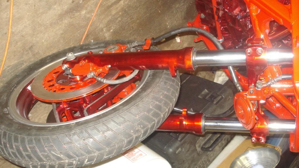

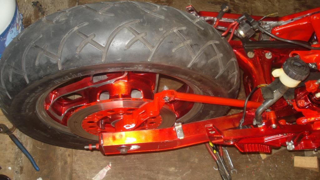

I got the anti dive block painted last night and assembled the front wheel.
I got her back on the kick stand. I'm pulling that stupid stand switch like a bad tooth.
I drop kicked it across the dooryard.

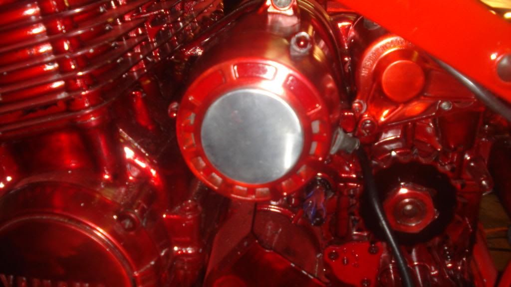

Painted the crown nut and got that on. The clipons make it look like a bike again.
I want to try to squeeze that 1" lower out of the fork tubes. I can go another 3/8"
till it starts getting into the taper.

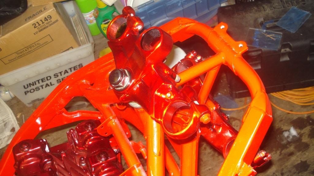

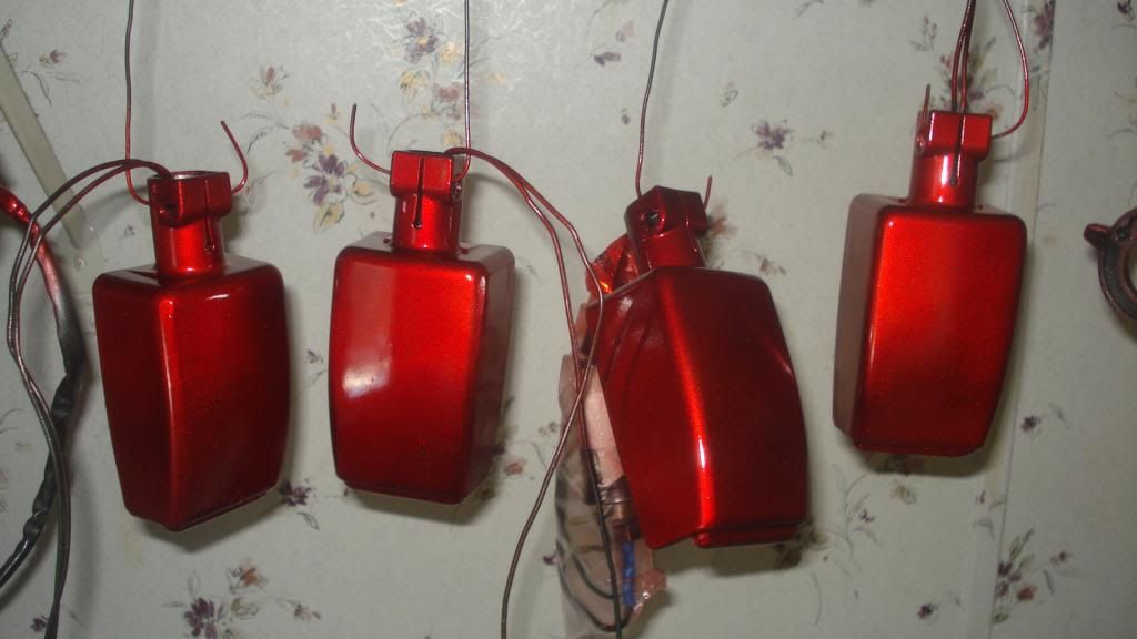

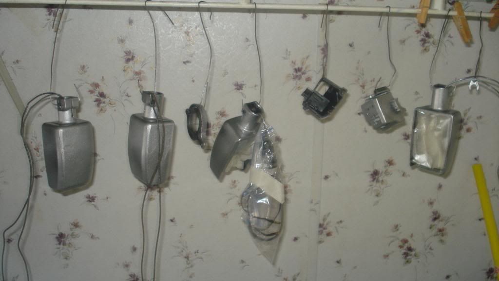

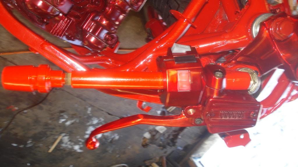

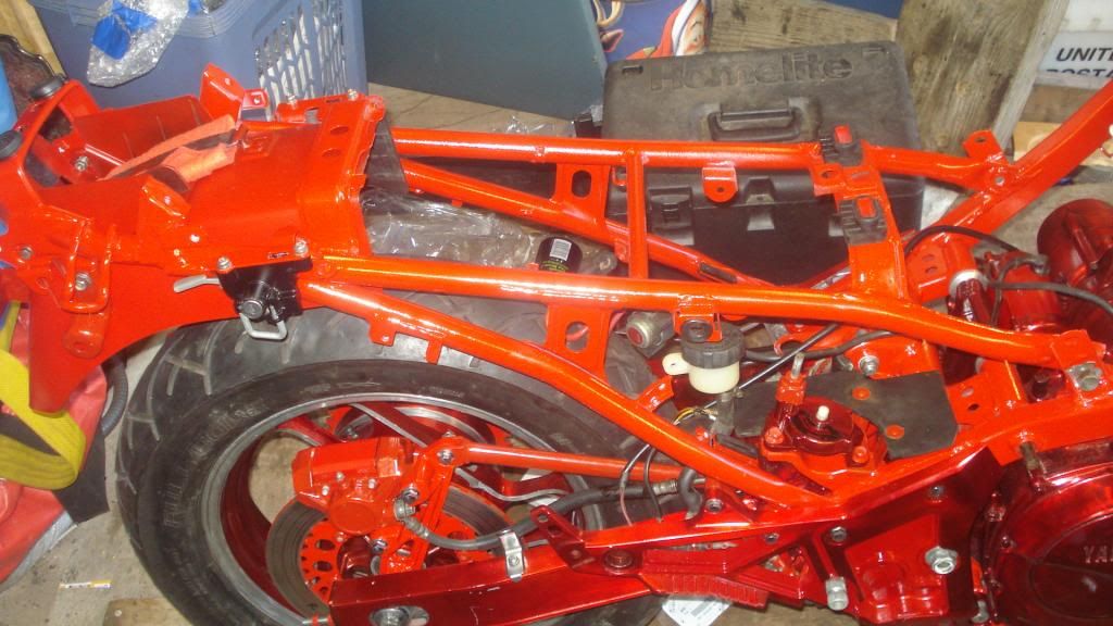

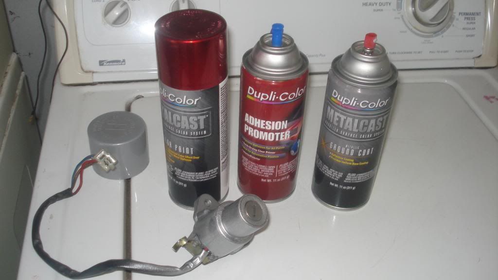

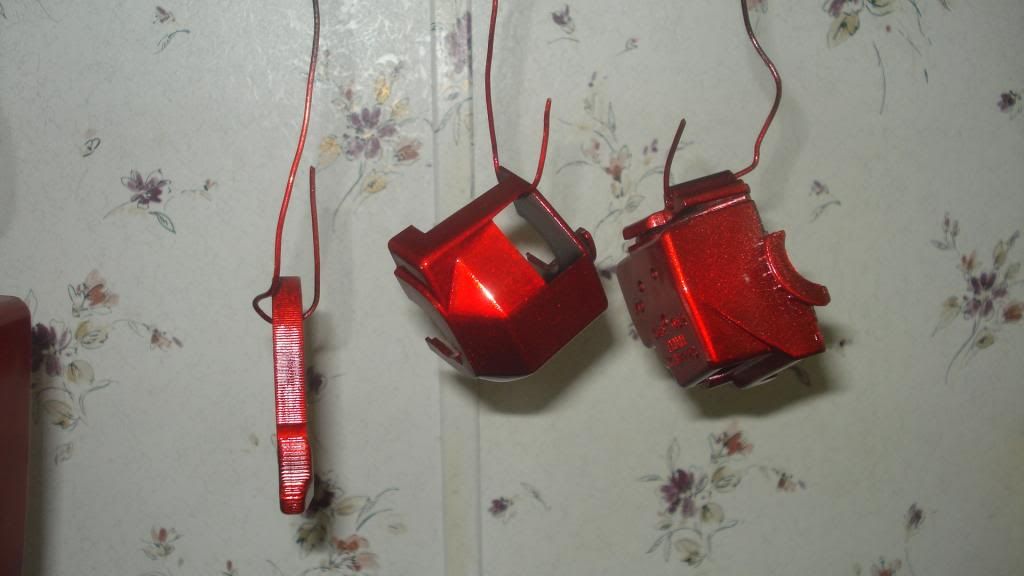

I had some more plastic to paint and I will show the steps I took.
They tell you to use the adhesive promoter after cleaning. I washed all my parts with soap and water
and ended with using alchol. Within 5 mins. after the adhesive promoter comes the ground coat, metallic silver, 10 mins. .
Two coats of metalcast 10 mins. each. It was 25* today but I just step outside and spray real quick.

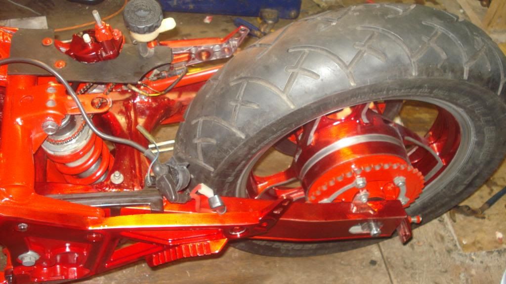

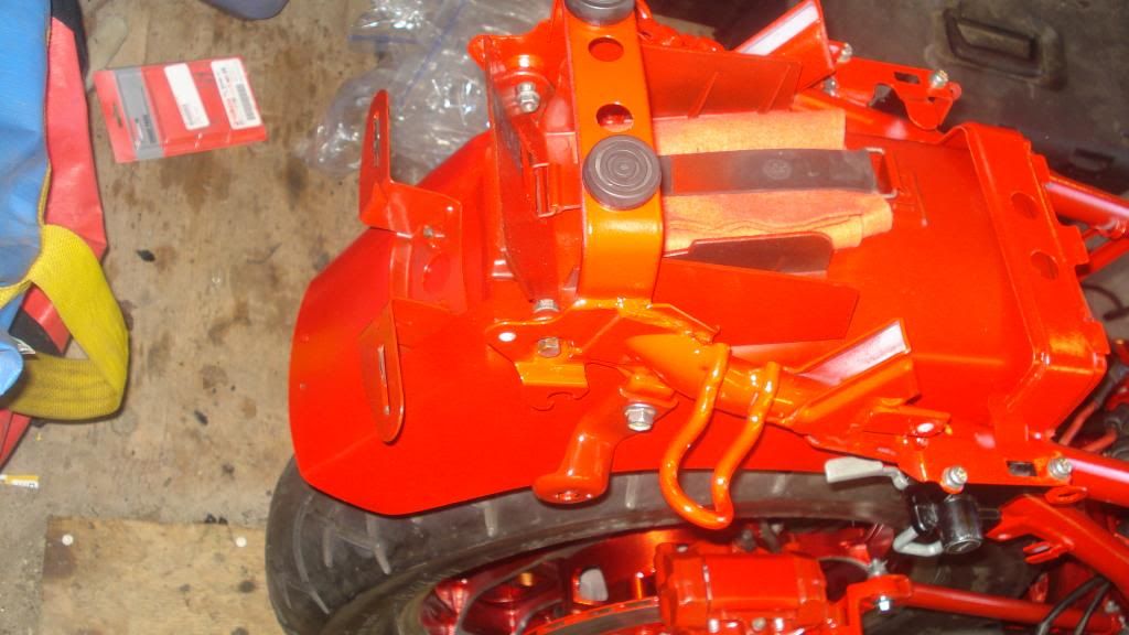

I got the tail section, fairing frame and the rear fender on then I got a few more things on the
handle bars. Those seat lock things will stay black. I went thru enough taking those apart cleaning
and greasing them.

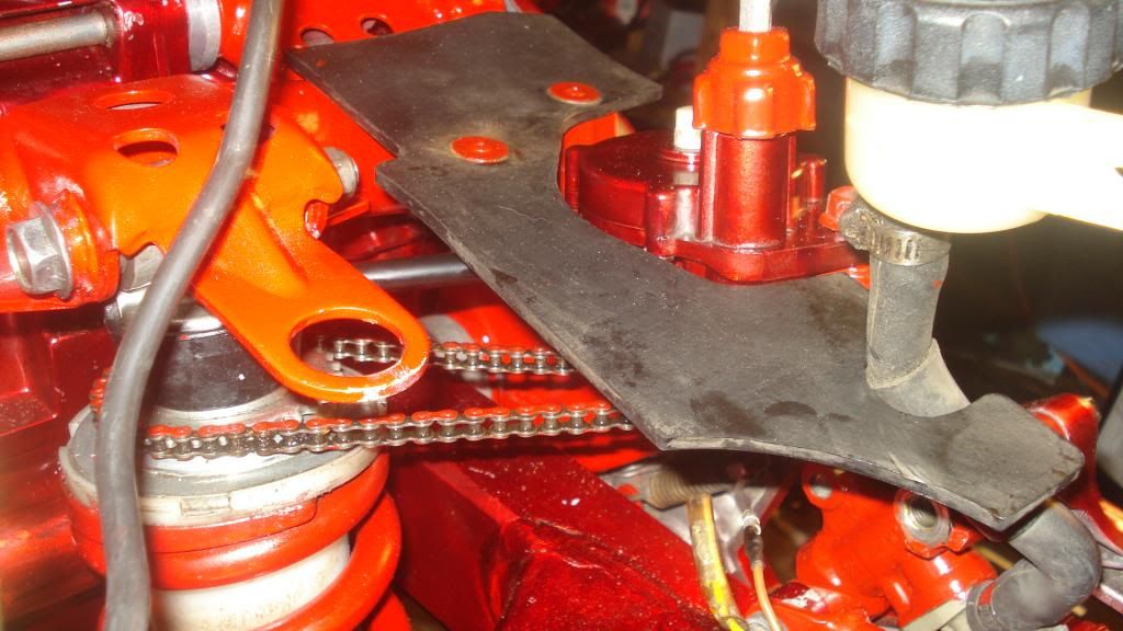

I got all the brake pad in too.

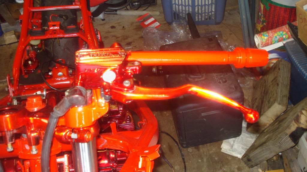

I got the right controller on.
Three dimes and some jb weld took care of the old crusty sight glass, cluch MC. I didn't clean the oil
out of the oring slot so maybe I'll be able to remove it to install a new glass.
