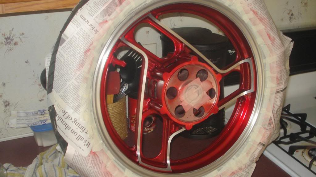

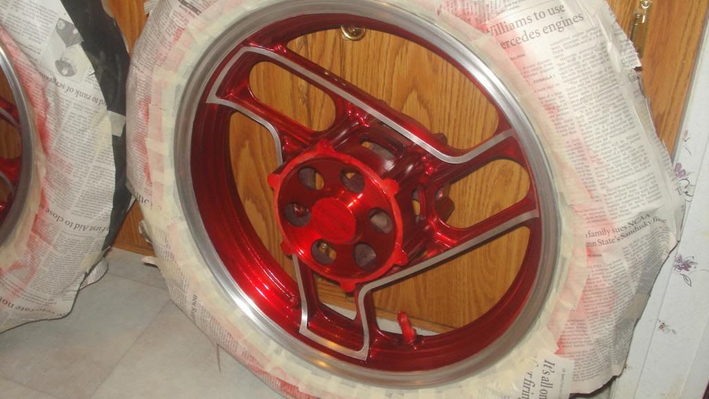

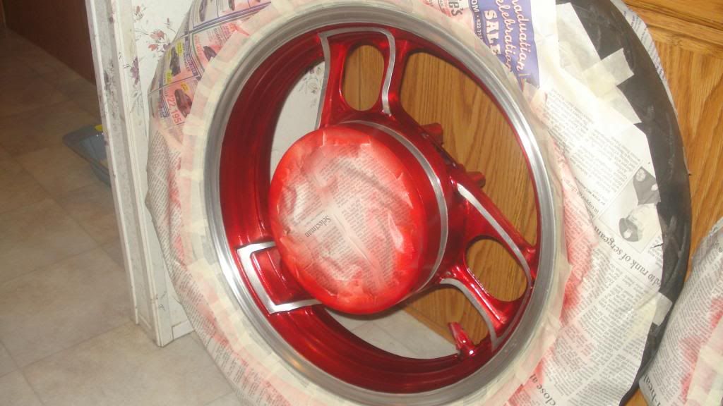

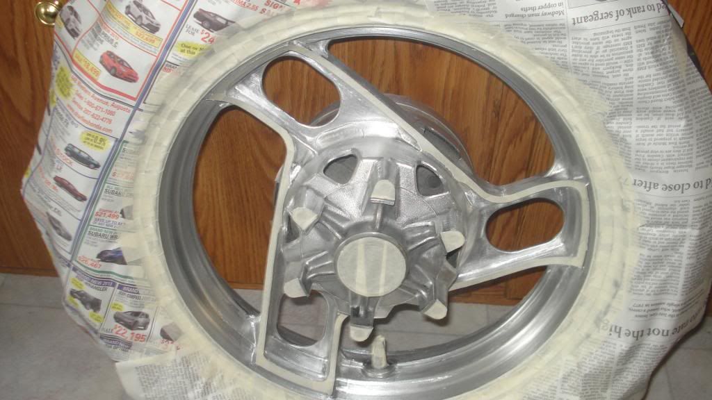

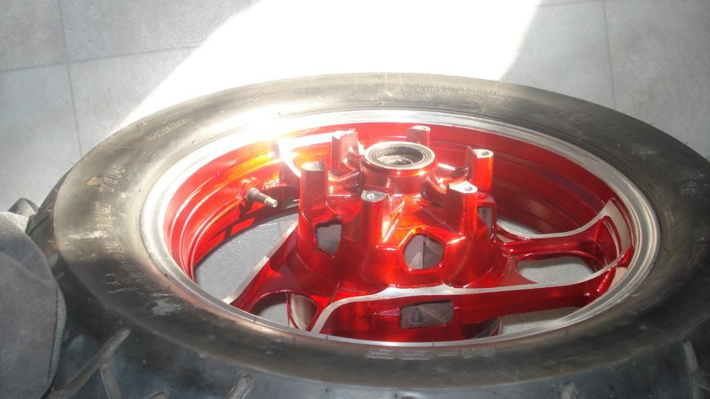

Three hours masking
Ready for clearcoat tomorrow.
Joe, what are you going to do with the center of the wheel that is exposed but you only fogged with color?
What the hell was I thinking...They got a saying up this way. "Dawn breaks over Marble head" and it's used as a double meaning because of a place on the shore, down in massachussetts called Marble head where people go to watch the sun rise. I had it in my mind that the rotor covered the area. Thanks for spotting that. I'll fix it tomorrow.

I fix the front rim by getting the metalcast on that center area and I got the rear wheel caught up with the front.
Almost had the clearcoat on but it started raining. I guess tomorrow.

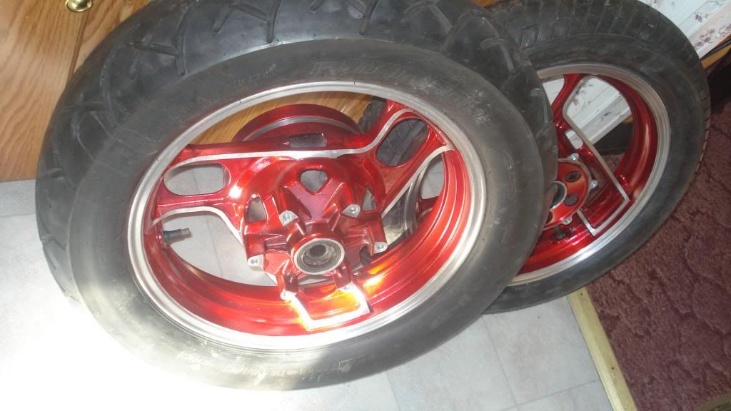

Wheels are clearcoated and completed. I'll be painting the rotors and the sprocket with the frame, Hot rod red.
They glow in the sunlight. :biggrin:

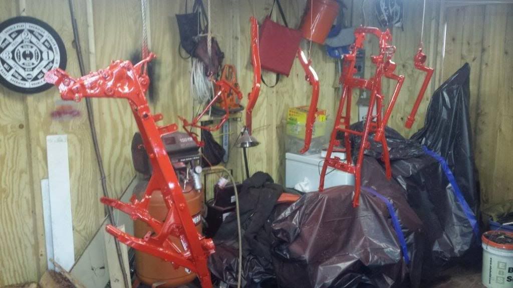

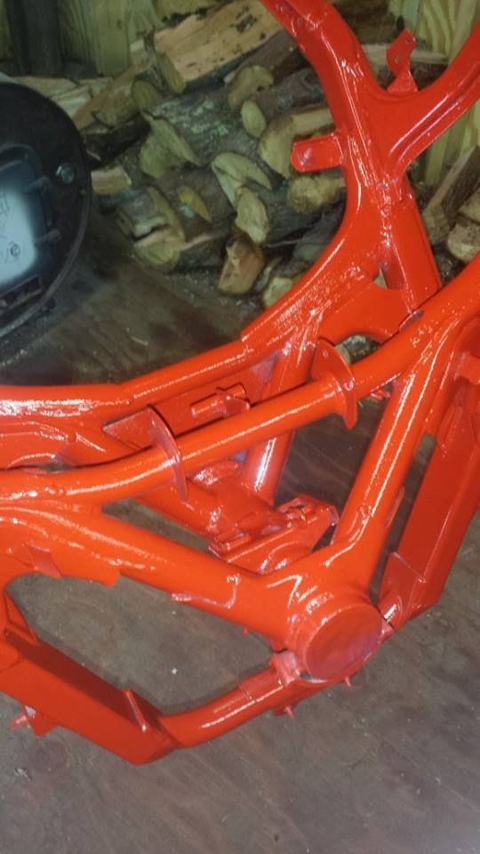

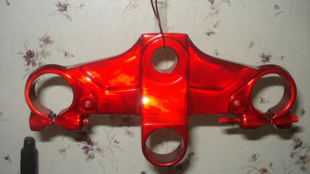

Just got back from painting the frames, rotors, kickstand, sprocket, clipons and hub over to my sons. :biggrin:
Here they are with 3 coats still wet. Hot rod red!
My son took these pics with his phone and posted on facebook then I copied them.
I'll get pics of the other parts tomorrow.
They should darken a bit. The camera makes the images look more orange than they are.

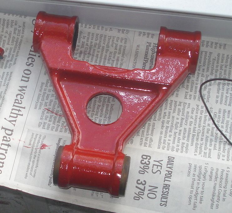

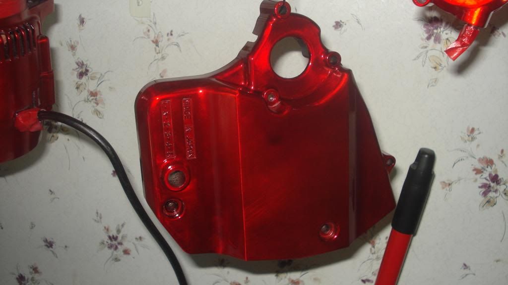

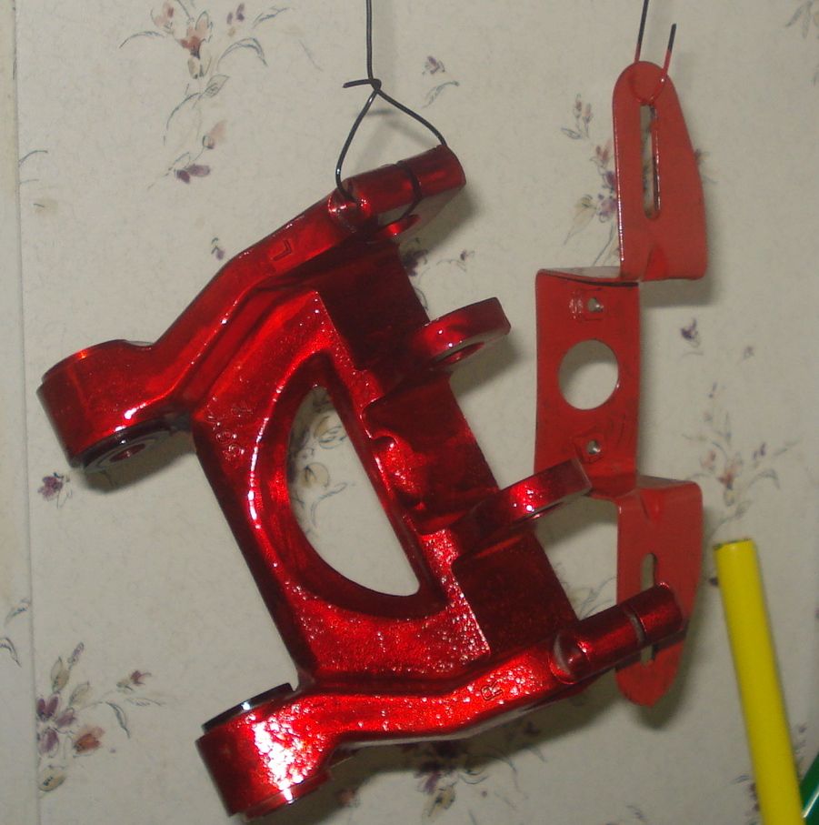

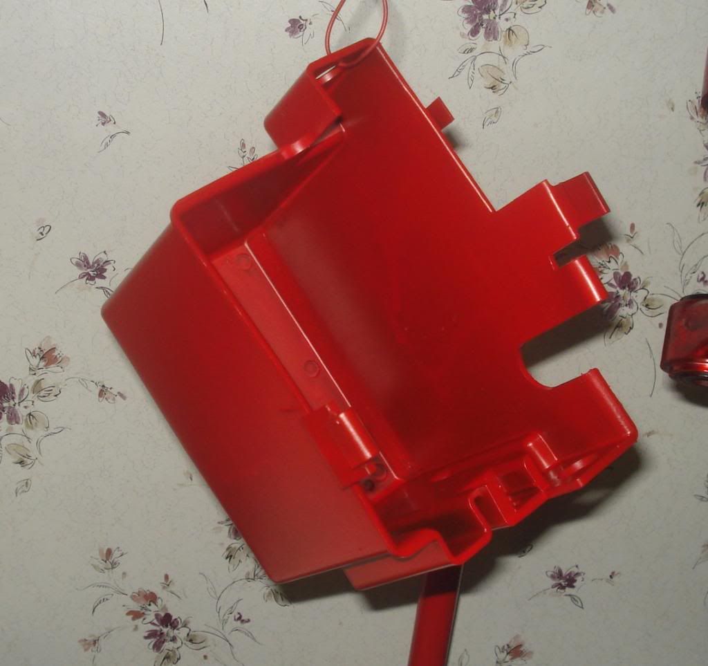

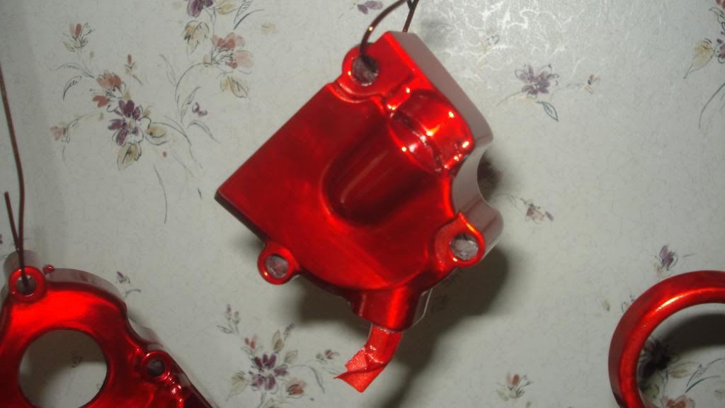

I got some more parts done. here's the battery box painted with 2 coats of the duplicolor adhesive promotor and 3 coats of vinyl and fabric red. I got the fenders ready to paint.
Couple of othere pics

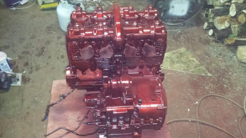

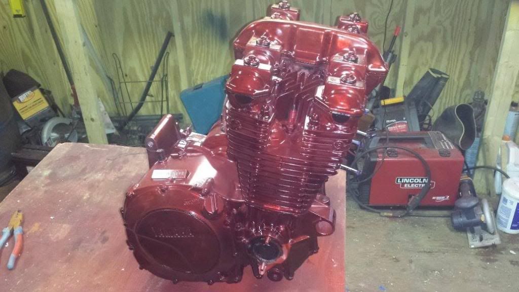

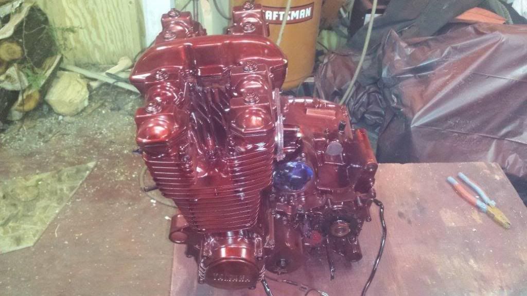

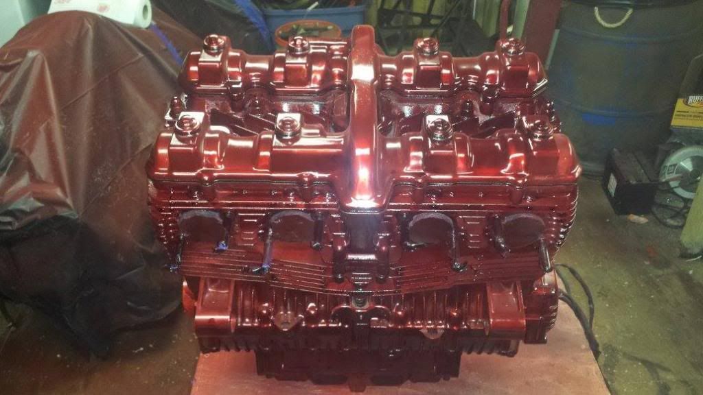

Engine is painted! I still haven't got the blind plug cover repair done yet. The last 3 days has been the only time I've had to do the painting. Temp. has been really cold and keeping his wood stove going just to set epoxy would be dumb.
My son kept the fire going last night for the frame. It is dry to the touch and we hung all the parts on the wall for another night and painted the engine.
The temp's going to be around 30 deg tonight. I brought over a propane heater to help and he'll load the stove and turn the heater on before he goes to bed. Tomorrow nights low is going down to 0 and Monday -7 so I'll pick up the parts and bring them home. The frame parts should be good outside by then but the engine will have to come in the house for 7 days till it cures. My wife's going to want me to put it under the kitchen table. Ha!
We will see if this stuff is going to hold up.
For better or for worse, it's done
The engine looks awesome. :good: :good: :good2: I hope it holds up well with the engine heat.
fj johnnie
 Very nice. The best way to learn is to try. That motor looks evil!!!!
