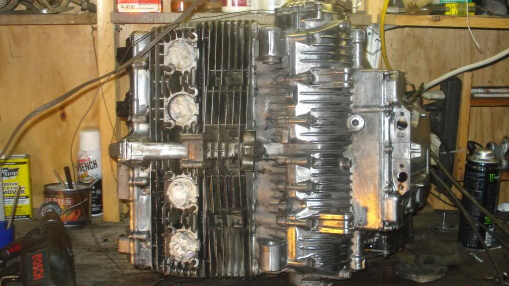

Joe, that is quite ambitious to plan on polishing the engine case, cylinder and head.
Any drips on the hot polished surface will stain. It can be polished out, but still...

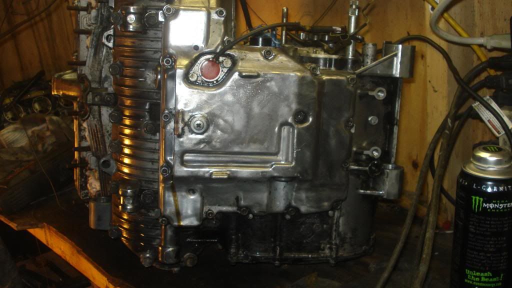

Pat, I'm planning on painting the cylinder block red flame paint. I still want to get the black paint out and clean the metal so the new paint won't chip off because of the old black. There is'nt much black paint left because of the age. I'll face off the outside edge of the top 6 fins and polish those edges.
Most of the casings will be red anodize coating. The casings only have to be shiney for the anodize to look good.
The covers will be polished and clear coated. Red paint in the yamaha letters instead of black.
I'll probably polish the heads as much as I can.

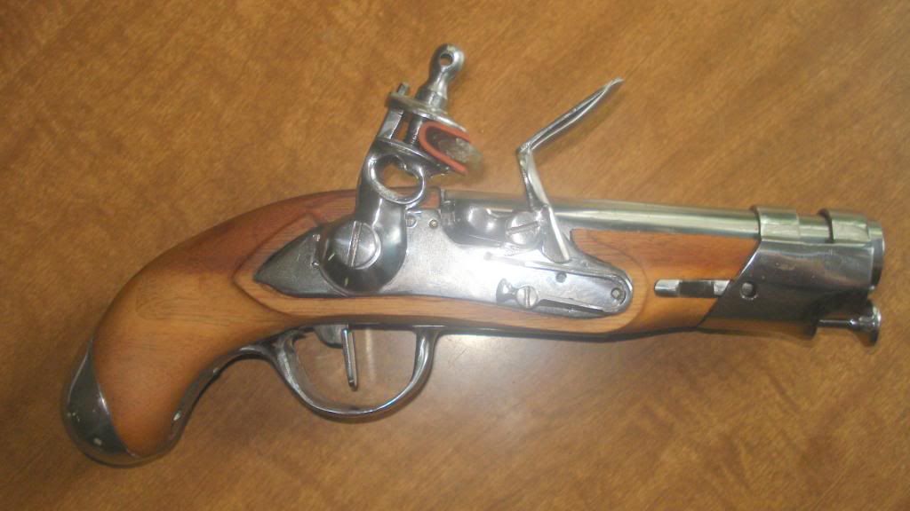

I build my own blackpowder pistols from scratch. I fire forge my flintlock parts and polish them up. The last one I built took a year. I AM gonna drive this bike in the spring!

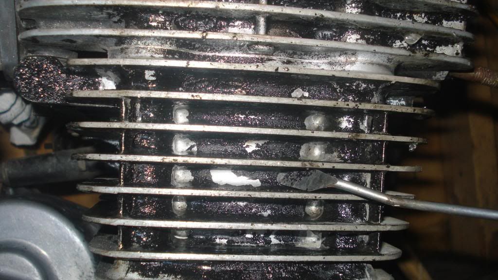

I tried the Zip Strip brand on the engine paint and it did'nt do anything. I can use it for something else but I need more power. Stronger, longer and harder paint stripper.
You Keep What you kill
Joe Sull

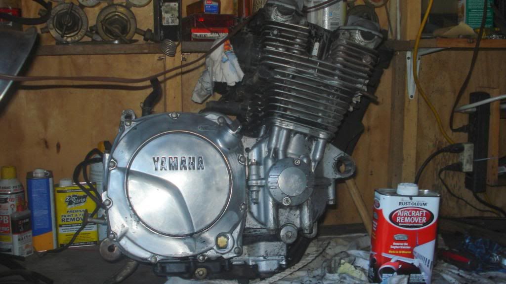

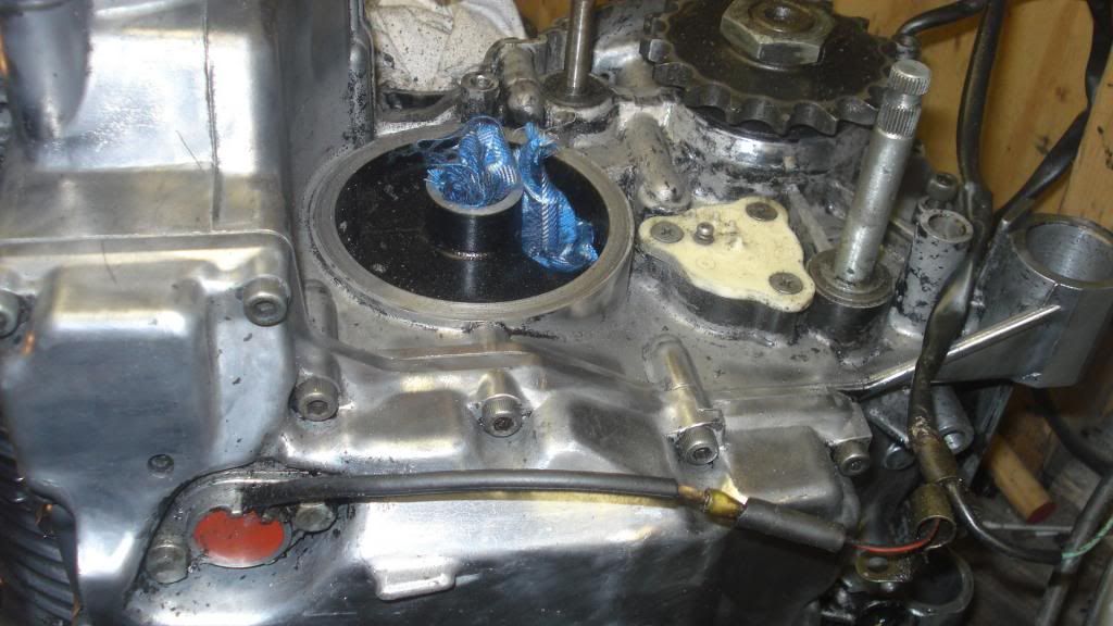

Needed to take some time to rethink how I gonna get the black paint off the motor. Read 10 posts or so on different sites and I read that "Aircraft Remover" is the best paint stripper on the market and that Home Depot sells it. I gotta get me some.
I'm doing this project with very little to spend and even after I use the aircraft remover there going to be a lot of black that just won't come off. I'm going to end up using the dremmel and I don't have the money to burn thru wire wheel bits. This is what I need to overcome. Somehow I need to make a abrasive sanding bit tool with what I've got in the shop.

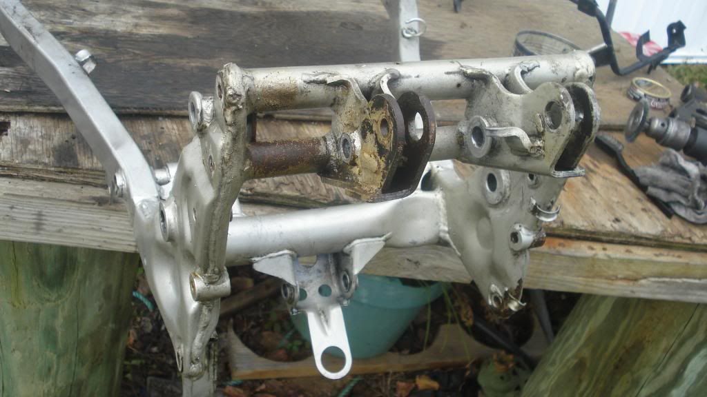

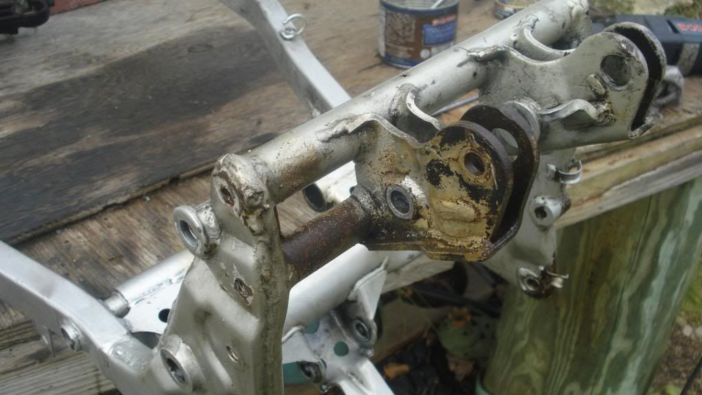

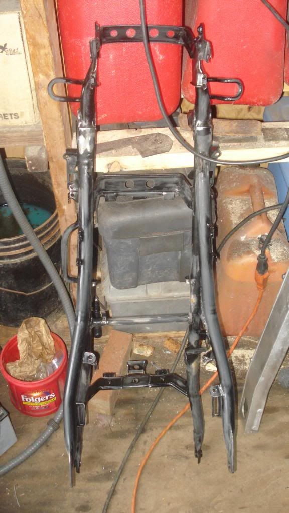

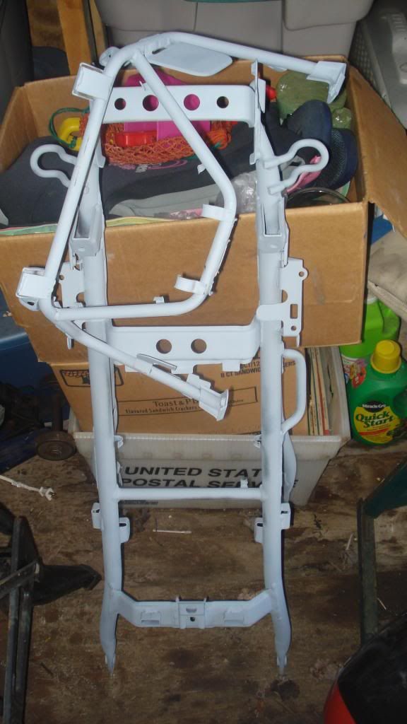

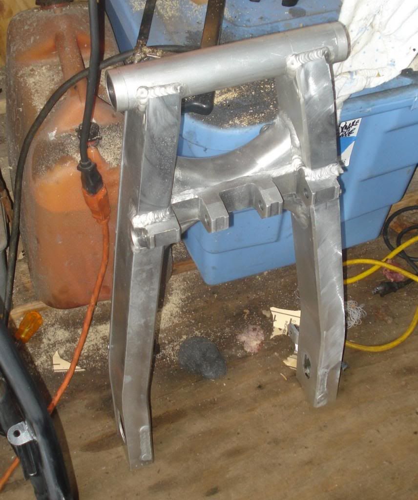

In the mean time I started on the frames. I got the swingarm half done. I need to hit that with the paint stripper to get the clear coat off. The tail frame is half done. Started wet sanding it yesterday. Today I disassembled the main frame and started degreasing and wire wheeling. I want to get it to the point where I can take it on the road with me when I go to work.  I can wet sand and prep it in the motel parking lot.
A few pics.
I'm waiting for a big diving job to start. I'm on call to mobilize. In the meantime I go clamming for a little extra money. Once I get the call, I'll be sitting pretty good for the winter. My son bought a paint sprayer and a water separator and he's going to paint it for me but I still got to buy paint.
Looks to me like I caught this just in time. Starting to rust. The welds look ok. I haven't seen one that's cracked yet.

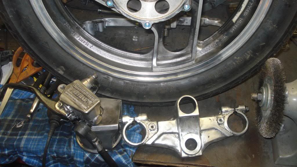

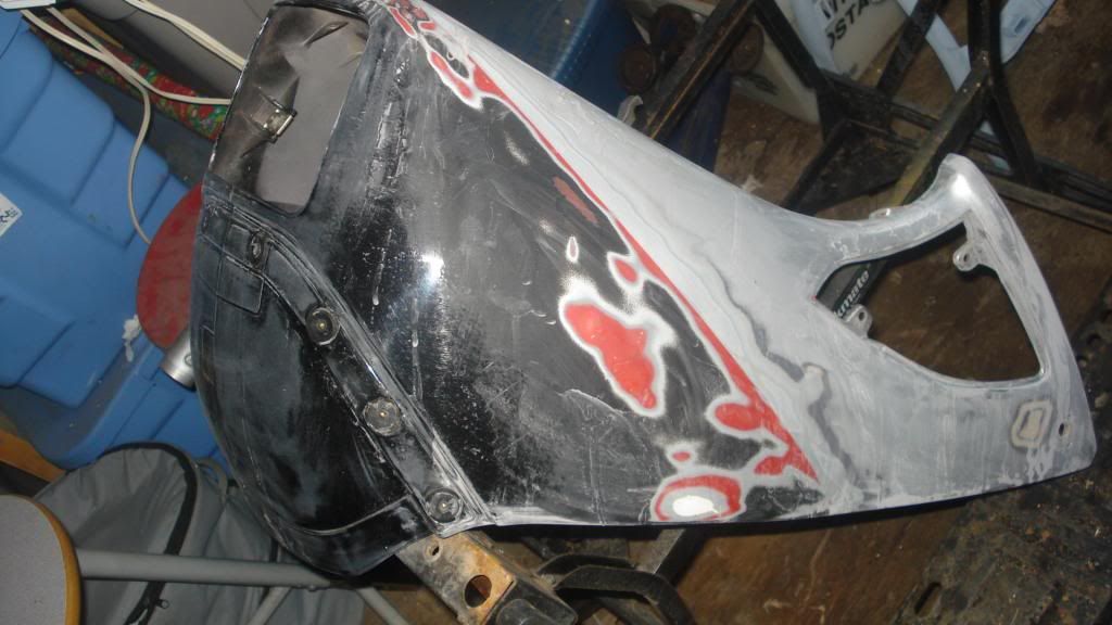

A couple of pic of my progress and a question or two.

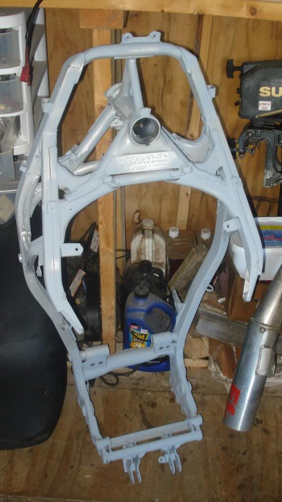

I got some frame ready for paint. I guess I'm gonna paint the frame florescent green. I change my mind every day just about. It's pretty fun to think about.

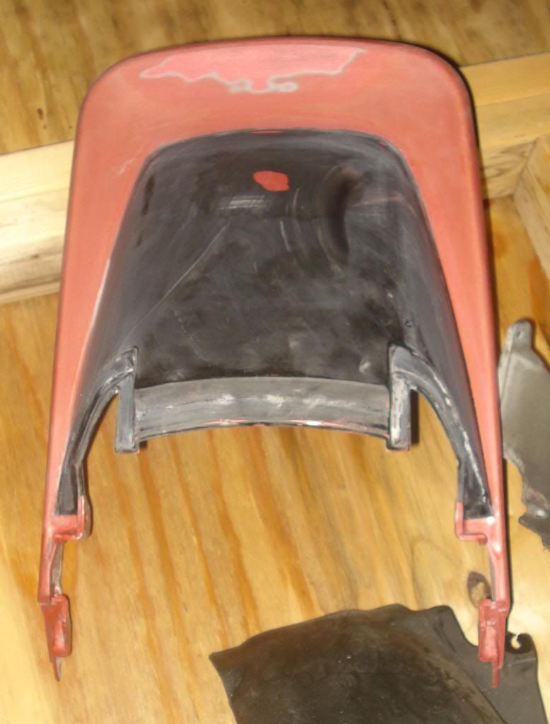

The decals came off pretty easy with a razor blade. I wet sanded with 320 but the scratches needed some 150. The tail piece had a line decal that separated the two-tone paint. That was difficult. The only tool that worked for me was a jack knife. Looks like somebody sat on the end, there's some cracks in the paint that go down to the plastic. I mite go a little deeper sanding there.
I finally got some stripper that works.
A question about the rear shock. Can that be taken apart so I can paint the coil and clean good?

Joe, I have found that a skinny wire wheel on a cordless drill works well in those locations (Wear a face mask)
With the flex of the spring, I have not had good results with painting. Perhaps powder coat? Dunno.
