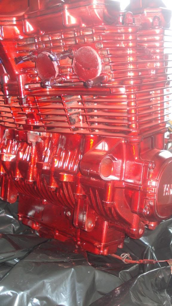

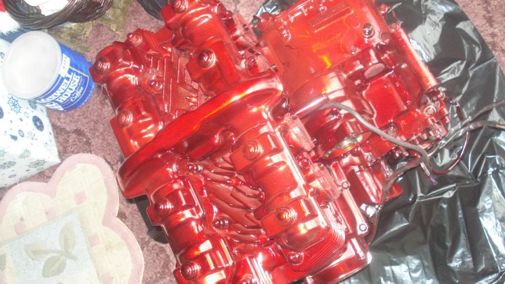

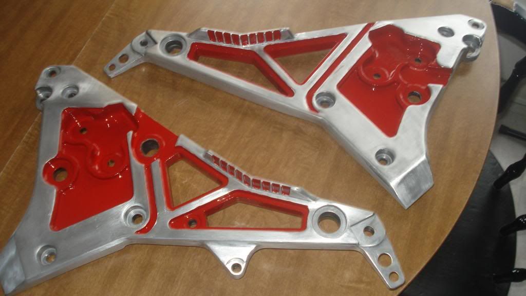

Thanks guy's. My son camera phone does strange things to the color. It must be the flash. I got the frames and the engine home today and brought the engine right in to the spare room. It says on the can, 7 days to cure. The frame is cured and hardened right up and will stay in my shop.
I took some pics with my camera to show the color better. My flash shines orange back but it shows that is red and not a Burgundy color.
I can still see a few black spots I missed but I'm good with it.

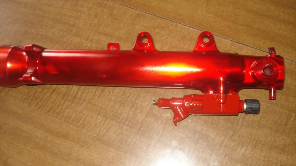

This pic of my frame with a close flash shows red /orange
I really dont want to make a mistake here. I rather just paint the body the hot rod red.
The engine shines red / orange in lots of light but it does the same thing in low light, Red / pink.

Hey Joe, You can't leave the motor like that, all that time and effort you put in to get all the old paint off and make it shiny, it'd be wrong not to touch it up. Your other parts especially your wheels look great.

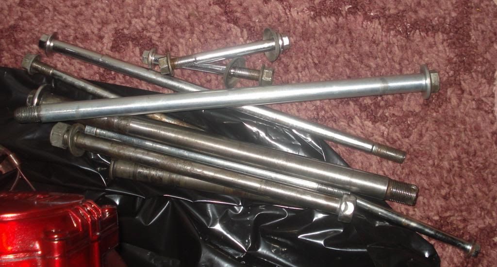

I got to draw the line somewhere, Tony. This whole thing's seems kinda crazy. Soaking all the hardware in pine sol and scrubbing them with a toothbrush? Come on, I must loosing it. Of corse all heads of the hardware have to be painted red and after dry be lightly oiled.

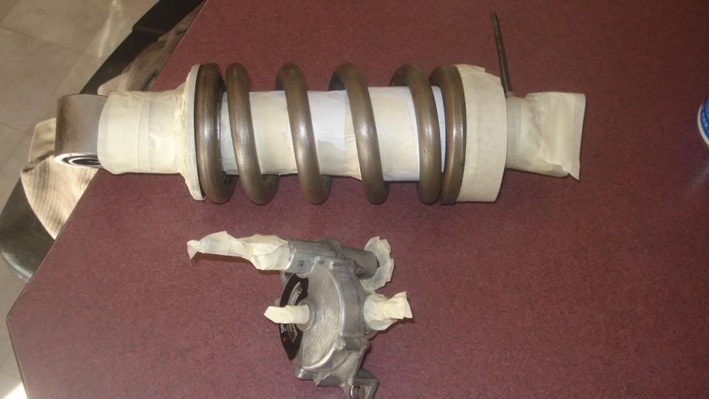

I thought the body of the shock was silver painted steel but it's aluminum. I sanded it and I'll clearcoat
the whole thing after I spray the coil. I might try the fabric and vinyl just to save money.
It should work. It's flexable. I got a little aggravated getting the paper inside the coil.

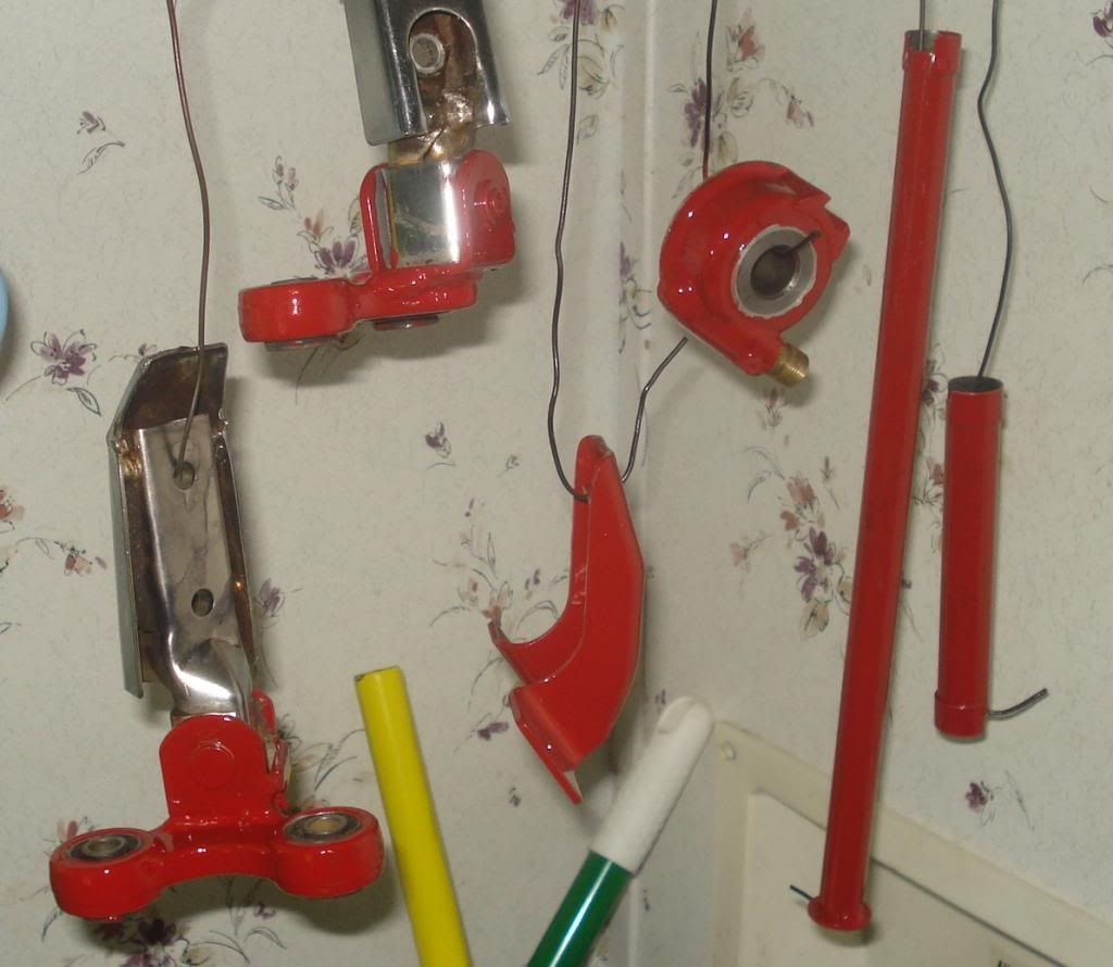

All morning and into the after on these two.
Can't spray paint again today. 5* outside.

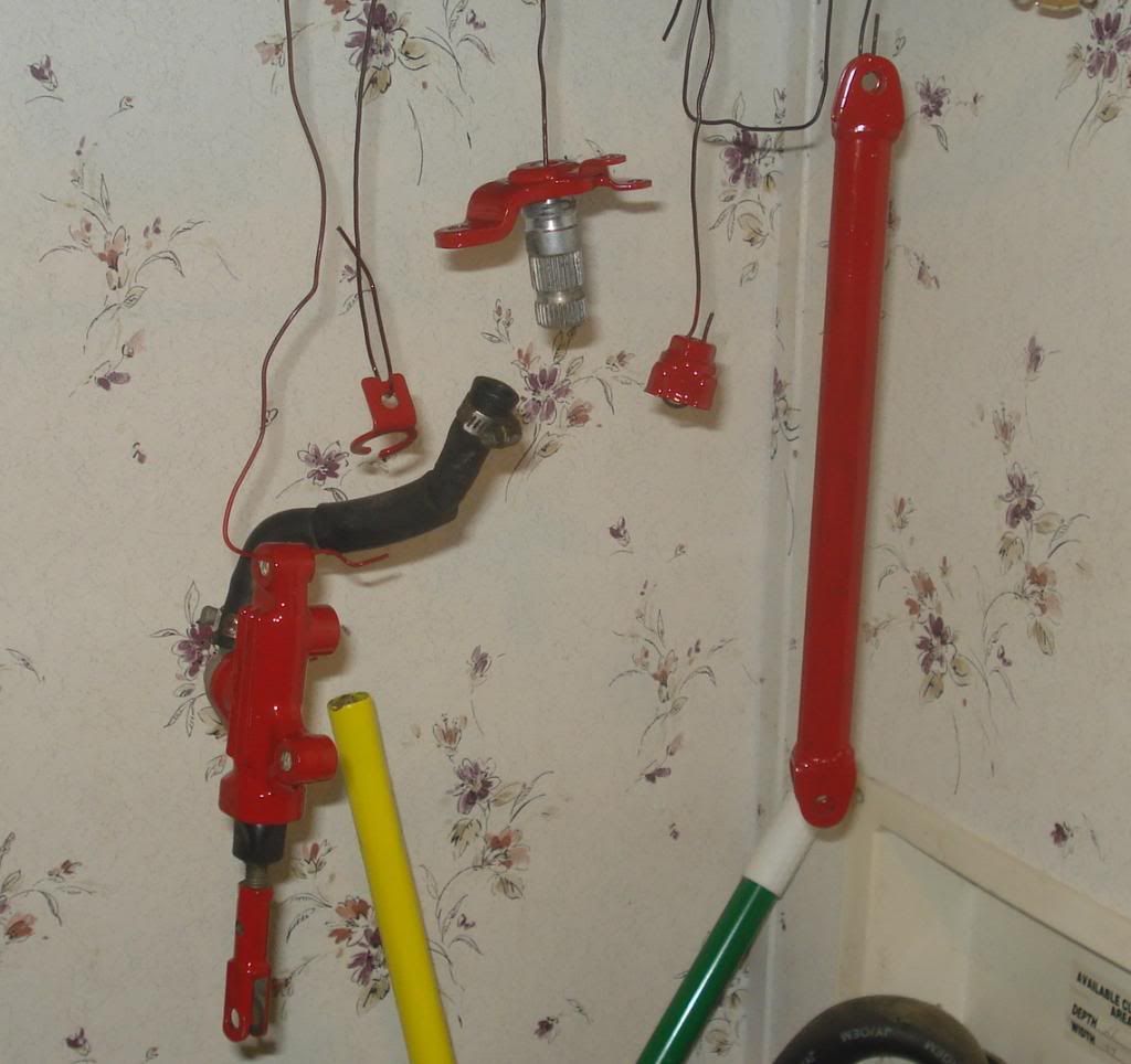

Went thru the foot pegs and the speedo today. The pegs are kinda rusty inside. I cleaned them good with paint thinner. Sanded the chrome and the painted parts then cleaned them again with alcohol. I have some Permatex rust treatment. It's a etching primer/ rust killer. I sprayed the rust and then painted the red. Later they'll get the metalcast on the chrome. The rear pegs are done to but there's nothing to paint.
Took the speedo apart and cleaned it good but the worm gear is held into the housing with, what looks like a roll pin pressed in to a blind hole.  I wont bother with it now, it seem ok. I cleaned the cable with paint thinner and made something to wipe out the cable jacket.
I painted the motor mount standoffs and the motor / exhaust mount.
I went out in the shop and gathered up the rest of the parts.  Not much stuff left. I'll be doing the oil cooler next. That's the last big thing that needs to be done.
