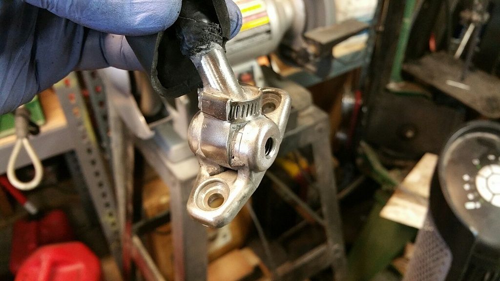

I'm telling you, I got both of the mirrors prepped to go on and discovered that the "repair" I made at last year's rally was a little more "permanent" than I thought. I started trying to get the broken mirror stalk out of the mount, then decided that if the JB weld was going to be that much of a pain to remove, I might was well leave it be.

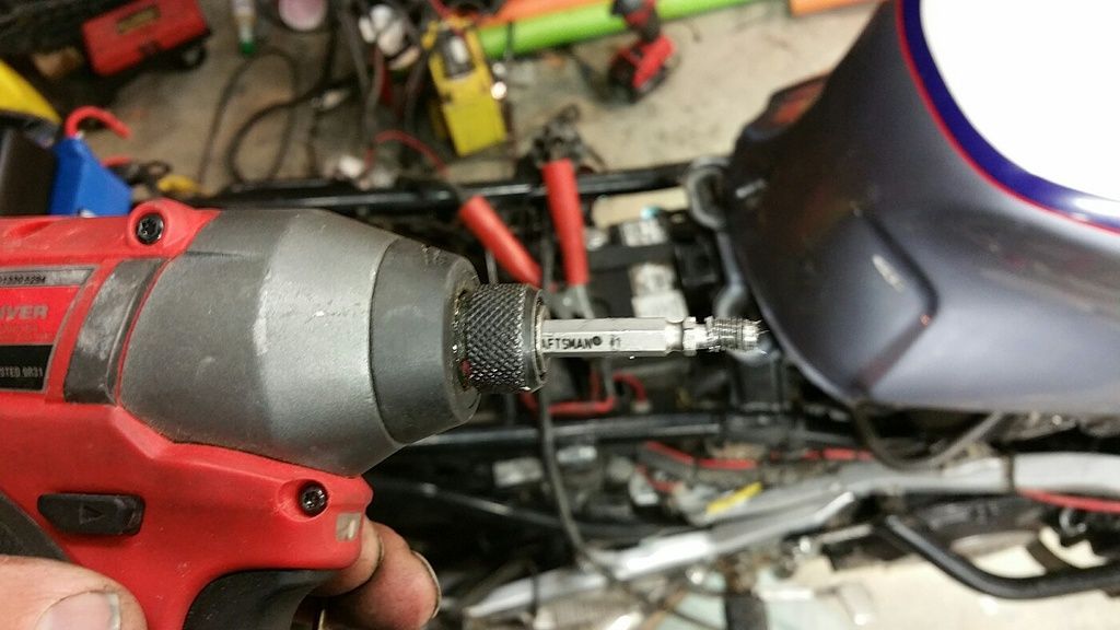

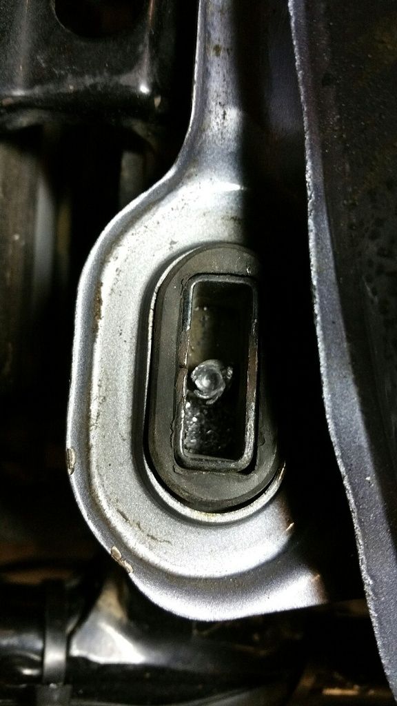

Of course then there are the gotcha's like finding that you have a sheared fuel tank mounting bolt.
I am soooo glad I picked up a couple different types of bolt extractors along the years when they were on sail. Generally they sit in the tool box, rarely used. But when you need them, they are a lifesaver.

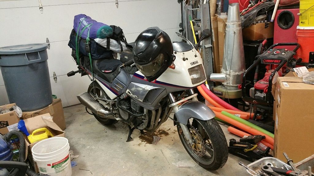

Here is what she looked like packed to go camping. :-) (That and I am playing around with my modified duffle bag for luggage.)

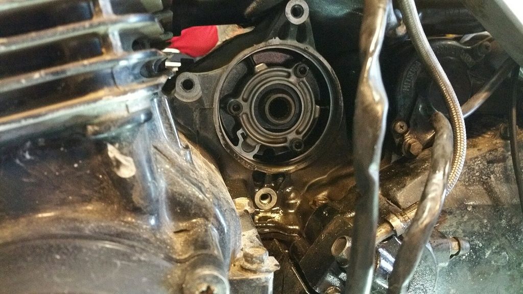

So, I have 200 miles on the engine now and I'm going to do the first oil change. I think I FINALLY licked my oil leak issue. Tightening the filter case helped, but didn't cure it. I was looking really closely, and it turns out, my alternator was leaking. The seal inside the dang thing had given up and oil was puking out of the alternator case. I swapped alternators and this seems to have solved the problem.
