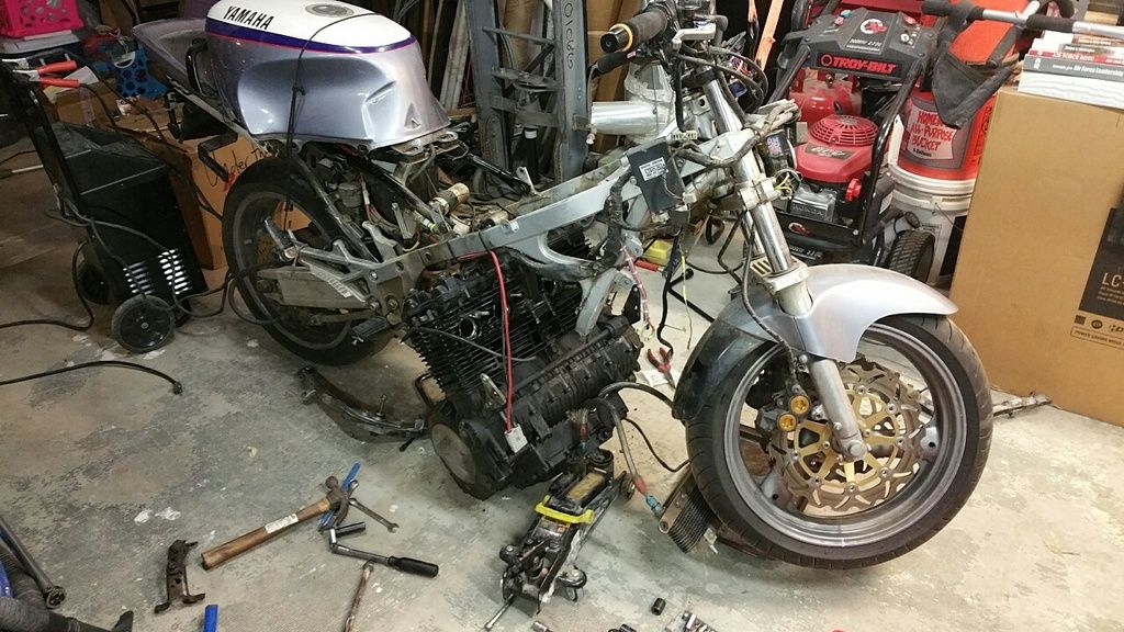

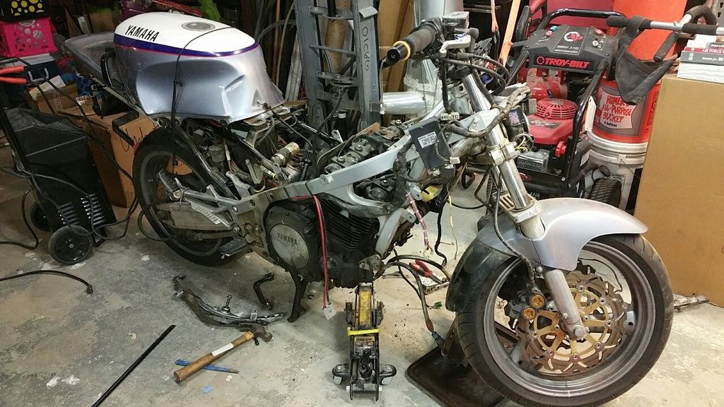

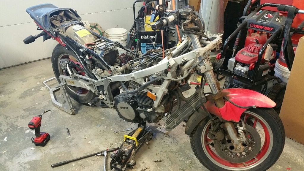

Well, I'm at it again. One week before the rally and I finally decided to get the beast back up and running. He's been sitting in the cycle shell in quite the dilapidated state.
Of course step one is getting the doner engine dropped.
skymasteres

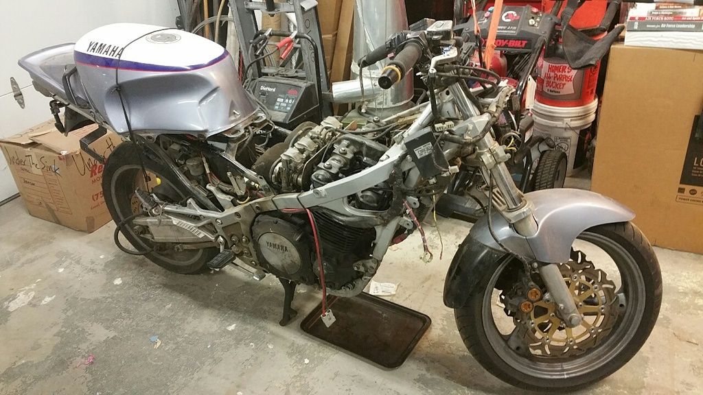

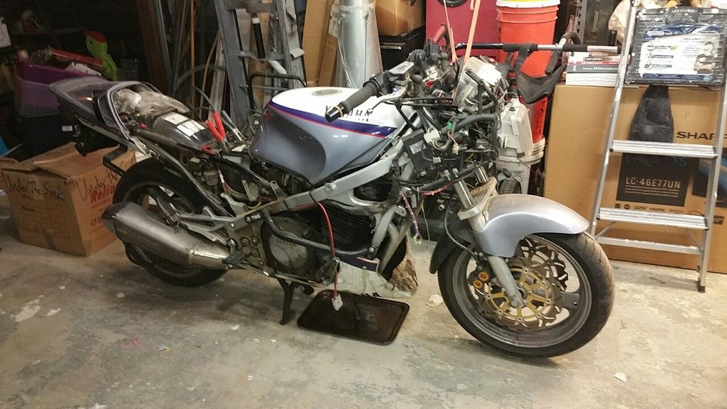

Well then, it's really prep time. And that means it's time to roll the Beast out of its shell and get started on fixin him. (Poor bugger has been laid up since the accident.)
I don't know why, the engine got me home, and around for a few short runs, but when I cranked him up to move, he started pissing oil everywhere. I knew that the engine was on borrowed time since I put it together after the 1346 threw a rod through the case. Ended up having to reuse the 120k+ mile pistons and cylinder block that was totally shot. Though I did end up putting about 10k miles on it. (Ring gaps were huge when I put it together, and the valve stem seals I used leaked from day one) Between that and the fact that the output and shift seals, and the base gasket was leaking, it was time to put a new mill in.

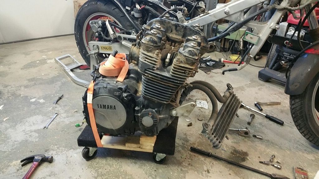

Getting these things out is always a chore.

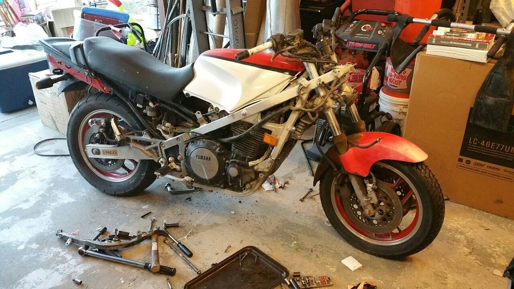

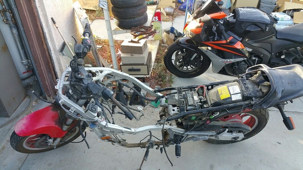

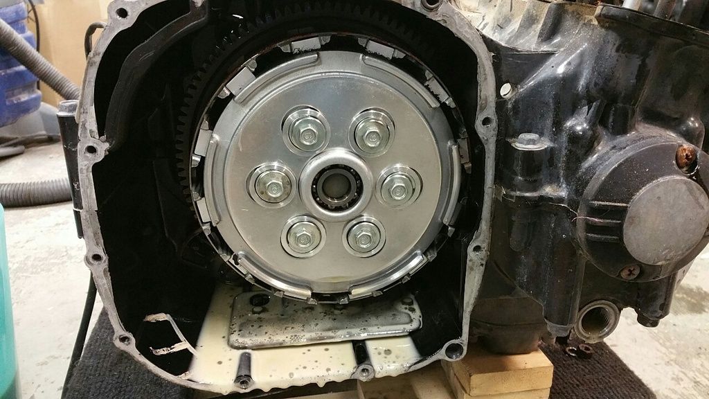

I got an 86 FJ1200 as a parts bike with a known blown engine, so I started with taking the engine out of it last week.  Figured I'd run a compression test , but it turns out I was getting a zero on all but one cylinder because the head wasn't fully bolted down. (It was actually curious to find all the evidence on how far the last guy went down the rabbit hole trying to fix it.)
It's funny that I had to bolt one of the frame rails back on for the side stand because this one doesn't have a center stand.

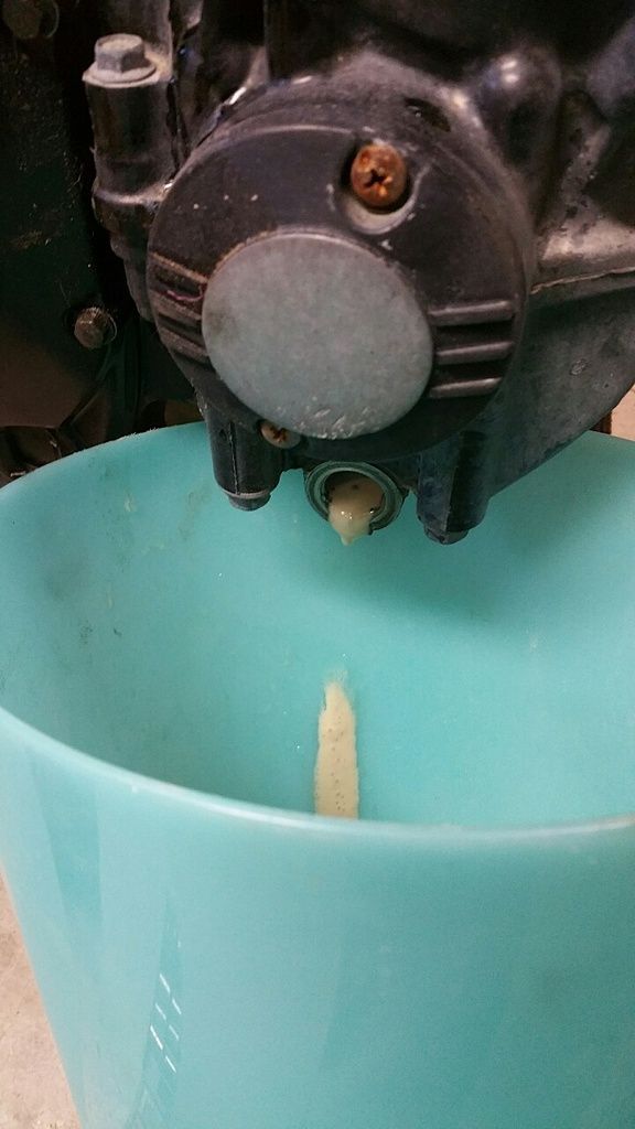

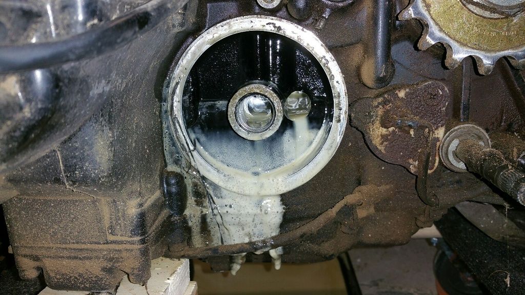

Okay, this doesn't bode well. Looks like I got a little bit of water in the case. And I pumped it all through the engine when I added oil and cranked it for a compression test.
These little dollies from Harbor Freight are great for throwing an engine on and wheeling it around the shop.

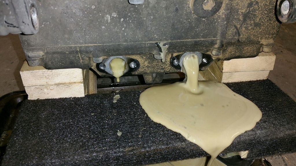

Yup, that's a god awful slurry.
It's EVERYWHERE!

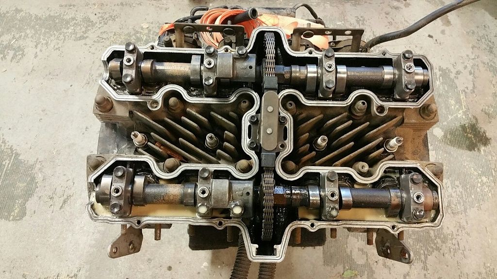

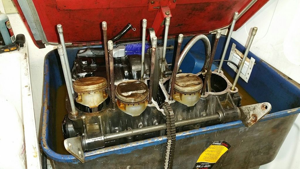

It's all the way up on the cams too.
Although on a side note. Sometimes there are good surprises.
Time to throw the sucker in the parts washer and flush it out.

Hey Mike...What the hell was in that crank case? I've never seen oil foam up like that.
You have your work cut out for you....
Looking forward to seeing you at the rally. Is Lilly coming?
FJscott
Looks like yoohoo doesn't make good lubricating oil
I snuck over to his place and topped up the crankcase with Guinness.   :biggrin: :drinks:
That is the new food grade lube....  :sarcastic:
Seriously..... The last time I saw oil like that was when I worked in a meat processing plant and a gearbox was drained. A lot of water and oil mixed together gets creamy.    :shok:
Yeah...I've seen it get frothy like that with a blown head gasket in an SBC.  My question is...where did the water come from?  Rain?   :unknown:
