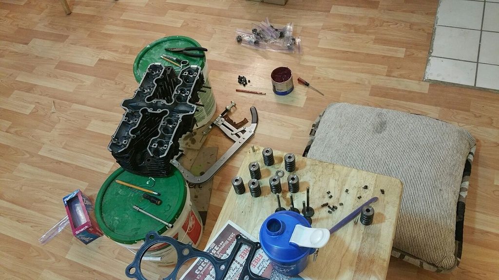

Now, after all this time, it's time for the "Holy Mill" to be opened up. (Or more accurately, I need a good cylinder head, and it's the best one I have available) Pulling it off was easy, but holy crap was there a LOT of carbon build up on the combustion chambers.
https://youtu.be/rJnZJx-01xw
Wasn't really worried about that because at the moment I needed to replace the valve stem seals.

What's with the extra valve shim that appears to be laying in the slurry, next to the #3 exhaust valves?
Draw a line from that extra shim to the #4 spark plug and you'll see the rusted screwdriver bit hiding in the fins.  Reminds me of the old Highlights magazine at the Dentist office where you'd find the hidden objects in the picture.
'93 Yamaha TDM 850 (x2)
Quote from: Firehawk068 on May 20, 2015, 12:54:55 PM
I don't think that it's extra...I see the edge of the bucket, so it looks like it just fell out.
The rusty screwdriver tip is a good spot....I've lost a few things in those fins before.

OK, I see it now. It popped out of the bucket that it is next to.
Whenever I have a look down in the top of my cylinder head, I find all kinds of winged creatures baked to a crisp. Usually the stinging kind.  :pardon:

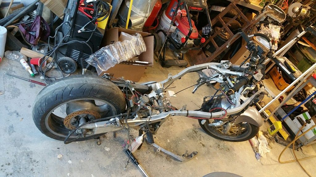

I definitely have my work but out for me. (Especially since I have the weekend tied but and I only have tonight and tomorrow night to work on it)

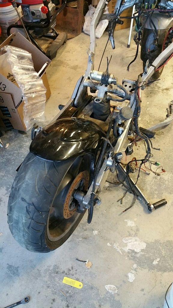

As for the tail section, the bike almost looks better without one. (Well from a frame stand point.)
Though, since I have the tail section off, I couldn't resist putting the hugger I just acquired in place to see how it looks. (I think it looks pretty good) The real test is going to see how it does with the full range of motion from the swingarm.
3

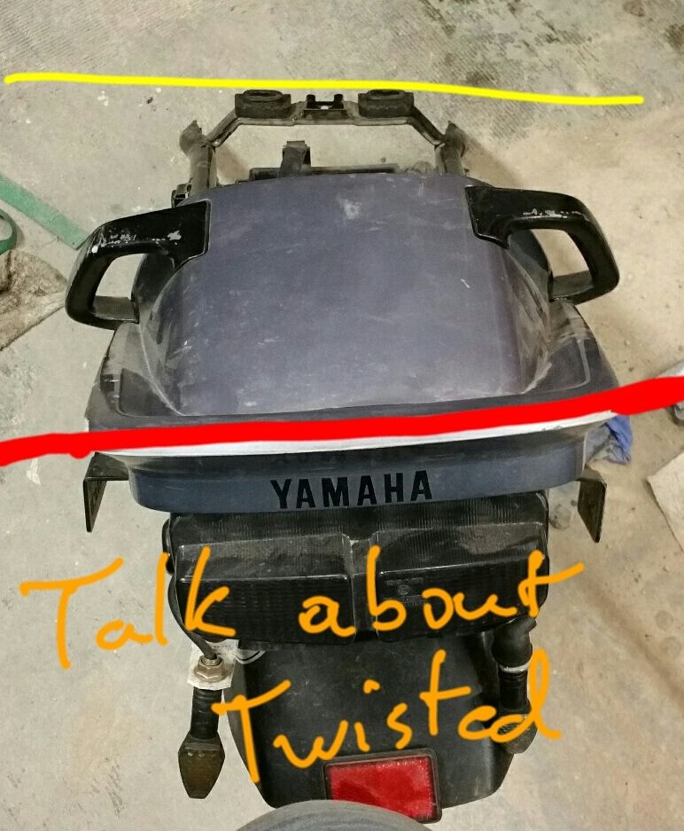

The tail section is twisted pretty badly. I know I have a picture from the rear of the bike somewhere, but it was REALLY making it look like I had SERIOUS alignment issues.

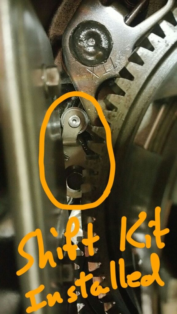

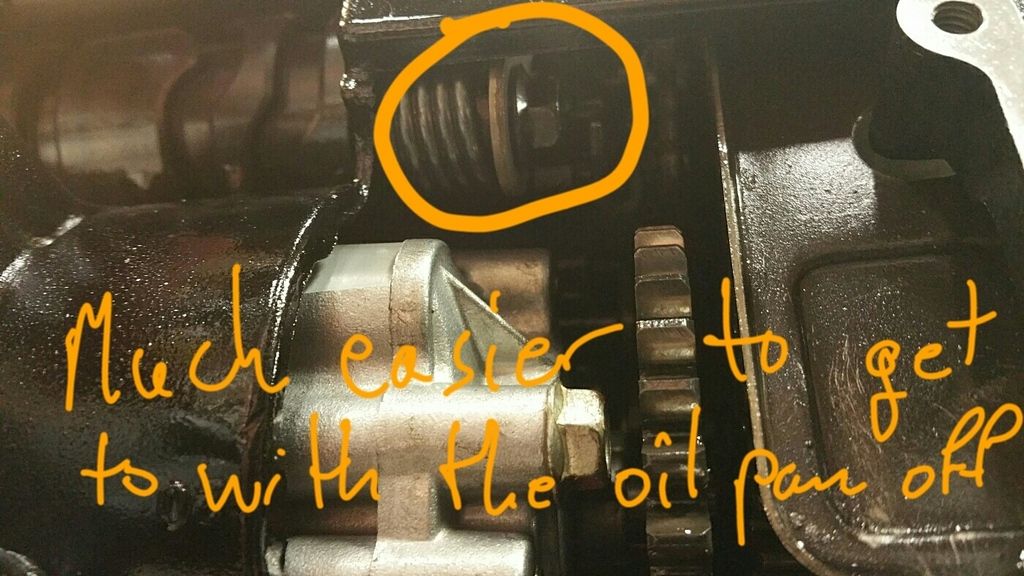

Switching gears, I did get the shift detent arm installed. Without having to remove the clutch basket. Though this is only really possible with the oil pan off.
So I guess in that sense it's really cheating.

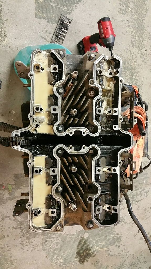

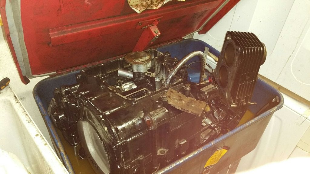

Rub a dub dub dub, one FJ engine in the tub... This thing is thoroughly cleaned up. Now I just have to rinse it out and get the rest of the stuff back on it.
Yeah, there's always something lodged into the fins. (Though that screwdriver bit became quite handy in getting some of the stuck fasteners loose)
And the valves look fine. That piston was well down in the bore. (Skirt just below the level of the sleeve)

Mark is right Mike... You can untwist the tail section after you bolt the front 2 bolts back on.  A nice 6 pipe or 2X4 will tweak it easy. They are flimsy.
