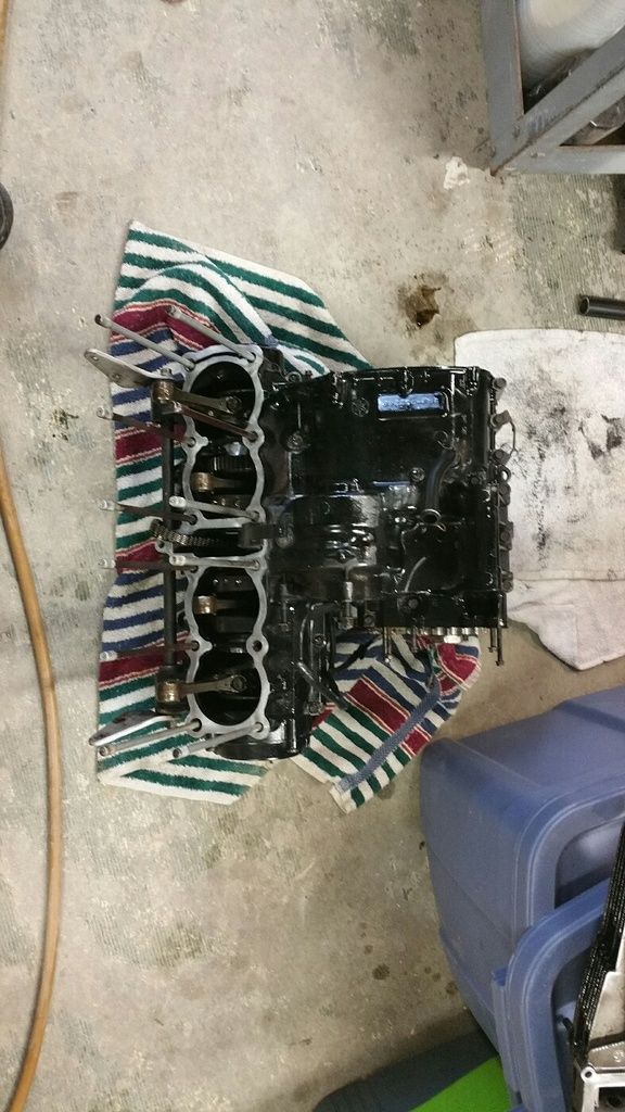

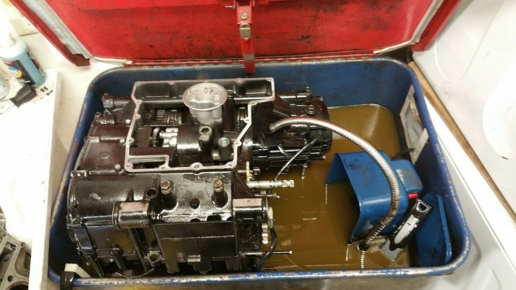

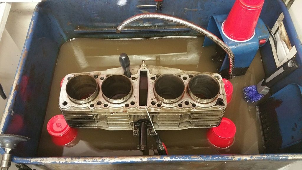

Gotta say, this thing must have been terribly dirty. The diesel was saturated. (I even changed it out once)  And it was crazy how much silicone was caught under the oil pickup screen. Definitely mad a good argument for absolutely minimizing the amount of silicone sealant you use in a build.
Finished honing the cylinders. (Took a page out of Capn Ron's book and used a bungee to support the drill. Made for MUCH more consistent honing)
Red solo cups and their almost infinite uses.
The engine is all purdy, relatively speaking, and rinsed out.

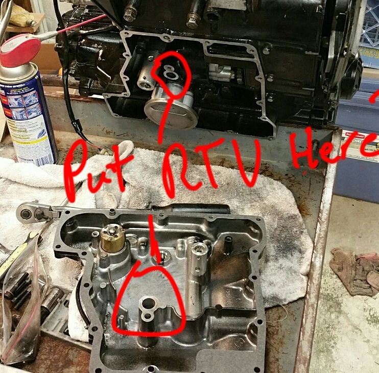

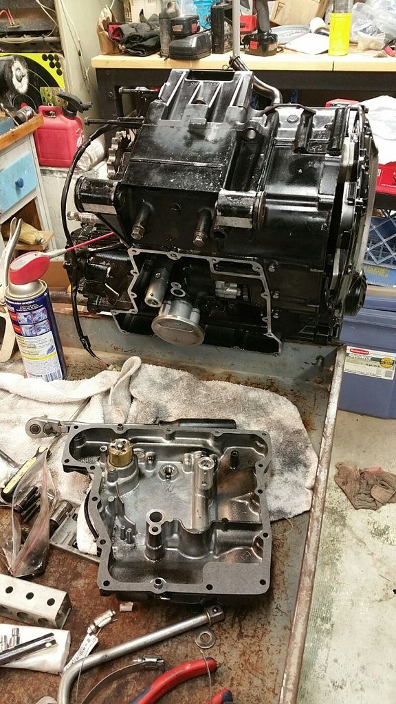

The oil pan getting a new gasket. I had to remind myself to get the aluminum restrictors back in.

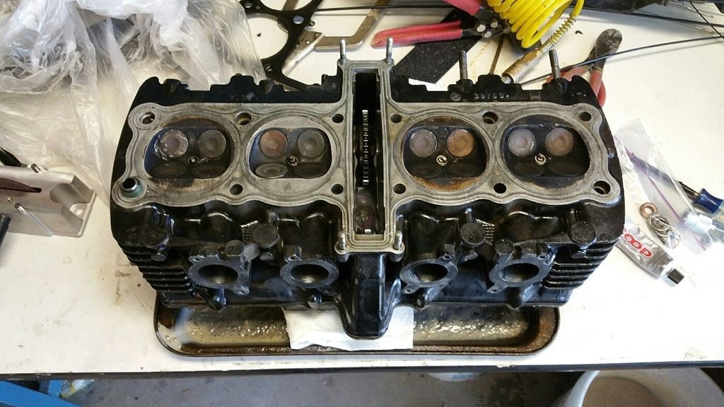

Cylinder heads were a bit of a problem. Warning to others. DO NOT PUT OVEN CLEANER ON ALUMINUM HEADS.... This is what I started with. The oven cleaner doesn't do very nice things...
I don't have any pics, but the heads were pitted visibly. I polished it out so we'll see how that turns out. I also got the last valve guide seal installed and measured all of the valve clearances.  There's a lot of "we'll see" here. Randy was good enough to email me back and forth last night informing me that my piston had struck the head on the blown motor.  After thinking about that for a bit, I realize that he's right. There's no way you can lose a connecting rod and not have that happen. Though I have my fingers crossed that it hasn't "Displaced the valve seats and closed off the combustion chamber. Everything seemed to be sealing and actuating just fine, so I'll find out when I crank him up tonight.

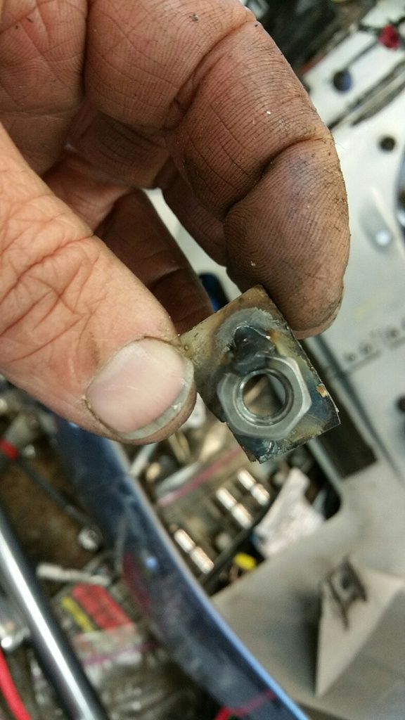

When you're stressed for time, and can't find your parts, sometimes you resort to making what you need.  Like the stupid J nut that holds the headlight bracket to the fairing.
Was out of M8 nuts, so I took a random standard nut, ran a M8 tap through it and welded it to a price if sheet metal that I cut, drilled, and bent for that purpose.  (Fortunately it only took 5 minutes.  But still, felt like an idiot two hours later when I found my stash of all my fasteners for the bike)

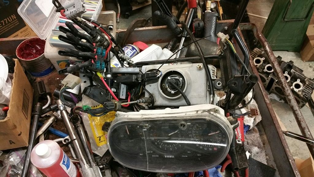

The power panel from the fairing needed to be glued. I had circuit breakers in it originally, but they interfered with the fork. Ended up cracking the back of the panel and making the electrical connection to the fuse iffy. A little heavy CA glue and that fixed that.  (Well that and clamping it to make sure that it was held tightly together.)

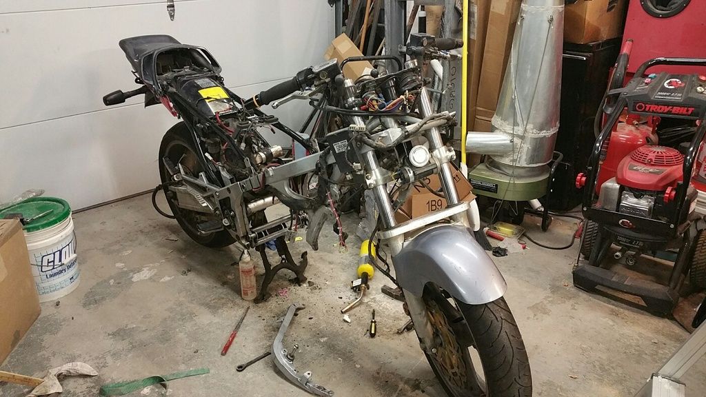

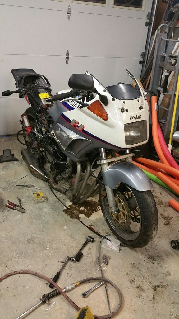

Taking a moment to pause and look at the fairing, with the frame installed, and the bike with an engine in the frame again.

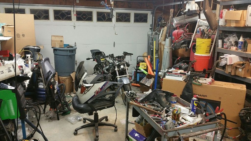

Though my garage is a freaking disaster right now.
Oh, another almost insidious difference. The top tabs on the tail section are different and make reinstalling a carburetor a real PITA. (I finally did replace my ratty carburetor heat shield. It actually worked out. Two of the rubber retainers broke, and I happened to have two on hand to replace them)

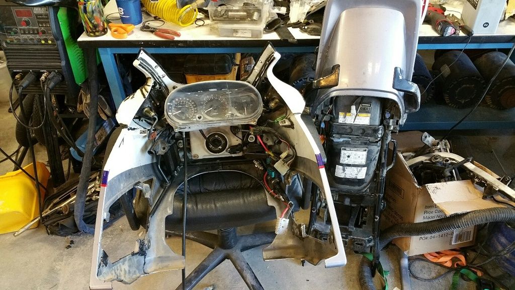

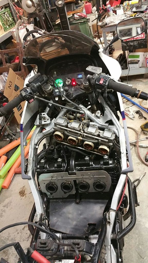

And then there was the issue of the electrical gremlin. I get the fairing one, install the battery, and hook everything up. When I turn the key on, the instrument cluster goes totally nuts, the headlight won't come on and only flickers, the oil temperature sender is going crazy, and the neutral light only illuminates when the run switch is in the off position. Additionally the turn signals were acting funny, flashing normally for a second or two, then doing the broken bulb flash.  I probably spent a freaking hour checking all of my connections, checking grounds and trying to figure out what was going on. (I was pretty much crushed with the notion that this whole project was sunk if I couldn't get the electrical system going)
Finally I decided just to press on with the build and I would figure it out after I got the rest of the engine buttoned up.
I could not believe it. It turned out to be the big Craftsman charger that I had hooked up to the battery. After it was charged everything worked perfectly. (In spite of my onboard voltmeter telling me I had 13.5v the whole time I was trying to figure out what was going on with it on the charger.)  I will say that it was a HUGE relief that it wasn't something on the bike causing the problem.
One more push and it'll be go time.  (I need this to work...)

You mentioned a bunch of silicone sealant trapped in the oil pickup screen?
Where exactly do you use silicone sealant when you are putting one of these engines together?
Most everything that bolts to one of these engines either uses a gasket, or an o-ring.
RTV silicone sealant is unique, in that it is designed as a "Gasket Maker", NOT a "Gasket Sealant". It even says so right on the label.
I would caution you to NEVER use RTV silicone on a gasket or an o-ring.
O-rings, and rubber gaskets are mostly designed to be installed DRY.
Paper or Cork gaskets can be installed with gasket sealants, but there are specific ones intended to be used with such gasket materials.
RTV silicone can be used "In place of" a gasket, but if such a part calls for a gasket or on o-ring, it is preferable to use the gasket.
The one place where I could see using it, is where you put the case halves together?
But there are better suited sealants for that as well.  Permatex makes a really good Anaerobic Sealer for flanges and case halves.
Back when I lived in NY, and my brother and I rebuilt a lot of snowmobile engines, the best product I ever found for sealing engine case halves was a product from Three-Bond. (#1104)

Hey Mike, you probably caught it but in your pictures I didn't see a new gasket between the oil screen and engine.  Small but important gasket as it is also the gasket for the other oil transfer hole (best I can describe it).  Hat's off to you buddy !  :hi:

Alan, I pretty sure it came from the valve cover, clutch cover, and base gasket. The PO used RTV on those  spots and there was a lot squeezed out.
George, I did not catch that. Well, not entirely. I did not remove the oil pump pickup tube. I did though use a SMALL amount of RTV to put on the part where the pan mates to the oil passage.
I'm thinking that should be fine for getting the job done.

As long as it is sealed Mike.  I think it is on the high pressure side going pass the oil pressure relief and on up to the oil cooler.  But I am on thin ice on the subject.  I admire your ability there.  Took me 2 months and I didn't pull the engine out just to do the top end..  But I work slow and there was a learning curve involved...  :good2:  Ride safe Mike.
