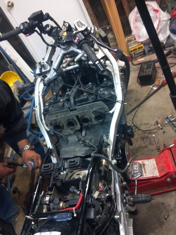

Soooo, let dial up users be warned. I'm going to be posting a whole slew of pictures...
Some general tear down photos
Engine out and working on the wiring harness.

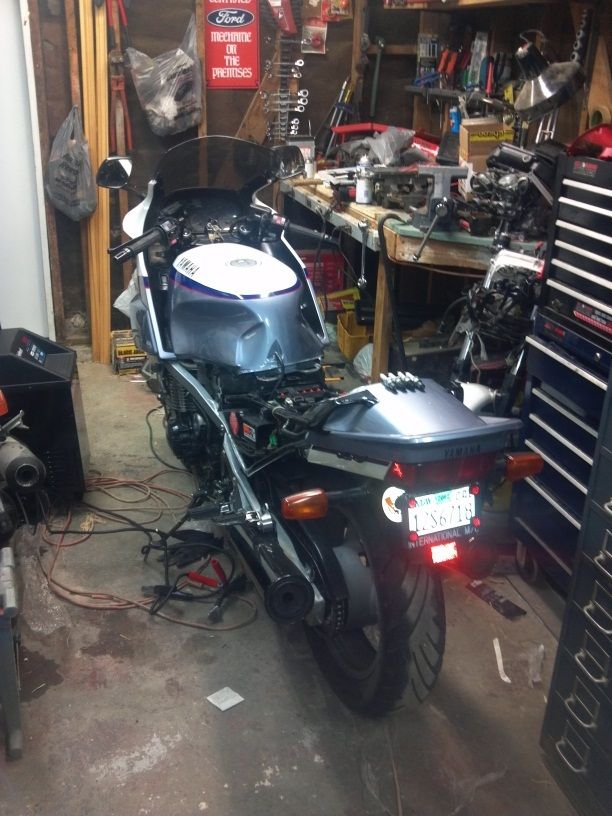

Here's the rear axel before I tore it down...
skymasteres
Of course that's before I chopped the ass off of it...
It's amazing how quickly these things break down into hardly anything.
