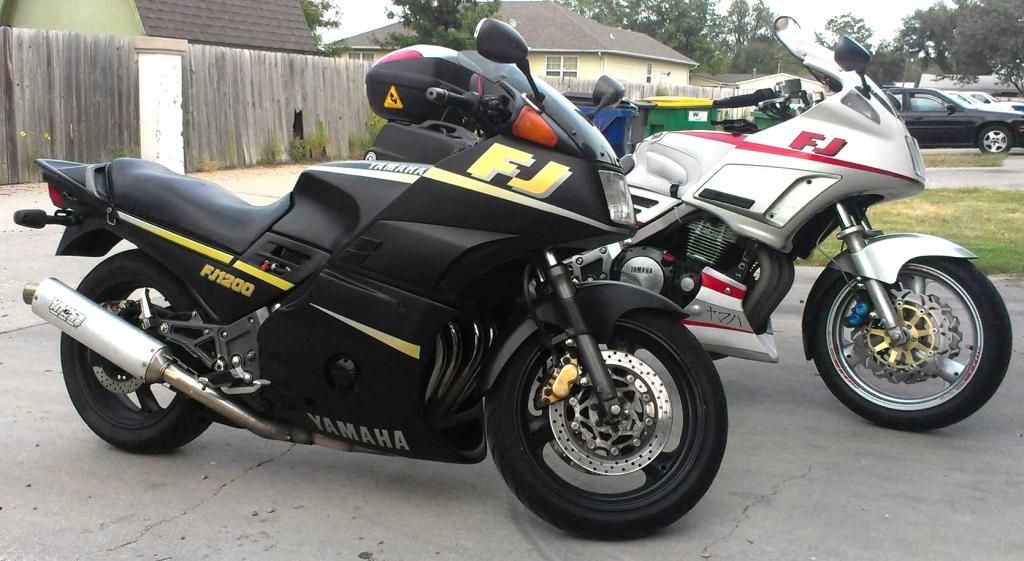

After I had the black/gold '87 and the appreciation of the bike from fellow members. Plus I really liked the paint job.
I am going to do a slight variation. One of the 1986 European paint schemes has really caught my eye, and I am going to reproduce it on the spare body work. I will go with the Satin Black and the Black/Red/Silver graphics.
Dare to be different Fred! Every &%$#en motorcycle manufacturer offers bikes in flat black. Most of them cruisers. They all look like they were left in primer black to me. Your second picture shows a beautiful shiny gloss black FJ. Just my opinion--showing my age--rant over.   :biggrin:  Dave

I like Fred's idea. I think a blacked out FJ (satin black, not flat black) with red accents would look bad ass sinister.
IMHO I would not use the white Yamaha lettering on the side of the fairing....just carry the red stripe thru.

The YAMAHA on the fairing is actually Silver.
Shot of the graphics and some of the body work waiting for the dark side conversion
White lettering, silver lettering, no difference. I think it distracts from the lines of the bike. Again, just MHO.
