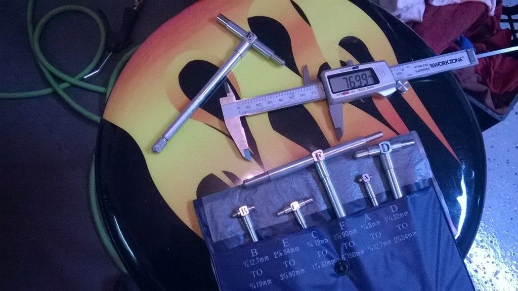

I did some measuring of the cylinder bores and they are all pretty true.
Tools used to measure with.

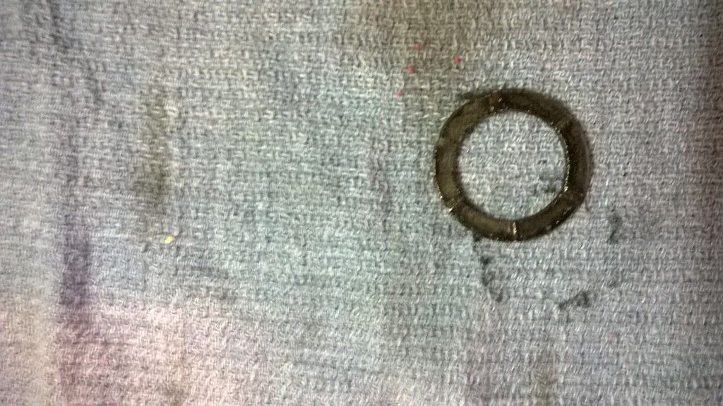

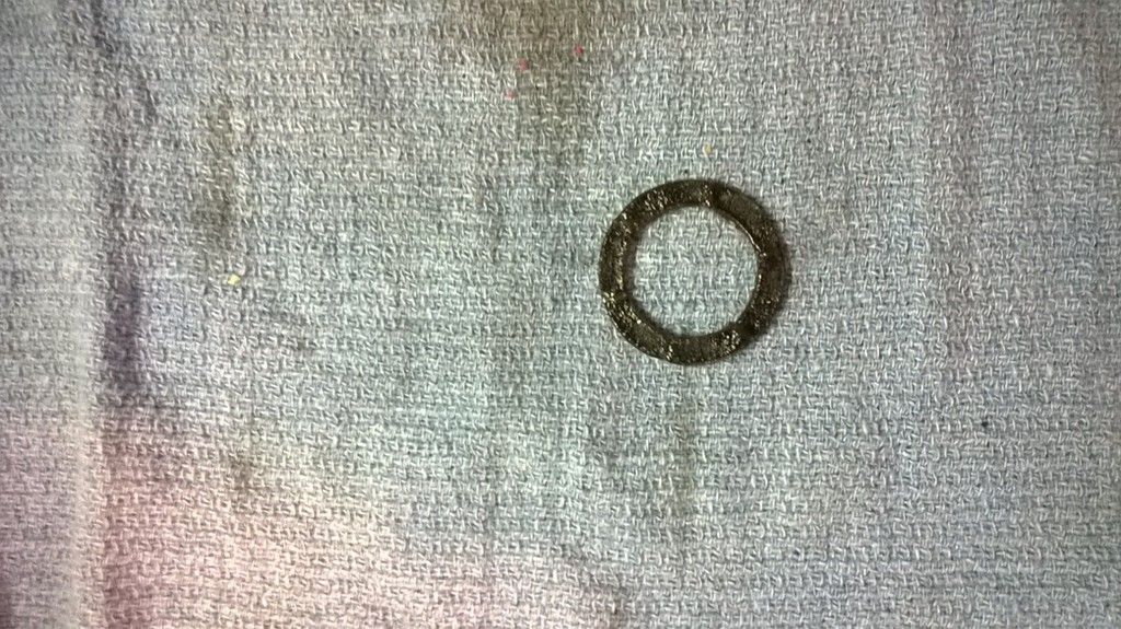

When I removed the Oil pump screen, this was wedged in it. There was another piece that was in there also. my guess is that it came from the forward cam chain tensioner slide. When the head was rebuilt 2 1/2 years ago the forward slide was replaced. I believe this is from the old slide.
I can't remember how long ago I installed this, but for $10.00 I figured it couldn't hurt and might help with keeping fine metal particles out of the engine. The magnetic washer that RPM sells for the oil filter does work. In the photos, both sides are covered with extremely fine fuzz. The last photo is cleaned. http://rpmracingca.com/proddetail.asp?prod=OFM&cat=39

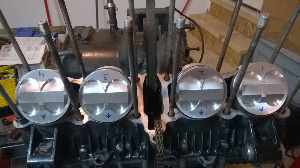

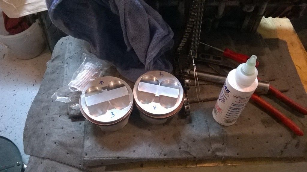

Getting the pistons installed
The wrist pins slide in fairly easy, getting the wire clips installed is a Pain In The Ass. :ireful:
All four pistons installed.

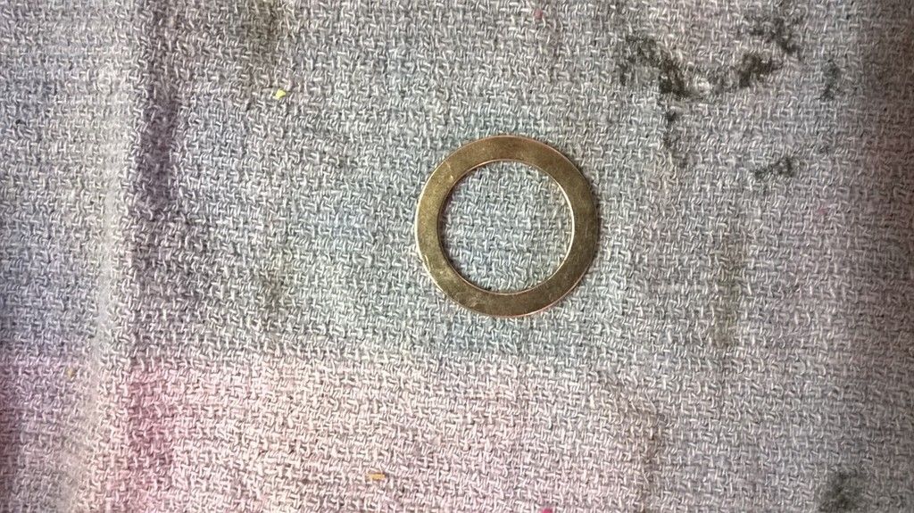

Here is a Public service announcement...... For ALL members here that are not original owners. During your next oil and filter chain. Remove the oil pan, and remove the oil pump screen. Clean the screen. I found a good bit of stuff hidden in the screen cavity.
