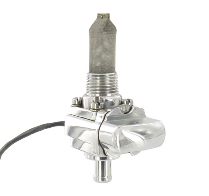

Quote from: FeralRdr on January 20, 2015, 11:18:13 AM
Not the cheapest solution and you would still have to use an adapter plate, but it may be possible: http://www.pingelonline.com/pc_product_detail.asp?key=7309EE24013946E4AA8A0135B6A16DCC
Wrong application:
Electric-Flo™
Tired of trying to find the perfect spot to hide the ignition switch on that custom bike? Well, that headache is gone with the Electro-Flo™ Fuel Valve because when you turn your gas one, you turn the bike on also, which is a feature like no other valve in the industry. Pingel Enterprise, Inc. and custom builder Darrian Tefft teamed up to develop the Electro-Flo™ Fuel Valve. The result is no more forgetting to trun the fuel valve on, starting the bike, and taking off only to have the bike kill because it has run out of fuel. The Electro-Flo™ Fuel Valve utilizes the Guzzlers inpressive 211 oz. per minute flow rate along with outstanding race tested durability. The Electro-Flo™ is manufactured from billet aluminum the polished to a show-quality finish.

Quote from: Pat Conlon on January 20, 2015, 11:59:33 AM
Wrong application:
Electric-Flo™
Woops!  :blush:
Yep! Definitely misread the description, and didn't look close enough to see the switch on it. Sorry if I got your hopes up.  :pardon:
