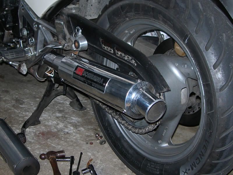

Made a little time and the Kerker's are on like tight, tough to get the left side off.
Test fit the Yoshi and it seems too short by only centimeters.
The Kerker is bolted to where the stock exhaust bracket would go, this Yosh want to bolt up at the passenger peg -
Let me see if I can get a few pictures.
I've got a couple of ideas, not giving up easily.
Steve

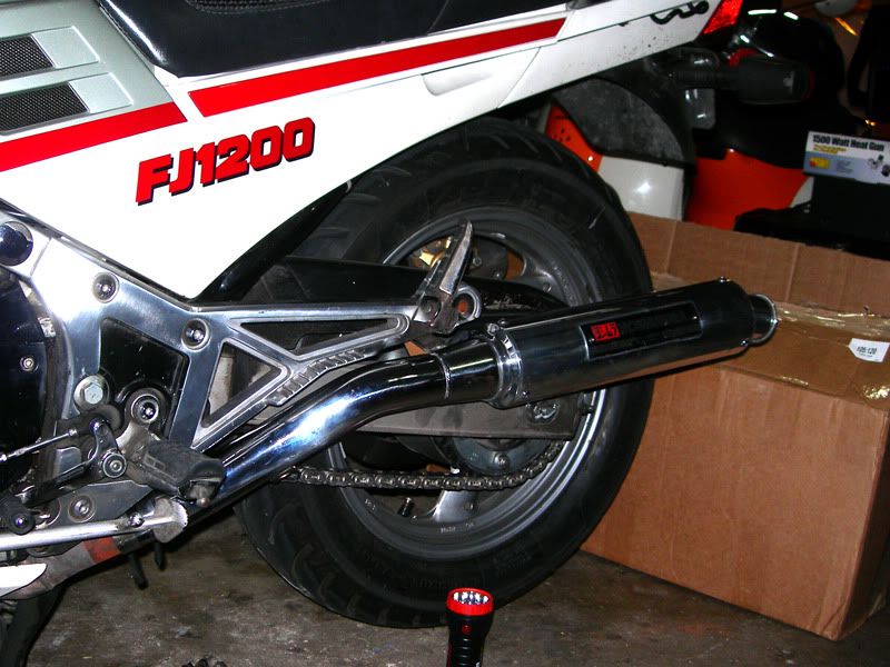

Fitted to the bike but not bolted on in any way -
Here the bracket welded on the cans appears to fit the passenger peg hole, not the rubber isolated mounting point the Kerkers bolt to.
And it only fits a very small amount on the collector when the mount is aligned as shown -
I'm open to your thoughts and ideas.
A couple come to mind, trying to adapt them being one, selling them being another  :wacko2:
Steve

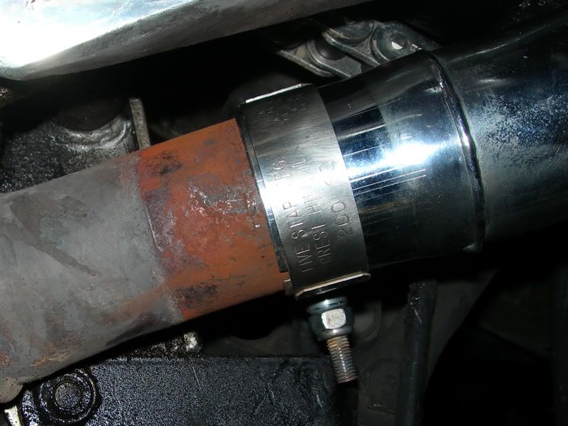

Installed all the way on the collector -

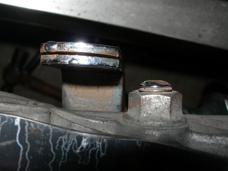

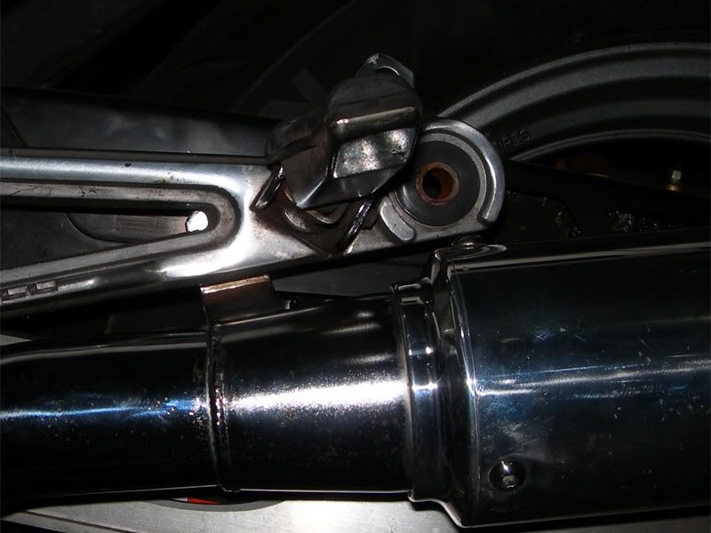

Here is where where the bracket is -
And that is the footpeg bolt, the rubber isolated mount is further back......

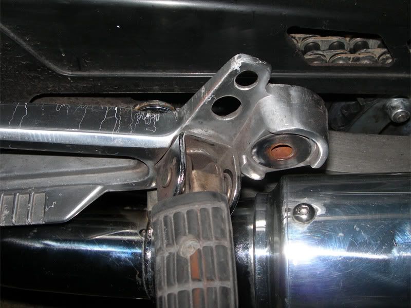

Couple more of the bracket fitment -
:negative:
