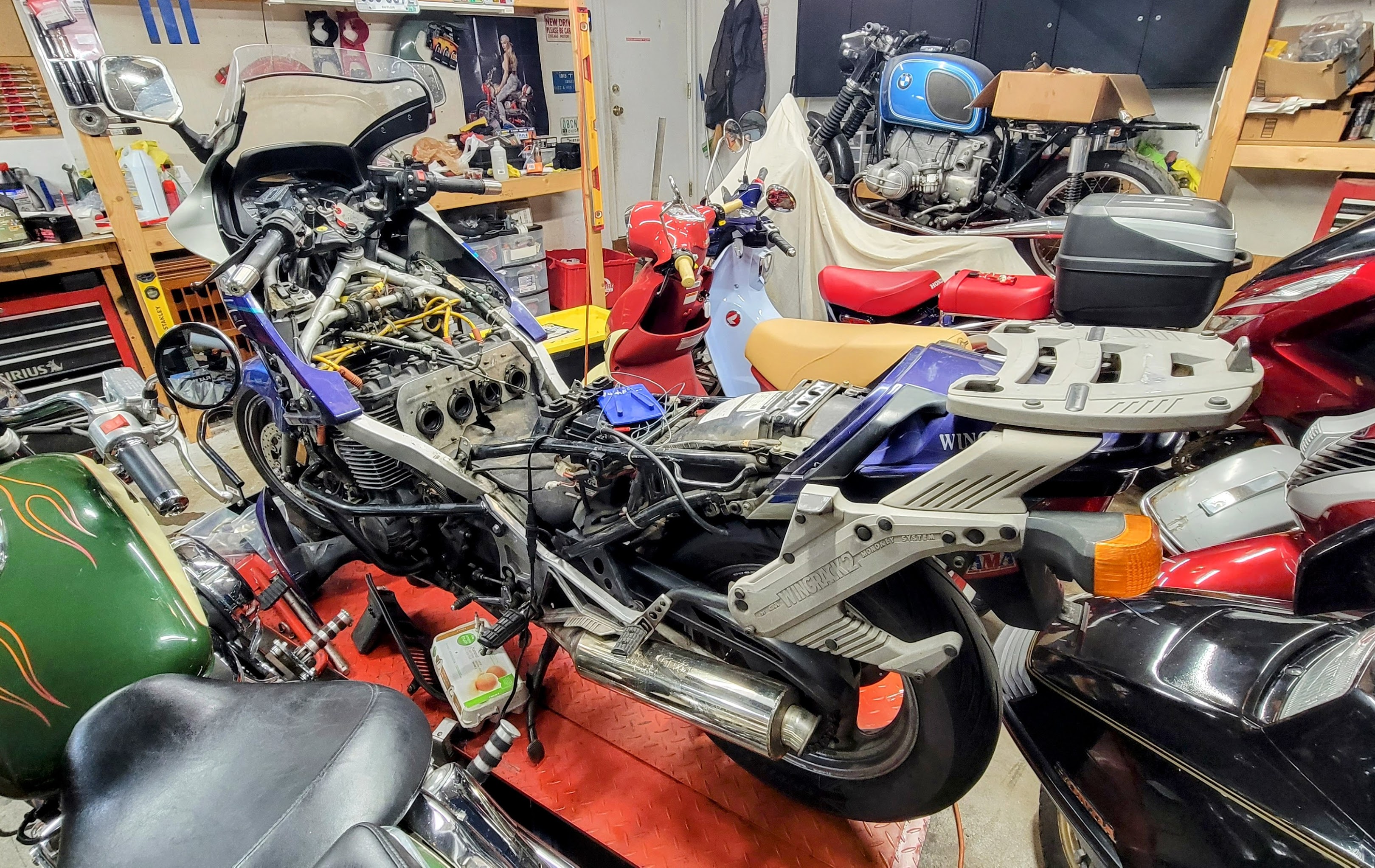

I'll update this post as I troubleshoot and work on this old girl. I don't want to sink a ton of money into her as she is one of about 12 other bikes I own but I think or hope that will some love a bit of tinkering she has many more miles left in her.

I've been able to get the bike to start with a fresh battery but she does not want to well under load. Exhaust temps seem to be all over the place. I also suspect that the voltage regulator is either bad or going bad. I've ordered a voltage regulator kit which is on it's way. I've also decided to rebuild the carbs or at least pull them, clean the jets and replace all the rubber o-rings etc. Parts other just placed with RPM.
Throttle cable also was a bit frayed so ordered a new OEM cable to. And as luck would have it the petcock is dripping some too - so bought one of those now too. Anyway she is torn down on the lift table waiting on parts. My first world problem is I am now up to 13 motorcycles/scooters and my once big enough 3 car garage just isn't big enough anymore. Believe it or not our 1915 Model T is tucked over there in the corner too. :)
