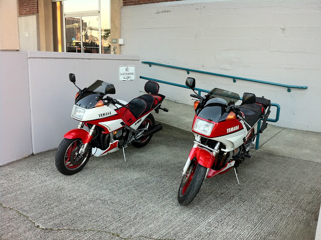

Want to ensure you have another FJ to park next to at work?  Easy.. sell a co-worker your "extra" one.  :)
hpras
hpras
