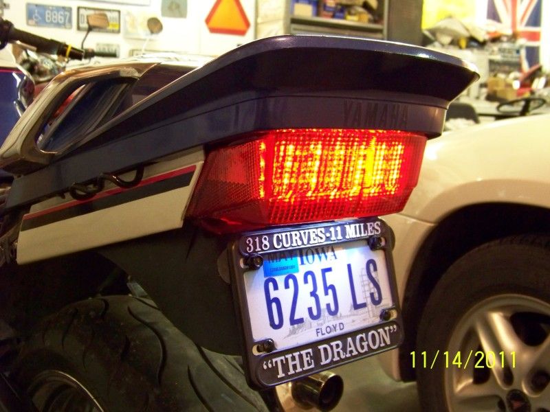

Although I really liked the integrated turn signal, LED tail light, I never cared for the way it fit, nor the shape of the lens, so I broke it all apart and put the electronics inside a stock tail light housing that has had the raised letters sanded off and completely polished.
It now has a more stock appearance, but with the lack of the turn signal stalks.

I used a LED stoplight assembly used on commercial trailers and fit in in my existing FJ lens (and I trimmed the bottom)
More info here: http://www.fjowners.com/index.php?topic=1629.0
Leon that is great. I'm going to have to do that with mine. Same here. The light works great. Plenty bright. But the lens isn't what I want either. And I have 2 stock ones laying around.
