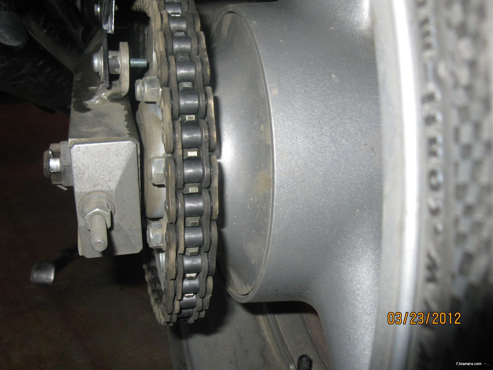

I measured the stock FJ wheel as it sat in the swing arm (to my knowledge, I had a stock set up) and this is what I got:
The stock wheel set up has the FJ wheel off center of the swing arm by 3/64ths of an inch to the right of center.  I was measuring this with a combination square, squared off to the outside of the swing arm, measuring to the wheel closer at the front side (motor side) of the wheel. Also, the stock FJ distance from the outside of the swing arm to the teeth on the sprocket was an even 2.100 " ,(measured with a vernier caliper).
On the GSXR, I used (off the shelf washers)  .258" spacers on the brake side and .075 spacer on the sprocket side. This put my GSXR wheel a weak 1/32nd  to the right of dead center, and a distance of  2.055" to the sprocket. Incidentally, I used an JT 38tooth sprocket, and flipped it to get the teeth further from the sprocket..
Now, I could get custom spacers to tweak the wheel off center to the right another .0312" or so to more to mimic the original FJ measurement and consequently move my sprocket closer to the original measurement.  I don't know if this is spitting hairs .  Also, I was perplexed by the original wheel being off of center of the swingarm.  Granted it may be this way by design to have the wheel centered to the bike frame.

Here you go Kevin, I think you've found the problem.  The cush drive hub sits IN from flush about .5 mm  to  1 mm or so. (guestimate by feel).  Sounds like the rubber dampers may not be seated all the way in.  ?

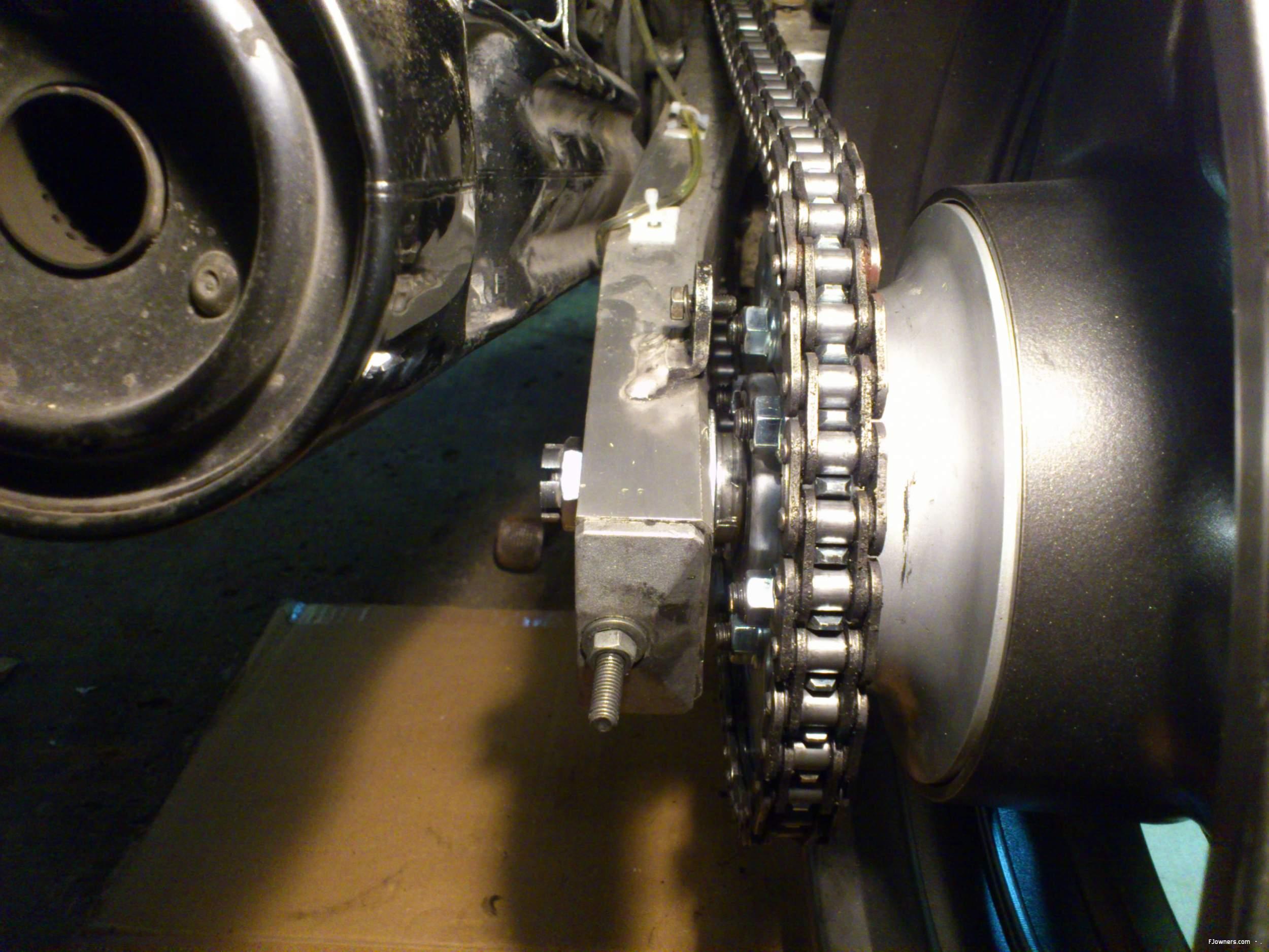

Yeah, the GSXR spacer is not in the wheel like this:
And this is the gap between the hub and wheel on my bike. I hope it comes out as the light and black wheels makes it hard for a good pic.

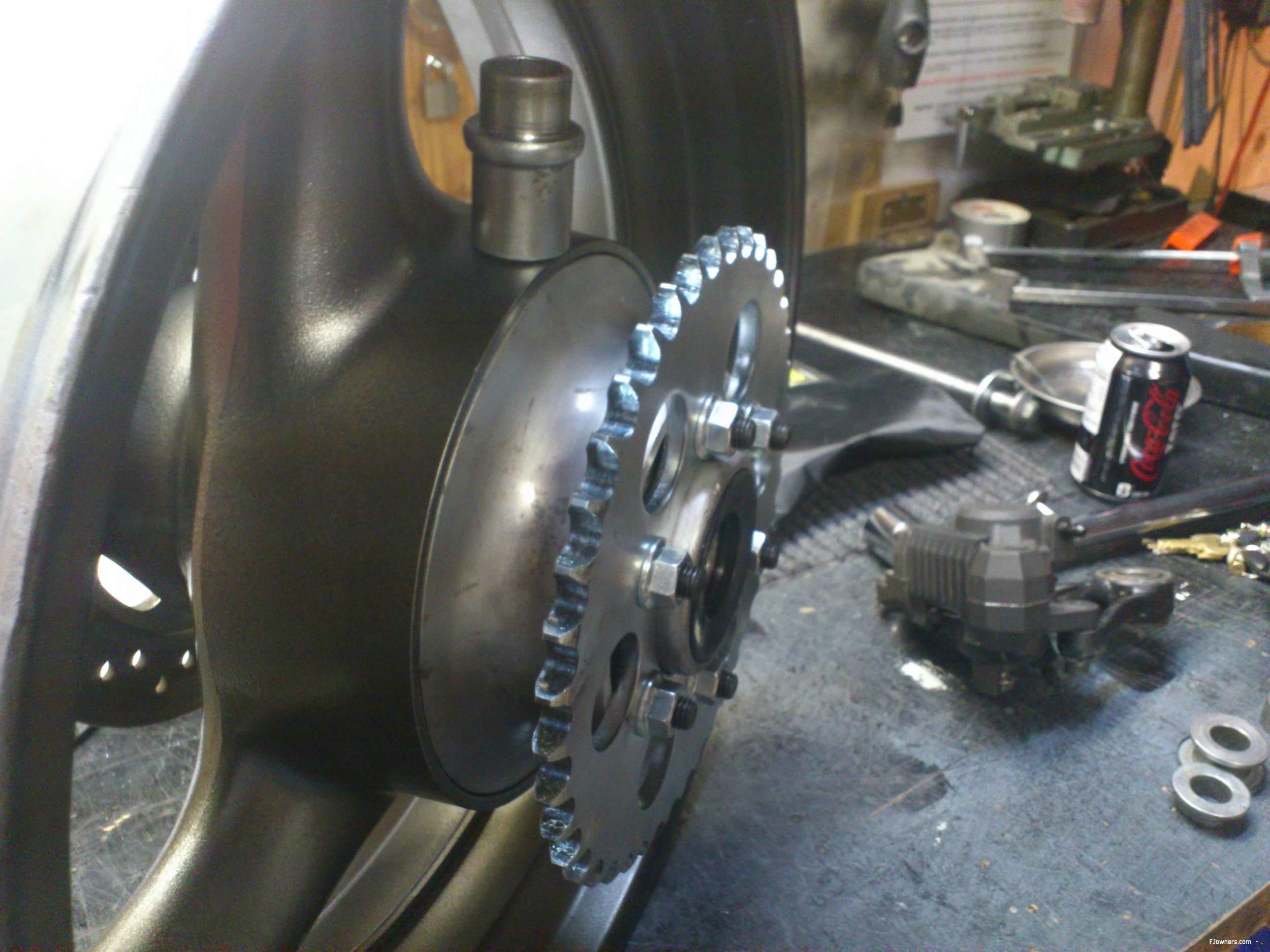

Curiousity got the better of me, so and I went out and took everything apart. I took the FJ wheel, spacers and caliper carrier and assembled it on my bench in the order it would be on the bike. Then I scribed a mark on the axle where it came through the spacer on the chain side. Then I did the same setup with the gsxr wheel and spacers,with out the added washers and the measurement was the same.
Craigo,

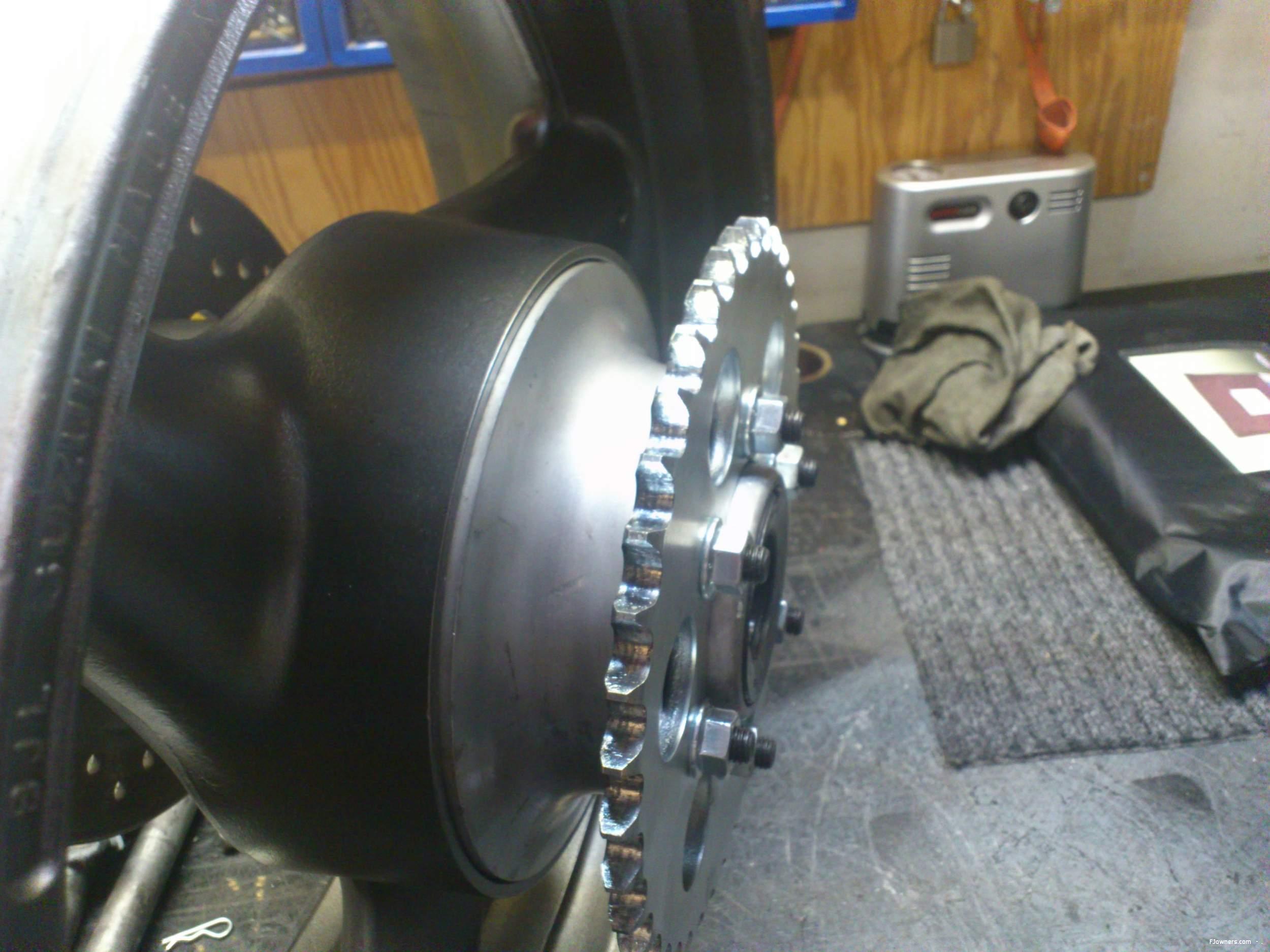

I'm assuming that the washers are required for chain alignment? If so, first I'll correct the way the cushdrive protrudes out of the wheel (see the pictures below). Then I'll remount the FJ wheel on the bike, and take some accurate measurements for the sprocket to swingarm distance, and wheel center.  My thinking is that the spacer I have probably came from a different model, and is thicker than the one you guys have.  I may get lucky and not need the washers. I'll keep you posted.
Thanks for the help!
Kevin
I took these pictures of the cushdrive with and without the inner spacer. Either the spacer is wrong, or possibly the bearing was never seated properly in the hub.
That sounds right to me.

I have to say it appears the inner spacer between the hub and wheel might be your problem. The sprocket hub just does not fit like it should. If memory serves, that is the right spacer, so it could be the bearings are not seated correctly. But I'm feeling that the problem is in there.

I have to agree on the size of the inner spacer. However, it looks to be only about 4mm or so off, which still won't get me enough axle thread for the cotter key. I'm still thinking that my chain side spacer may be a little thicker as well. Once I correct the inner spacer size, I'll get a better idea on the spacer thickness, and what I'll have to do to shim it up.
