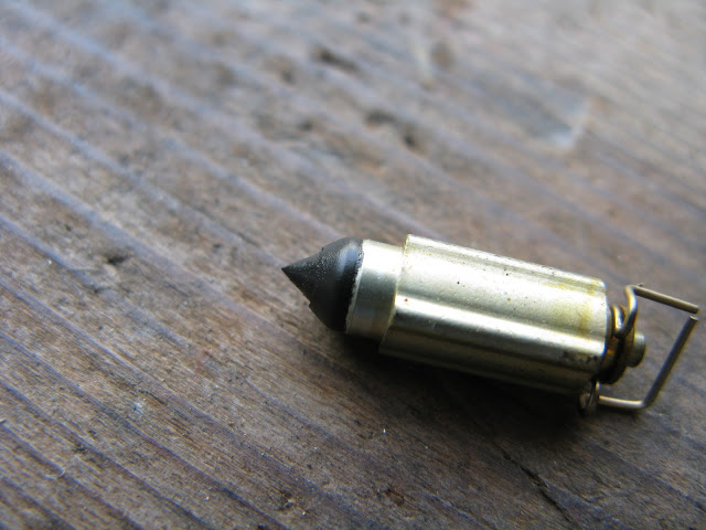

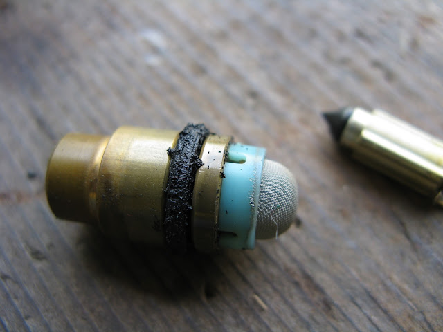

but i have to do something because this is what they look like right now, and one float needle was jammed in there as well.

Looks pretty icky!
If you end up replacing the needle seats (they can get bent if you're heavyhanded with them, and a float needle sticking in one is due to that sometimes), make sure you get the proper ones.  There was more than one size used on the FJ through the years, depending on if it was a fuelpump equipped model or not.

        I have all of the carb parts you need including those replacement needle & seats. I will have to say I have never seen a needle with that much wear from a bike (note the step in the rubber).
