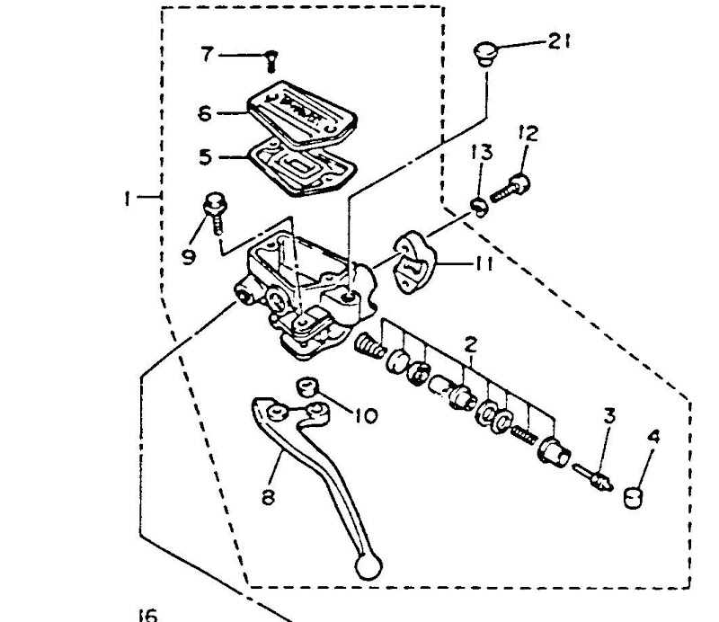

hpras
Check part #4.  It's a little brass bushing with a hole in it that the master cylinder push pin goes into.  They can actually wear right through.  Happened to me, had the same issues.
Hans
Scooterbob
Quote from: hpras on October 14, 2010, 12:31:47 PM
Hans
That part looks great.  I was thinking maybe part #3 could eventually wear down the overall length, but that wouldn't explain the recent slop.  That would be more of a gradual thing I would think.
Do not argue with an idiot. They will drag you down to their level and beat you with experience.
-----Bob G.-----
hpras
[/quote]
Hmm, on the new part, the hole only goes about 1/2 way through.  I'm outta ideas.
