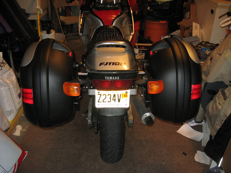

Dunno if it will help, but here's what mine looks like:
E Double
This may not help, but on my '84 I have the bolt on top with bracket beneath.  looking at Bob's pics the sub frame on my '84 is identical to the later models with the exception of the location and size of the tie down loops-located next to the rear turn signal mounts.  I would strongly recommend additional reinforcement at the turn signal mounts.  I have E41 side cases and mine snapped the mounts at the welds (crappy welds I might add).  Mind you, this happened after a week, running the cases empty; No over loading here.  I re-welded the mounts (this time with nice clean welds on the front and rear of the turn signal mount tab; on my year the tabs were only welded on the front) and had a friend fabricate a brace made out of stainless steel that greatly reinforces the entire setup. Here are some pics of the bracket and the wingrack, with cases on;
Hope this helps.
Cheers,
Dennis

rlucas
Holy Jeebus, Dennis...are those sidecases or flotation devices? Outriggers? That thing's wider than my WeeStrom (45L Givis). :yes:

Bob
Quote from: rlucas on June 11, 2010, 08:12:37 AM
Rossi
Yup... I remember being very conscious of how wide my rear end was after installing the Givis.  And the FJ was wide too.  :biggrin:
Bob N.
'93 FJ
'17 V-Strom DL650
Whitby, ON
E Double
Yeah, its a good thing we don't have legal lane splitting here.  The E41s are big cases, but I like that I can fit a large helmet in them.  They're pretty roomy.  But I really like the combo lock hatches on the top;  It makes them super useable.  I also have to admit I kinda dig how big they are, especially with the admore lighting kit I added;  I was rear ended a long time ago, so anything I can do to get a cage to notice me is gravy.  I got pulled over last week by a cop whose only reason for stopping me was that he was psyched by how bright the rear end lit up with all of my lights.  He wanted to know where I got everything from so he could do the same to his Blackbird.
