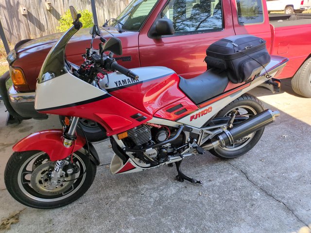

By the way, here is the most clearance I can get.

I have the Hepco & Becker bags and dual slip-ons.
My exhaust is a mixed brand of parts.
OEM head pipes, Black Widow XJR collector and Dominator mufflers. Basically a 4-2 open exhaust system. Dominator offers a few different muffler styles.
Here is a video of how the system sounds.

First of all it looks great, sounds even better! Looks like clearance is more than adequate.
Do you know what the restriction is in the factory exhaust? Is it the collector or the mufflers? I believe I still have the factory head pipes and collector. They would only have about 20k on them. What did you do for jetting for your system? I installed Hank Scott's stage 1? about 15 years ago when I mounted the V&H, the bike could not run any better and I would rather not have to mess with the jetting.
Looks like you have the twin 30L bags, does a full face fit? Being able to throw the lid in the sidecase is a serious want. I would prefer to keep it balanced rather than the 30/40 combo.
