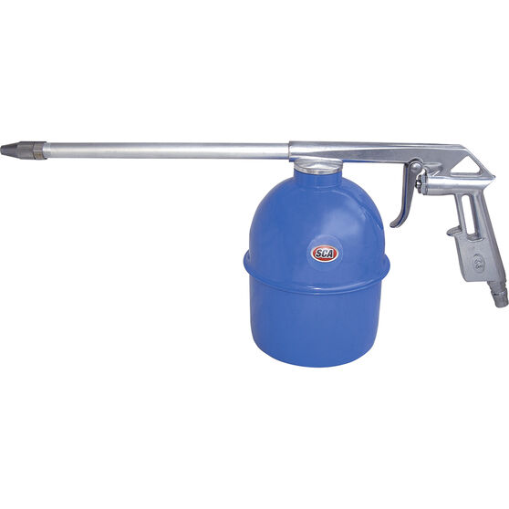

Haha, I'm glad you discovered it after all this time, I assume you remember it has an adjustable nozzle. Unfortunately, the cloud of kero mist is unavoidable unless outside (advisable) with a breeze and requires a change of clothes and possibly a shower before you'll be allowed into the house, or fed. I've also been told reeking of kero is a real passion killer.
For anyone who has stumbled across WD40's cleaning capabilities, the product is 50% kero, which is why it cleans things, but at half strength (diluted by other ingredients) and at 12 times the cost by volume. And, a kero gun is like a spray can on steroids. A great tool.
A really good one costs less than $20. This is the one I use.
