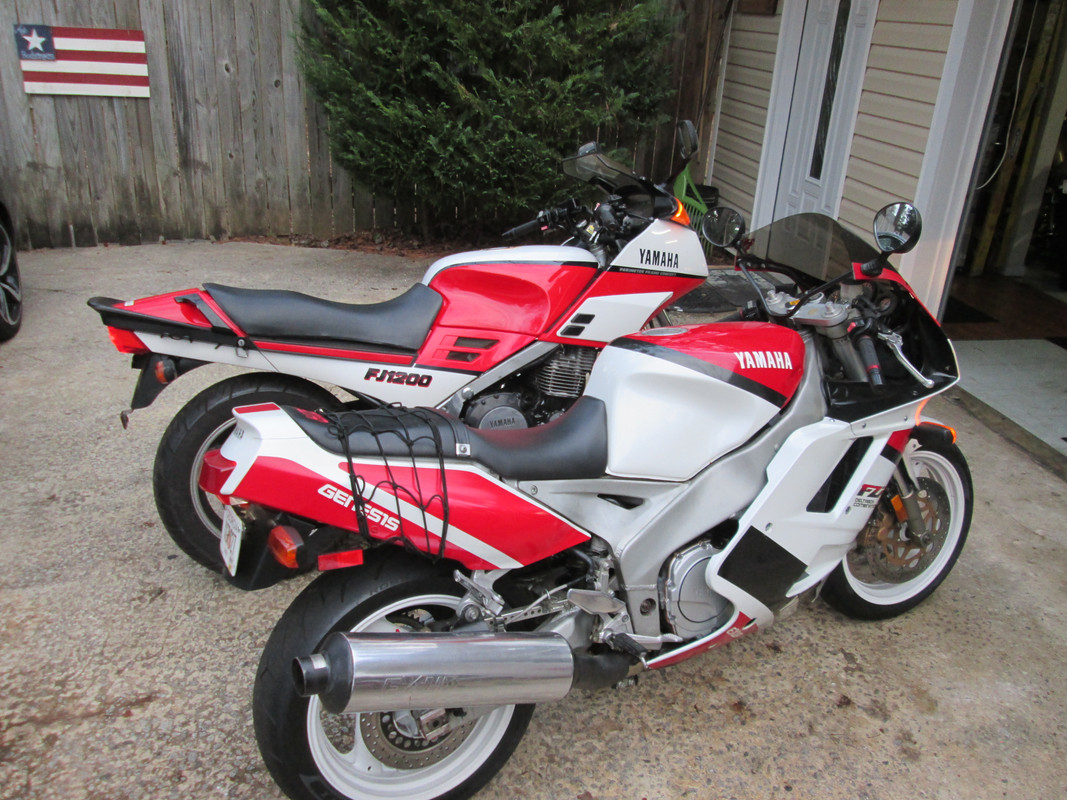

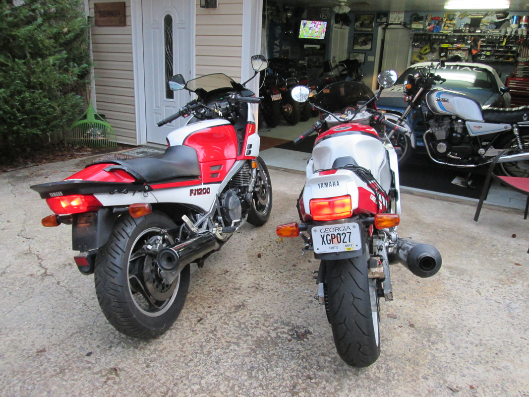

Here's the FJ in current form idling nicely next to his younger brother my FZR1000.   You can see a bit of my collection in the background.....
These guys kinda look like brothers don't they?

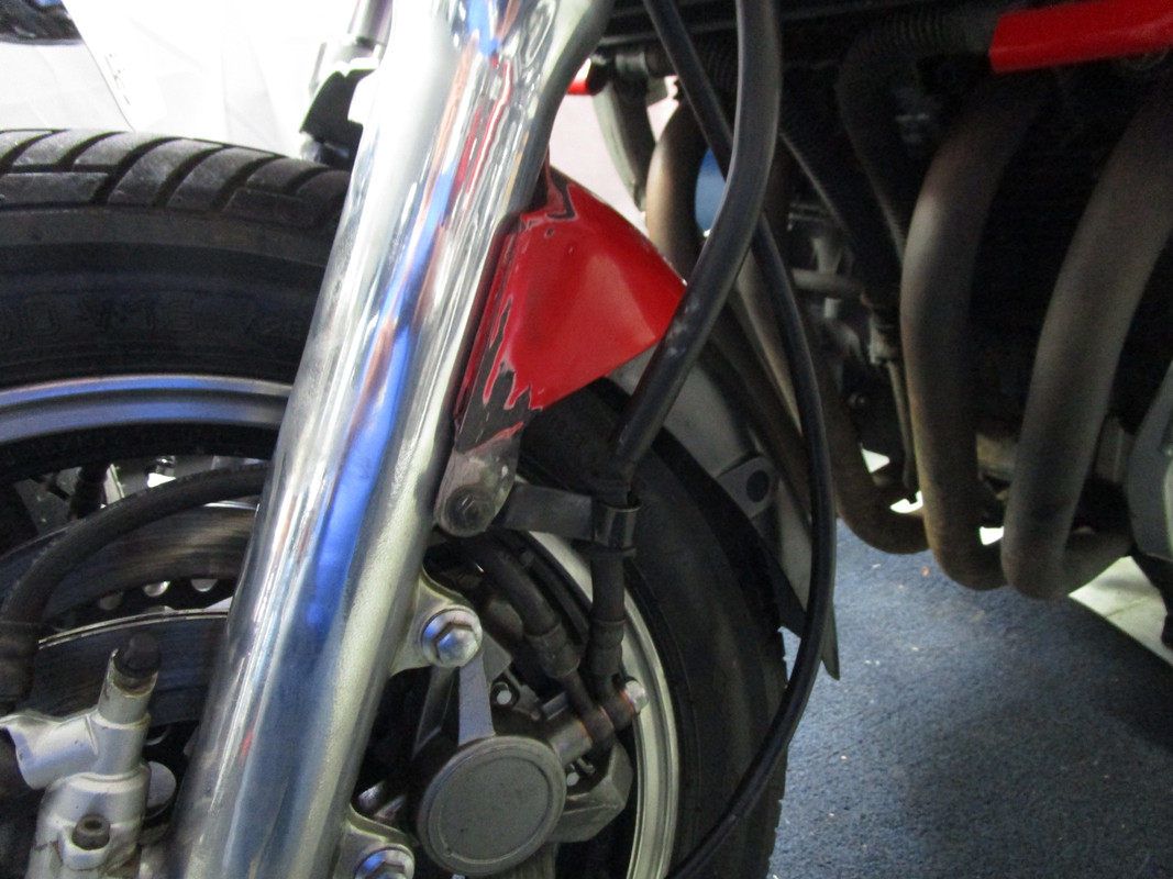

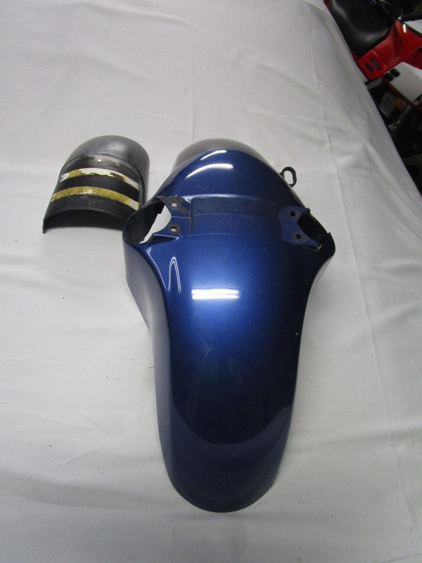

It looks like I'm either lucky as heck or these front fenders aren't that hard to find?   :yahoo:
I purchased this on E-Bay UK for £21 ($28), with shipping £19 ($25) the fender cost me $53 and a two-week wait getting it across the pond.  Looks really great, although it is the wrong color.   I planned on doing some painting anyway so no big deal.  The only defect is a small crack on the tail end where the Previous Owner attached an additional extension.  The little crack will be an easy repair.   The extension looks like it might even have been a Yamaha accessory?
Maybe looking overseas for these type of missing parts is a good idea?   As long as the front end of the bike doesn't decide it wants to return to driving on the wrong side of the road I think this one will be fine! :sarcastic:

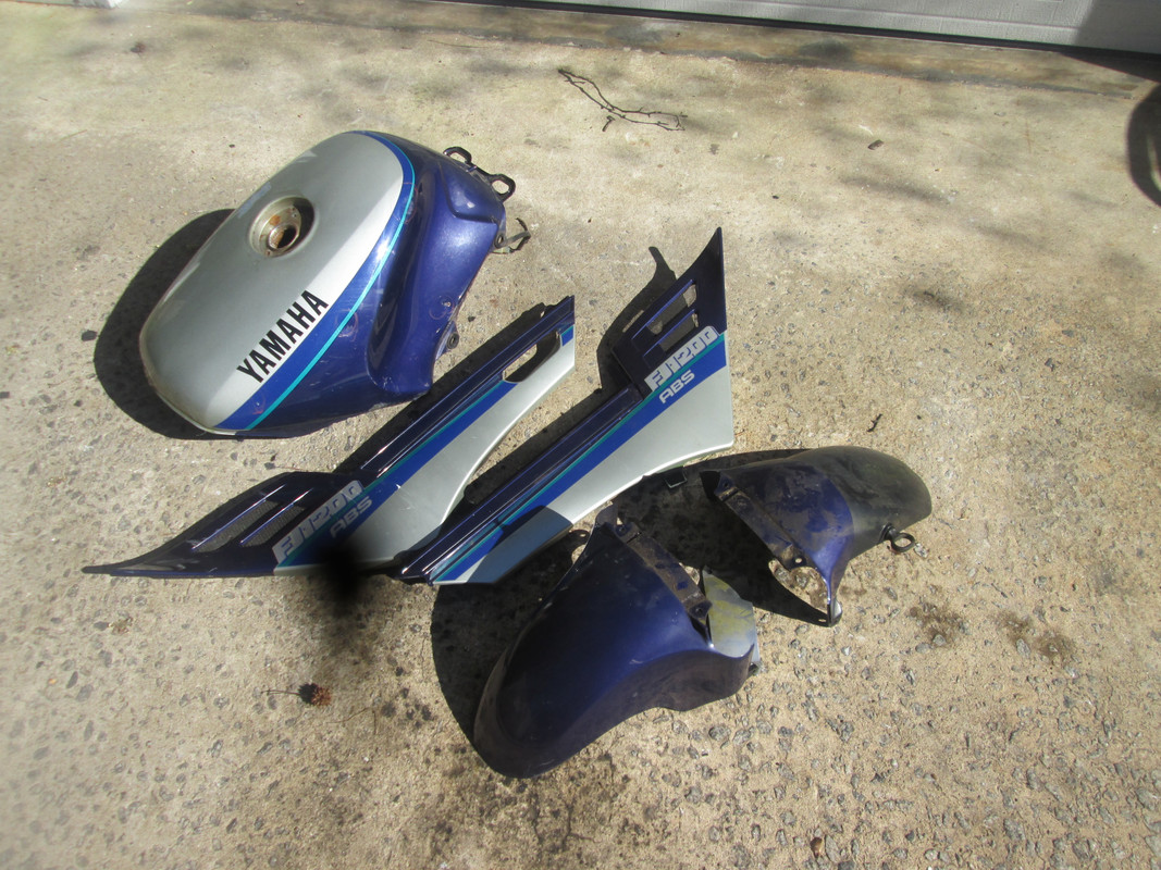

NEW ACQUISITION: '93 Parts Donor.
After hunting for weeks for a chin spoiler, I found this on Craigs up in Tennessee.
The bike was involved in a SEVERE crash and the frame is twisted up and the motor is JUNK (case & cylinder damage).   I was able to get a nice chin spoiler and a couple other items from this heap.
Some parts were removed from the bike before I purchased it including: Front Calipers & Master, Fuel Pump, and a few other bits.   The tank is decent with a couple quarter-size dings and it needs a good cleaning but no rust and certainly serviceable with a very little bit of work.   The side covers are scratched a bit on the left but no broken tabs and certainly useable.    I'll entertain offers on anything anyone might need off this machine, Except for the chin spoiler :sorry:

kboehringer
Meant to post this pic at the end.

Kurt, are the air scoops on the sides intact and undamaged?  Is that what you meant by the side covers?  I'm looking for the cylinder head air scoops.  They would have been located where you had the tie downs attached.
Joe
1990 FJ1200-the reacher
1990 FZR 1000-crotch rocket
kboehringer
Quote from: Tuned forks on February 29, 2020, 04:01:11 PM
Joe
The one from the left was in there but busted up, the right was not with the bike.  Sorry, wish I could help out.... But there are a couple of FJ12's at the LOCAL bike junk yard.  I'll look the next time I am over there (probably in the next few weeks)  The owner is holding a part for my FZR and I have to go get it soon.
I meant the full length body side covers shown in the pic (tank to tail).

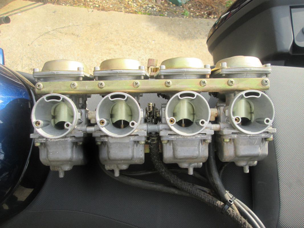

I'm picking away at the crash damaged '93 and pulled these ABSOLUTELY BEAUTIFUL carbs off.   These can't be stock OEM from '93.  These appear to have been professionally rebuilt.   I see some of the PO's HandiWork on this machine and it's clear he couldn't have repaired or rebuild these.  Aside from the fact they were 1000% cleaner than anything around them in the area, the socket head cap screws on the covers seem to indicate a rebuild by FactoryPro  (San Rafael, CA) as I know they do this.  Who ever did these they are like new, floats look new, insides are spotless, and there is not a single screwed up jet or screw from the wrong driver being used.
NOW, I don't think I can use them with my gravity fed '86 unless I pull them apart and install the dual feed?  These are set for the '93 and it's fuel pump which would have no issue keeping them full as needed whereas the gravity fed '86 needs the two fill ports.
I don't SEE anything else different?   I don't really need these and I just installed the complete kits from RPM in my set.  I was hoping for a decent set I could replace my broken post body with but it would be a total waste to bust these up unless ya'll tell me there is something special about these that would improve on my OEM '86's?
Thoughts?
