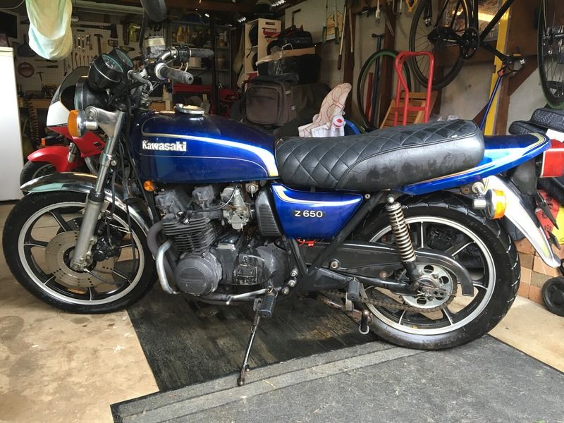

However in news that may disappoint a few, the works on this bike are now just to get it running and then put it up for sale. It was intended to get this bike running and on the road, however an opportunity to purchase a KZ650 presented itself and I jumped at it. I have always maintained a "1 in 1 out rule" for my garage so this means the FJ1100 must find its way to a new owner.
