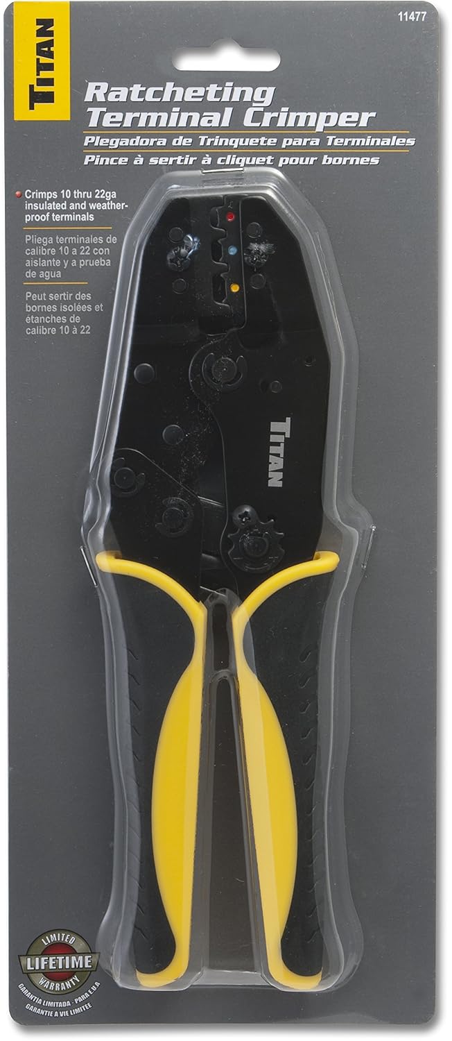

Yep, I agree with Chris. a *quality* mechanical crimp is best for high vibration environments.
The key I've found is investing is a quality ratcheting crimp tool. I've had this Titan Crimp tool for over 20 years now
$26 on Amazon: https://www.amazon.com/Titan-Tools-11477-Ratcheting-Terminal/dp/B0069TRKJ0/ref=sr_1_1?s=hi&ie=UTF8&qid=1467226992&sr=1-1&keywords=wire+crimpers+tool
I love investing in good tools.
Damnit Pat!  I've got enough things to spend money on already!  Good price - I think I'll have to get one of those ...
