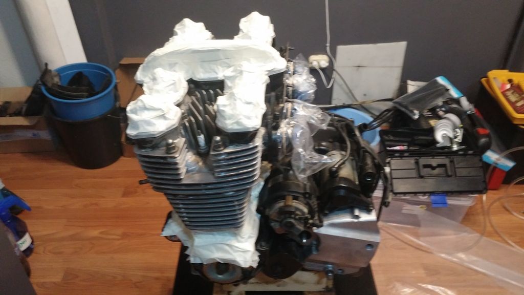

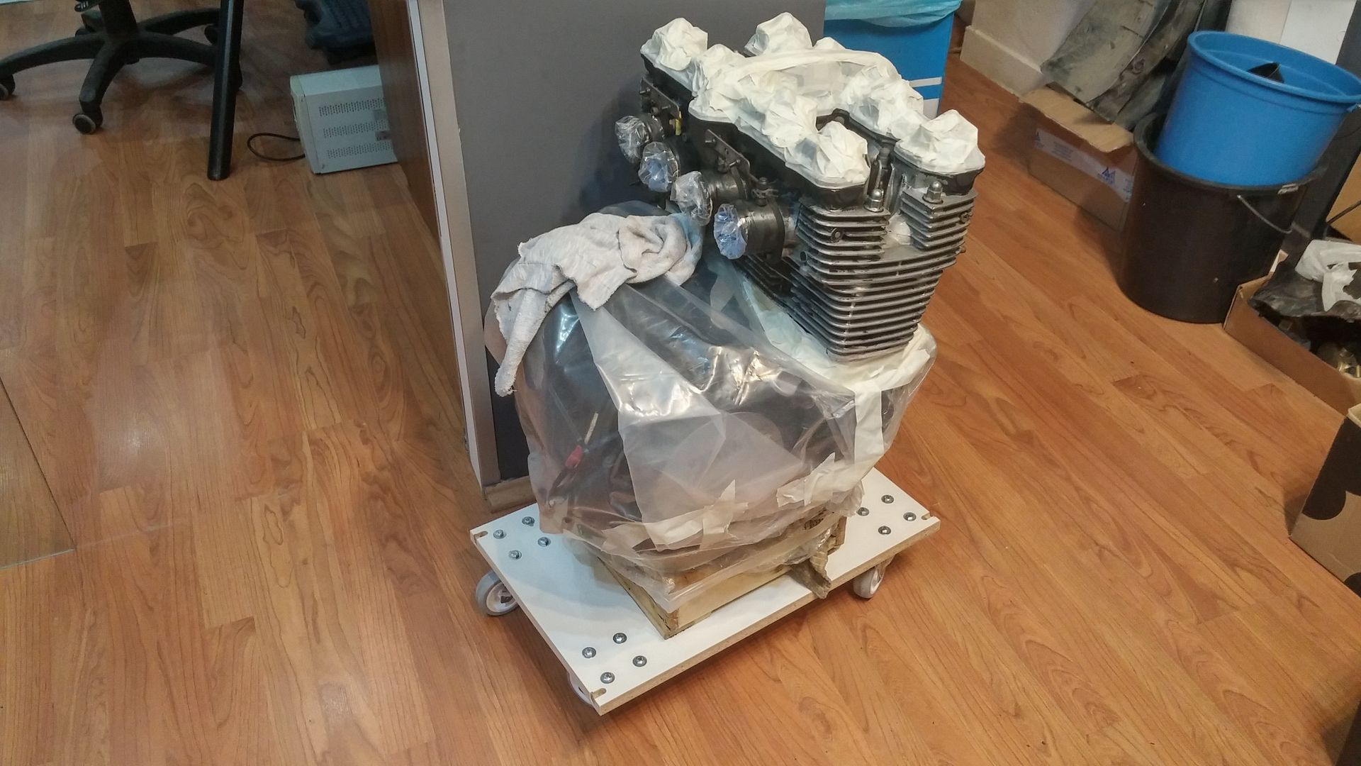

Drop down the engine, clean and paint the engine fins (I'm not going to rebuild engine. I don't have that  budget and also It runs well, ı think )

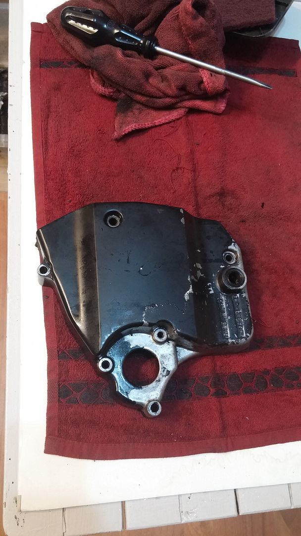

Chop some of the fairing  mountings from the frame, and subframe, sand it and paint. (Maybe Powder Coat will be nice? need advice*)

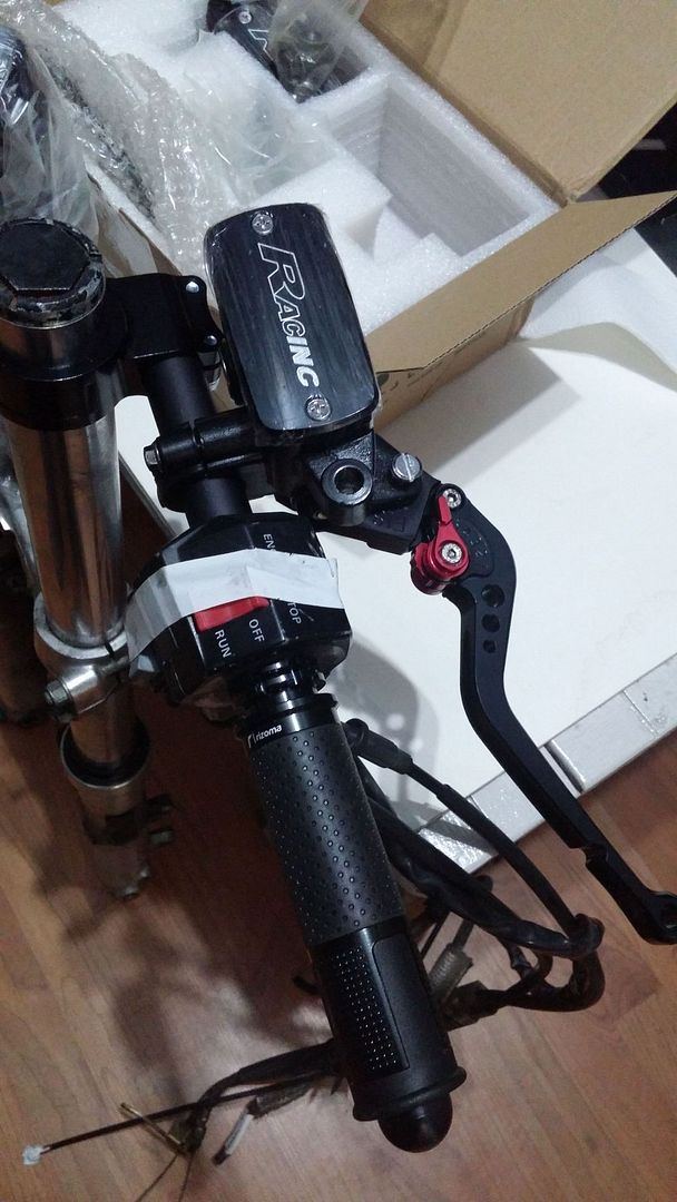

Change all the handlebar equipments. New master cylinder, levers , grips mirrors and accesories.

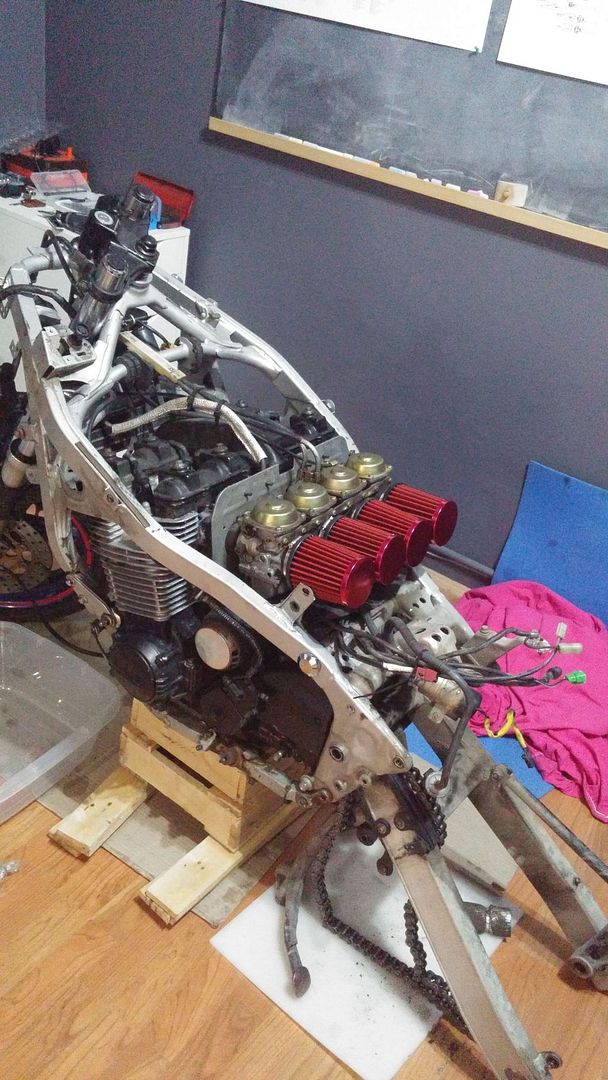

At the end I have to make some tuning to carbs I plan to use red open air filters

This is what I want. The filters have to be visible . Those filters are  larger filters that used on cars. I don't know if it gonna work.. We'll see..

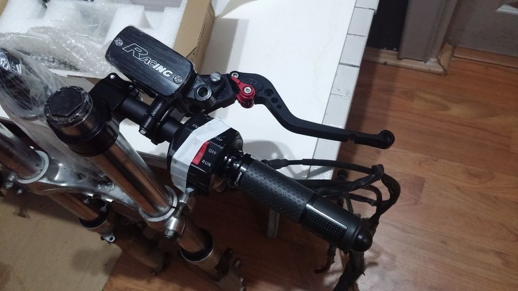

Some accesories.. Bought only for motivation  :good2:
Can't believe that levers are come from China. Good quality..
The Vortex handlebars are from USA. 7 degree aimed racing levers.

What you guys think about frame painting? some says poweder coating is good, some give advice to go with acrylic car paint?
Powder coat is more forgiving when it comes to impacts from small stones and crap from the road. Either way you go make sure you start with a really clean surface and a good pre-treatment. The pre-treat is like a primer and will take a good powder coat finish to a longer lasting finish. If you want a glossy finish then use the automotive acrylic or find a powder coater that does acrylic powder.
Those look like the same levers I have on the Busa controls on the FJ1100.  Agreed - nice levers and fairly quick shipping.  Bought a second set for the street bike setup.

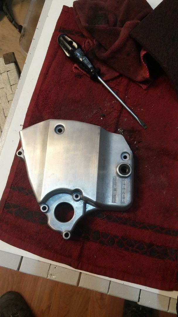

Hi Folks! Some updates of my project bike I made a lot of things since my last post:

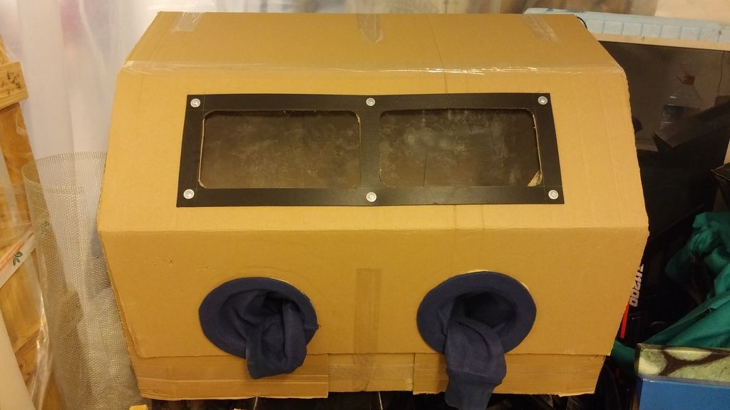

The best of my decision at the beginning was to build a sodablaster cabinet. It makes small parts easily clean and ready to paint.
Engine was in good condition. No need to rebuild it. That's why I concentrate on paint and chop some parts.
I also point out that all the stages in this project I never done before. hope all  goes well  :i_am_so_happy:

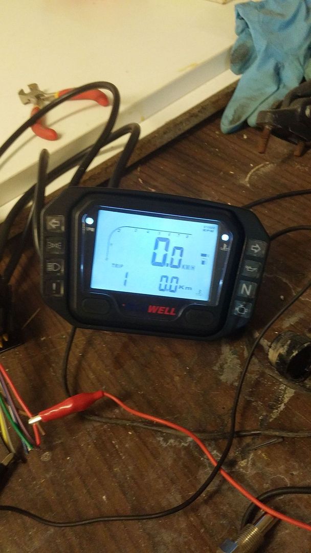

I buy smaller  display for a FJ but I hope it gonna be nice and smart Gauge.

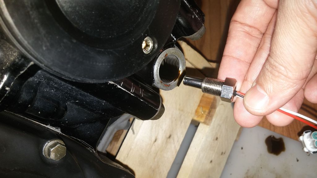

I have an ide to add a oil temp sensor to one of the ports on the crank galley. It displays the temp on this gauge.
This sandblaster cabinet built for sanding small parts. It stays a little weak but it works at least for this project  :good2:
