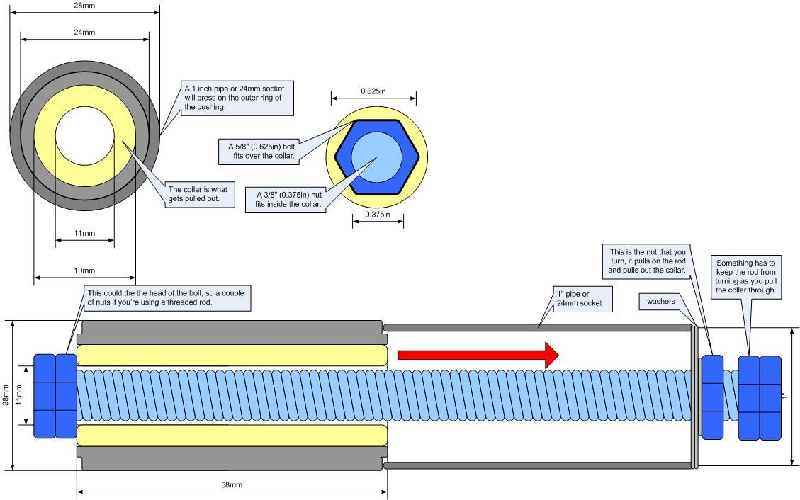

Quote from: Bob on December 22, 2015, 09:00:42 PM
As most folks who have done these know, they can be unbelievably tight. Many of us, having underestimated just how tight, have broken our first efforts at making pullers.
What would be better suited to the task, a fine threaded puller or course threaded puller?
Fine threads = Closer threads = more threads per inch = more load can transferred to the threaded shaft, and it's easier to turn the nut.
After stripping out the threads on the hardware store "all thread" rod,  I had my machinist buddy Paul make a fine thread puller with 1" long nuts.
When my job was done, I sent this tool to Randy @ RPM for his use and other FJ folks to use. Give him a call.

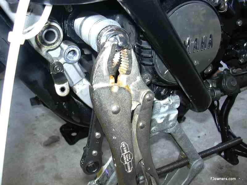

wainot
Ok  .I had the same problem with my 94 FJ1200 . Very bad Vibs  going right through the Bike and Me from about 2500 to 4000 rpm .
I also noticed that the right mirror was more blurred than the left at all times .
I made myself up  3 puller,s  from threaded rod  (THEY ALL BROKE) while trying to pull the inner bush out of the engine mount.
I ended up getting a bolt exactly the same as the engine mount bolt ,but just an inch or 2  longer .that worked fine,
The Left Bush was lightly rusted in and stuck in pretty good ,but it came out under medium pressure ,
But the right side Bush was Rusted in real real  good and I had to put 3 times more pressure on it to get it out .
I think that's why the Right Mirror was Vibrating more that the left at all times.
I then cleaned the 2 Bush's up .Greased them and re-installed them.
,,NO MORE BAD VIBS ..
This is a must do job ,,  The only real problem I had was
when I reinstalled the engine mounts .I then had a real problem getting the  spacing pipe between the mounts.
The spacer pipe that's about a foot long, that the main long  Bolt goes through .
(It seamed that the spacer was about 3mm to long).
I loosened the mounts back off but that made no diff .
!!!!!After about 1/2 an hour or so !!!!!.
I worked out that when I removed the engine mounts and spacer ,the Bike's lower Frame must have sprung closer together bye about  3mm .
So I cut a small piece of 1' x1' Wood and a small wedge ,put them between the lower frame
and wedged the lower frame apart by 3mm .
"""BINGO"""  it all then fell into place real easy.
So its smooooooth  as silk again
I have hopefully attached a photo of the right hand side Bush and my 1st attempt of a puller .
I found its best to use a Bolt the same a the Bolt that can out of the engine mount . but an 1" or 2" longer.
Its well worth the effort ..
Hope you have all had a good  Xmas .
regards  "wainot"   Phil from Aussie
