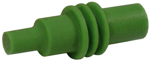

When you ordered the spare connector you could have also ordered the plugs. But the RTV should work quite well.
Firehawk068
Quote from: FJmonkey on October 26, 2015, 10:50:03 AM
I searched, and couldn't find the plugs easily. The connector was cheap enough, so I just ordered another one.
Alan H.
Denver, CO
Quote from: Firehawk068 on October 26, 2015, 11:36:40 AM
You got it done, that is what counts.
Alan,
As monkey already mentioned, they also make "plugs" for the connectors for exactly what you did. You slide in the plug, fold over the cover that you cut off and you know have the sealed connection.
But, when you use the plug you can remove the plug in the event you need to use the connector.
Firehawk068
Quote from: racerrad8 on October 26, 2015, 01:02:57 PM
Alan,
This is good to know for the future. I did look, but could not find any of these. (I was probably searching the wrong terminology)
