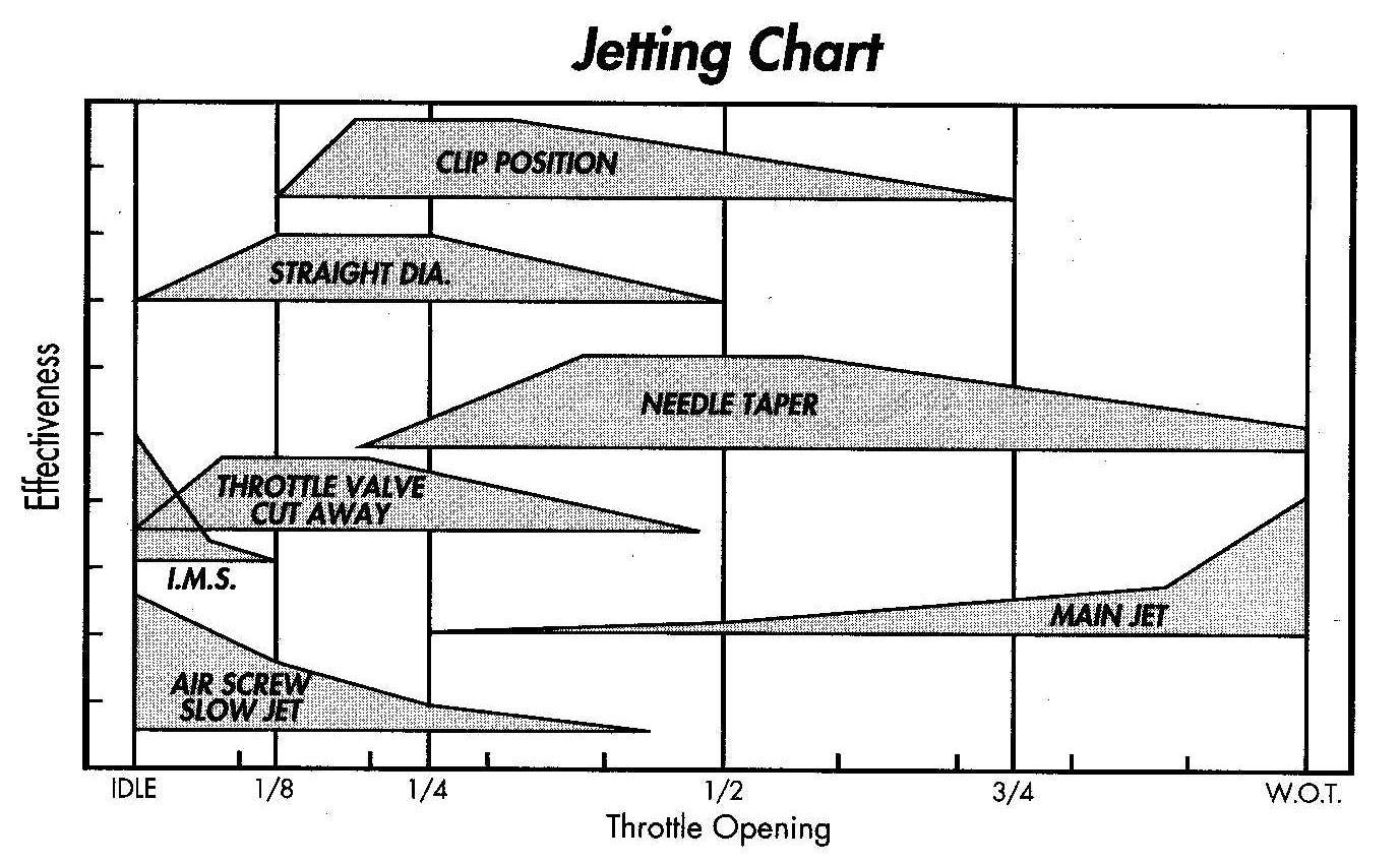

Gives you an idea of what effects what at what throttle position.
