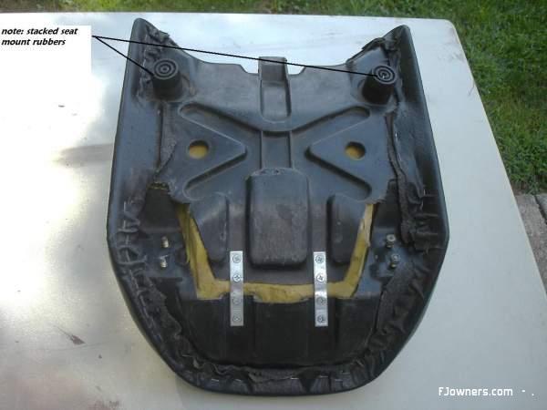

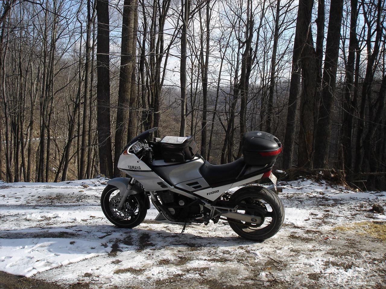

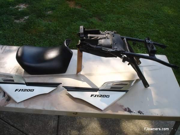

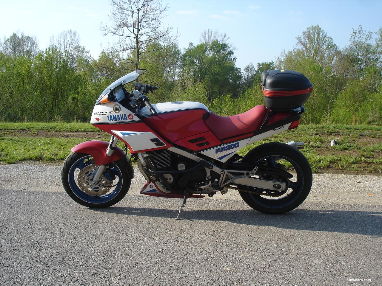

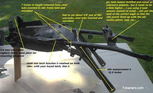

well i wasn't joking :) "the kit" consists of the subframe, side panels and seat. it works with stock tail section & handles. couple zip ties and sturdy spacer under the battery box and you're good to go. yours if you want it. need to work out a fender extender tho. every molecule of moisture that the rear tire rolls over ends up on the FRONT of your helmet and tankbag and even on the windscreen.
these work? : http://fjowners.com/gallery/8/23_10_01_15_8_07_21.jpeg
http://fjowners.com/gallery/8/23_10_01_15_8_15_26.jpeg
