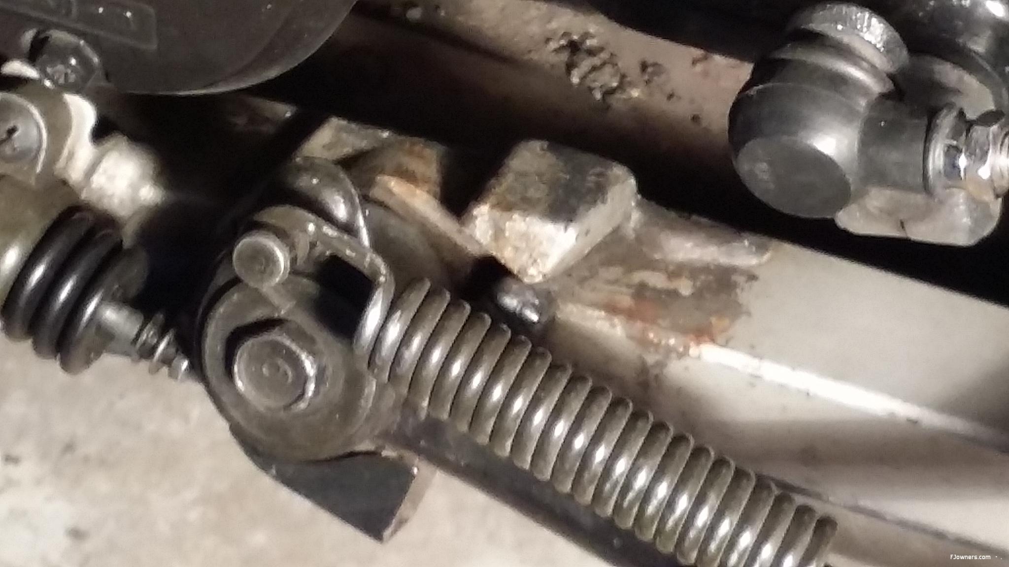

Well I mounted a pair of lowered pegs this week like the ones Fred found.  I'm real happy with the new position and have been looking at this mod for a while. Fred, thanks again for researching and finding these.  You are the FJ aftermarket internet king!
I rotated my set down for maximum drop and ran into a clearance issue with the side stand where my foot was resting on side stand and it really was in the way.  I got a friend of mine to weld a spot on metal on the stop to keep the stand from coming up as high as it did before.  This is what it looks like.
I also had to cut the 'spoke' off of the side of the stand as that was still in the way even after limiting the amount the stand is able to go to it's up position. The little nub  that is left still works well to get t he stand down.
I also bent the shifter out a bit as the drop in the pegs puts your foot a little farther away from the bike.
I have one last problem to work out.  I  have the shifter adjusted all the way down.  It's OK, but if I could get it down a little more, it would be perfect.
