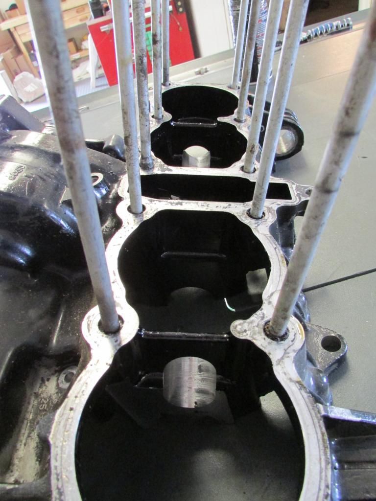

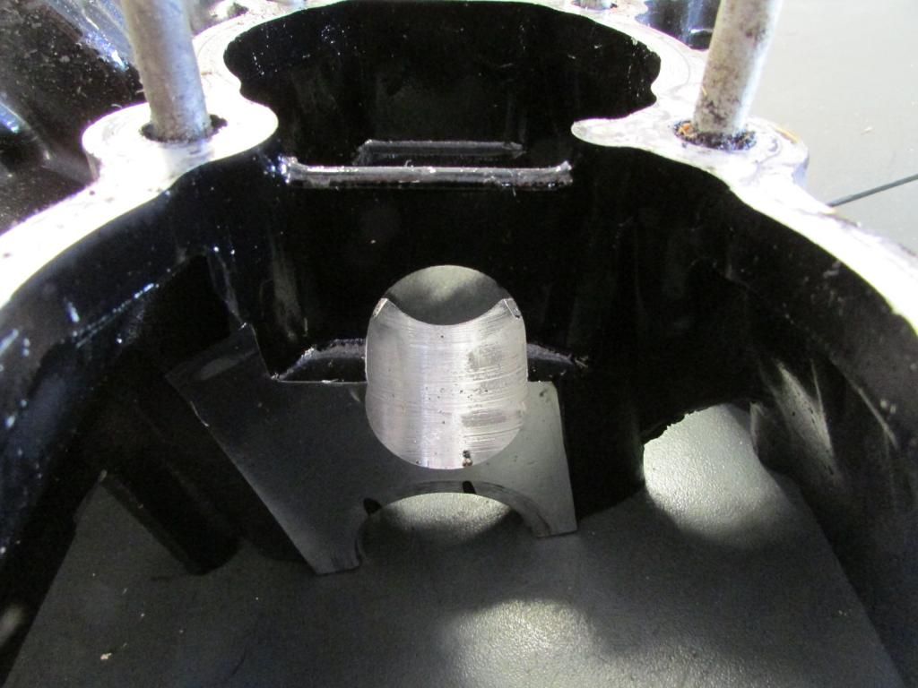

Quote from: FJ_Hooligan on July 30, 2014, 05:49:58 PM
"Windows between the cylinder cavities in the crankcase reduce pumping losses at high RPM..."
Which Yamaha addressed already beginning in 1984...
You can see the "windows" or pressure differential ports between the two outer cylinder cavity webs.
