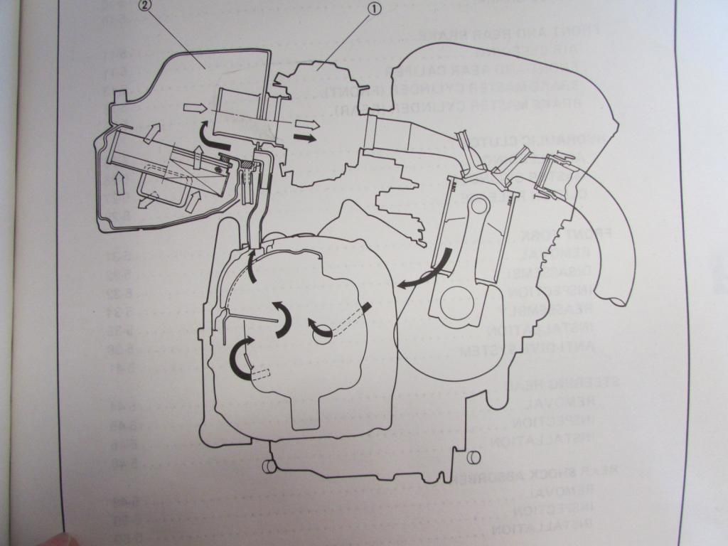

Quote from: Pat Conlon on July 03, 2014, 12:11:31 PM
I agree Noel. The negative pressure inside the airbox is an definite advantage for scavenging crankcase pressure.
That's the reason pro stock drag bikes have (several) vacuum pumps.
I looked at my UniPods to see if there were a way I could pipe in the crankcase vent hose but there was no room that I could see on the Uni's rubber mounting base.
After a long hot ride, stopping at a signal and smelling the blow by coming off the crankcase vent is annoying
What if you made a vacuum manifold coming off of all the nipples on the intakes? The ports we hook up the sync gages. Parker/ rancor company makes vacuum breakers I believe as small as 3/8in. Our crankcase filter we install would attach to the top of the vacuum breaker. Huh...second thought, probably a bad idea to equalize vacuum on intake side of carb. Should be on filter side of carb

Yup, need to be on the filter side of the throttle butterfly.  Downwind=manifold vacuum, NG.  I remember looking for a place to install a hose barbed fitting and there was no room.  Maybe on the next-gen of Uni-pods ...

I've had the same problem with fumes at a standstill when the motor is hot, currently trying this set up, only been running it a month or so, gets rid of the fumes and doesn't seem to have any adverse effect on carburration, but  I read some posts that say it's better to vent to air than recycle through the carbs, so I'm not sure about carbon build up etc. long term, and then again some say the oil helps lubricate the valve stems. Does anyone know truth in all this?
Anyway I used a Chammy container, don't know if that's what you call it elsewhere, the larger tube comes from the crankcase breather and each carb should more or less get an equal dose, you can see the condensation in the tubes. I made them all push fits so there is nothing to come loose and end up in the intakes. Not sure if some sort of filter would be a good idea inside the container, but so far the is no build up of oil residue etc. in the bottom of the container. The alloy checker-plate has nothing to do with it, that's just where I keep my tool kit.

Thanks John, that's a nice setup.....yea, I'd love to do something like that with my UniPod foam filters, but no way I'm going back to a paper filter. I have not had good results from K&N oiled paper filters, except in my Miata.
No room for nipples on the rubber base material on the Uni's so that leaves the foam filter material itself.
Some threaded hose nipples with washers might work on the foam, but I doubt it, the hose stress on the foam material will probably cause a failure.
Inside the UniPods there is a stainless spring that holds the shape of the intake chamber, preventing the foam from collapsing from vacuum.... Perhaps there is a way that spring can be used to support the vent hose?
I'm working on it.....
Re: Lubrication...I suspect the oil vapor coming off the crankcase won't be any lubrication benefits since it would the thoroughly diluted with the fuel/air mixture from the carbs.

I am going to let my inner voice of reason speak here...
I believe that is a bad idea.
On the factory air box the breather hose is venting out of the direct suction of the carb throats. The air box connection is under the carbs so the oil & water contaminants can drop & drain before being sucked into the engine.
The slides are not very happy when they get anything on them as they then start sticking. The water vapors you see in the hose will also be in the throat of the carb and cause corrosion of the raw aluminum carb bodies and oil vapor will allow crud to build up and cause slide problems over time.
And finally, the amount of suction you have at the pod air filter is so much greater that you no longer have a crankcase vent, but a PCV system. Sure, the air box is considered a PCV system as well but it is using the totality of the vacuum from the carbs at a 180* and greater distance from the vacuum source.

Thanks Randy, maybe time for a bit of a re-think then, how about some sort of filter between the tube from the crankcase breather and the the tubes to the carbs? and a drain to get rid of condensation.
Cheers, John.
"It's a fine, fine line between pleasure and pain" - the late great Chrissy Amphlett & Divinyls. Never truer than when you're pushing hard on the bike. A good song to keep in the back of your mind.
Actually I was thinking along the lines of a sealed catch can (not vented) This would allow the oil to condensate and collect before routing thru the carbs. Fill the can with scrub able stainless steel to help separate the oil out of the blow by vapor. Have a drain at the bottom of the can where you can periodically drain off the accumulated oil.
We use this set up in turbo Miata's all the time. It works well. Not exactly CARB approved 'thou...
I'm mean, jeeze, we got all this room now that the airbox is removed. We can come up with something.
I'm tired of a stinky bike at stop lights.
