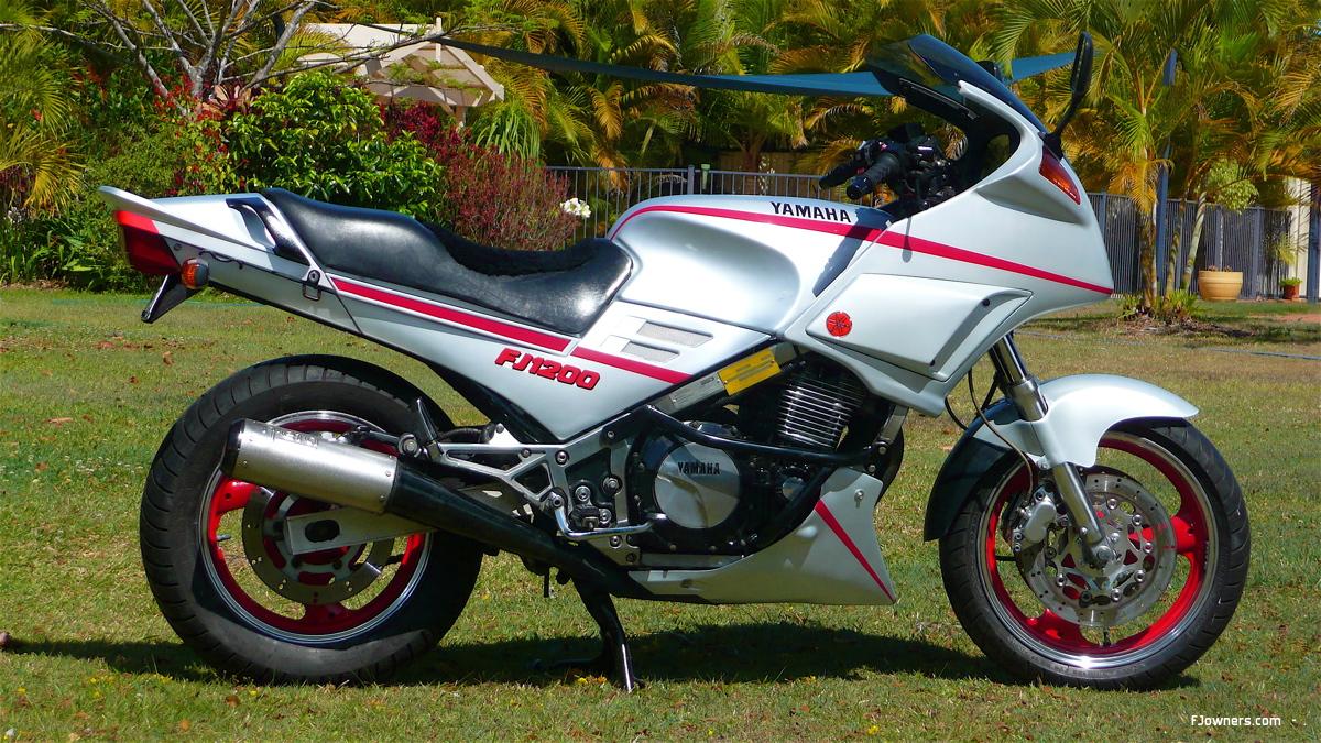

Check the pic in the gallery "making progress"
I have now finished the fin edges to a mirror finish on the engine.

The man knows how to make things shiny.  This is the pic referred to in the original post.
