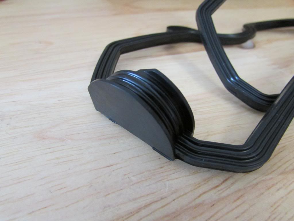

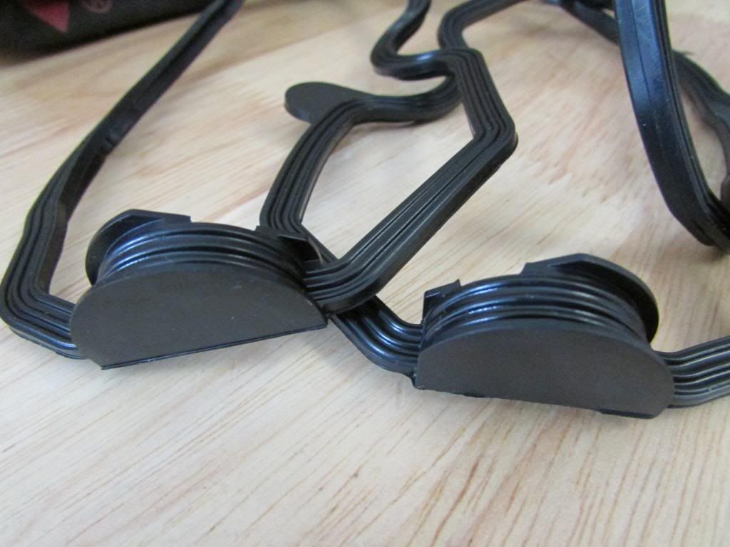

Randy, after taking a closer look here is the split gasket. the metal disc is full exposed.
As for the retaining lip on the inside , I don't see one, all I note are 4 ribs ,same in appearance.
The other half circle appears the same, 4 similar ribs and no retaining one.
Im wondering if I have an inferior gasket? This was part of a full gasket kit.. but there is no retaining lip that I see.

Yep, most complete gasket sets are cheap knock-offs of the original quality, which is the reason I will never sell them.
The Yamaha gasket has a retaining lip on the interior of the gasket on both sides
