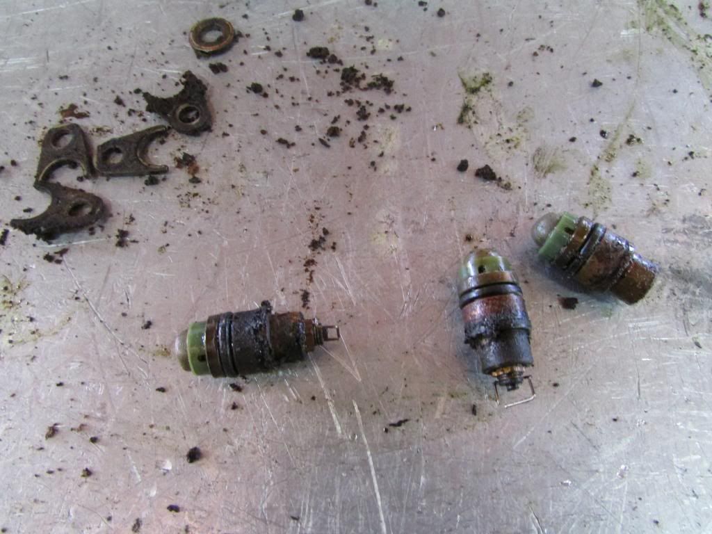

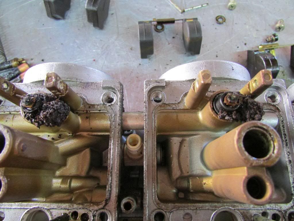

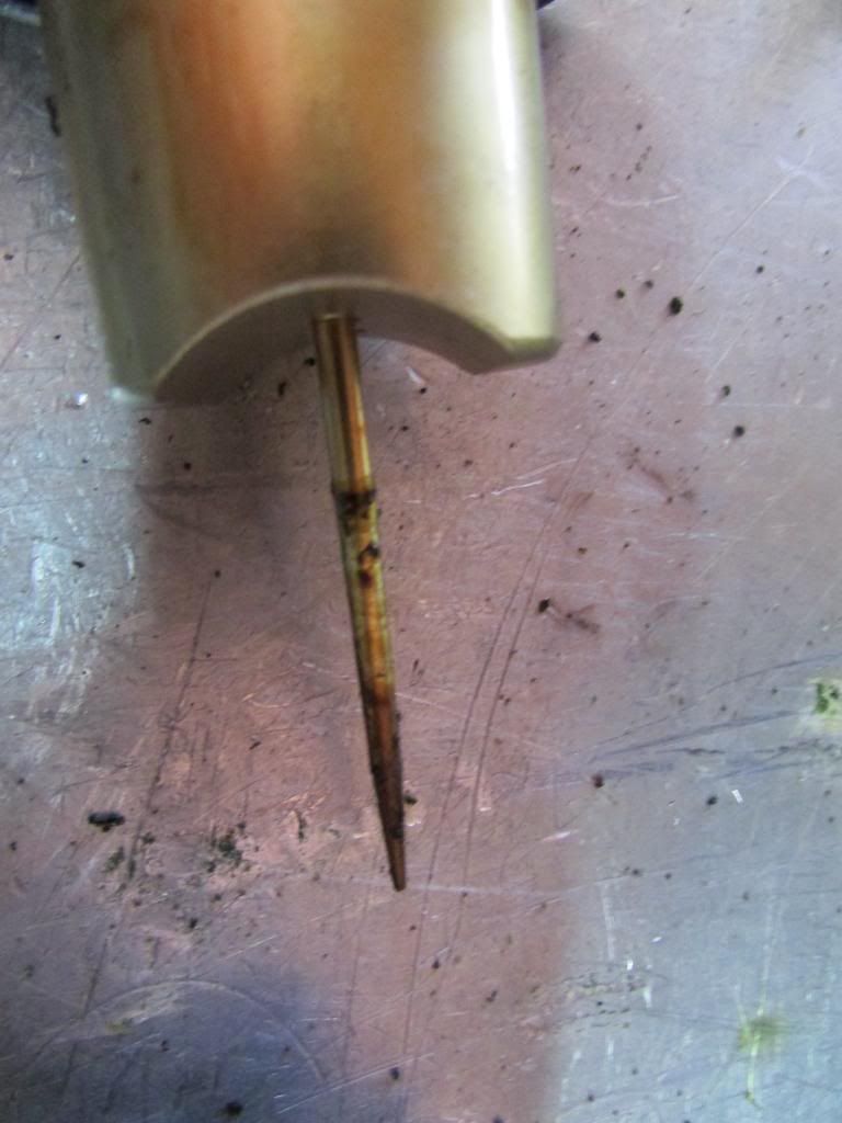

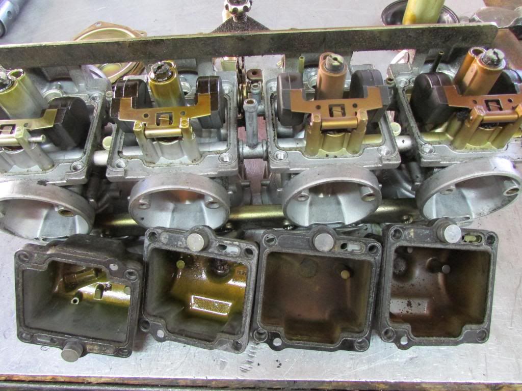

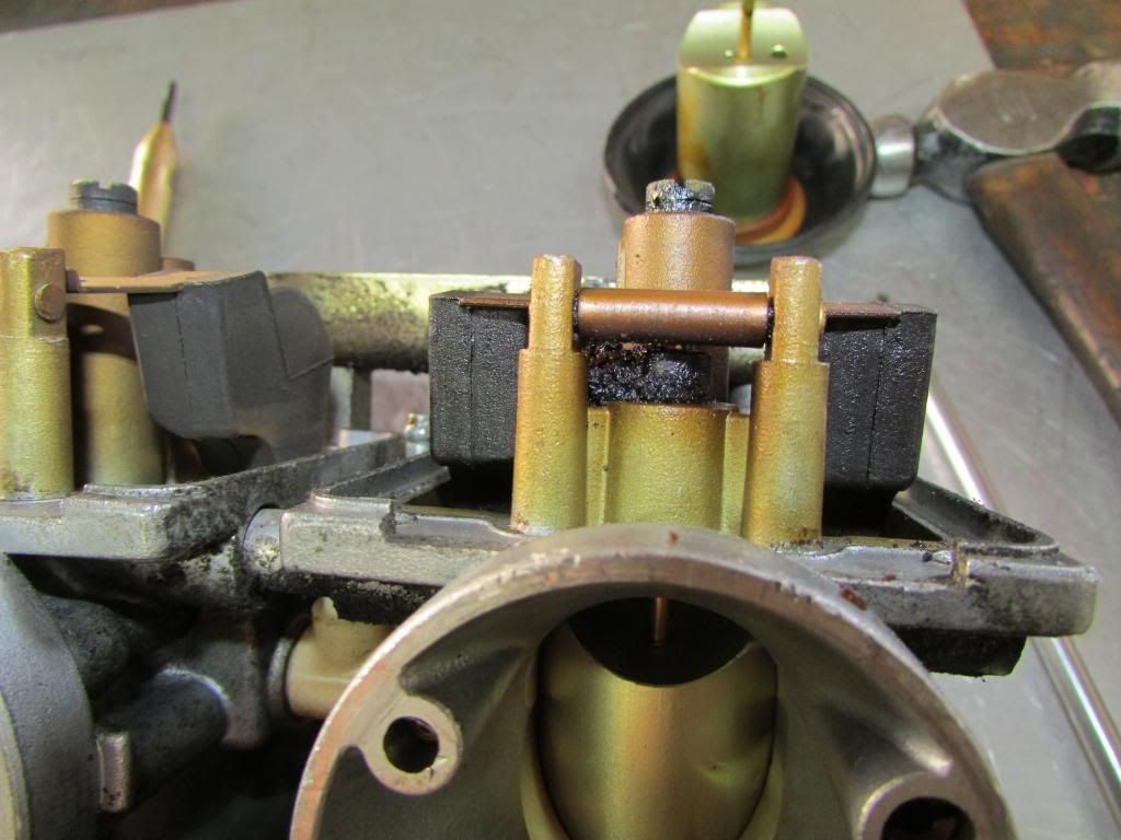

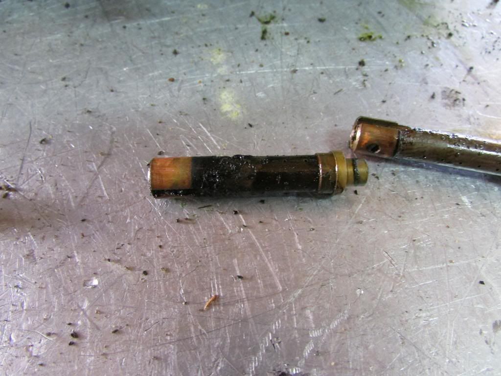

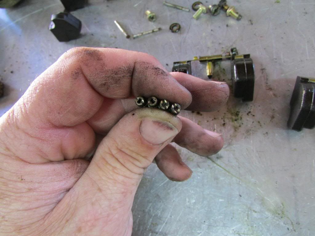

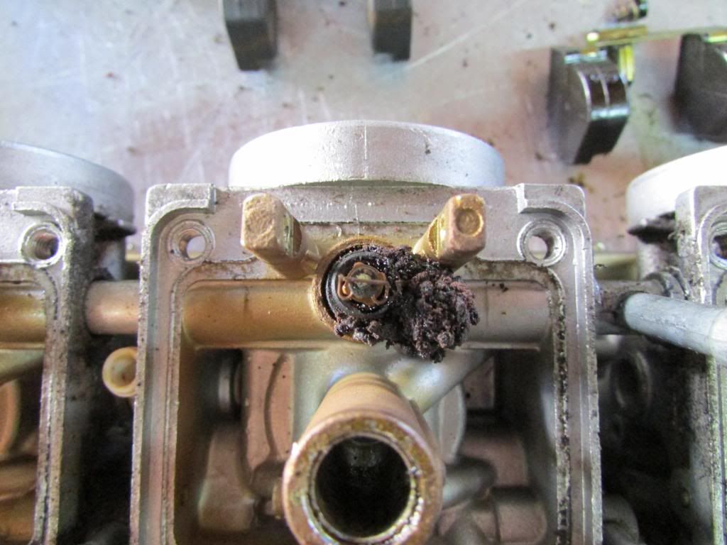

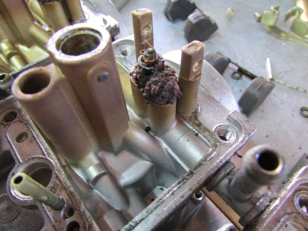

Well...
Here we go, and I thought Billy's carbs were bad...these are 100 times worse
Three slides stuck in carbs
Two float needles corroded into needle seat
Three floats stuck; would not move with pin in.
Major Corrosion of internal carb parts.
Two pilot jets on right completely plugged to top.

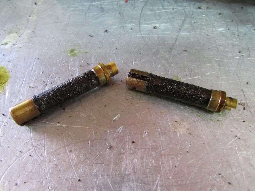

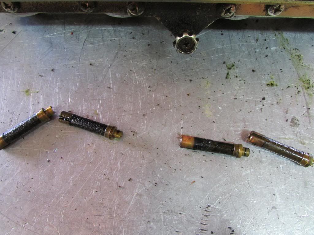

All emulsion tubes had to be driven out.
I tried to blow carb cleaner and air through the internal posts of the carbs and most are completely plugged. They are in the cleaner now. If I can get them cleaned out then I think they can be saved, if not I gave the best effort.
We'll see...

Looks like a write-off to me.  I would guess that the petcock wasn't working and let a tankful of fuel slowly replenish the bowls as it evaporated.
I've never seen that kind of gunk that attacked only the steel components.  Did the PO maybe use something funky in the fuel to try to stabilize it and ended up doing more damage?  Looks almost like battery corrosion.  Remembering stale 2-stroke fuel from back in the day, I can only imagine the stench.
I'm surprised that no float posts were harmed in the making of these pictures.
