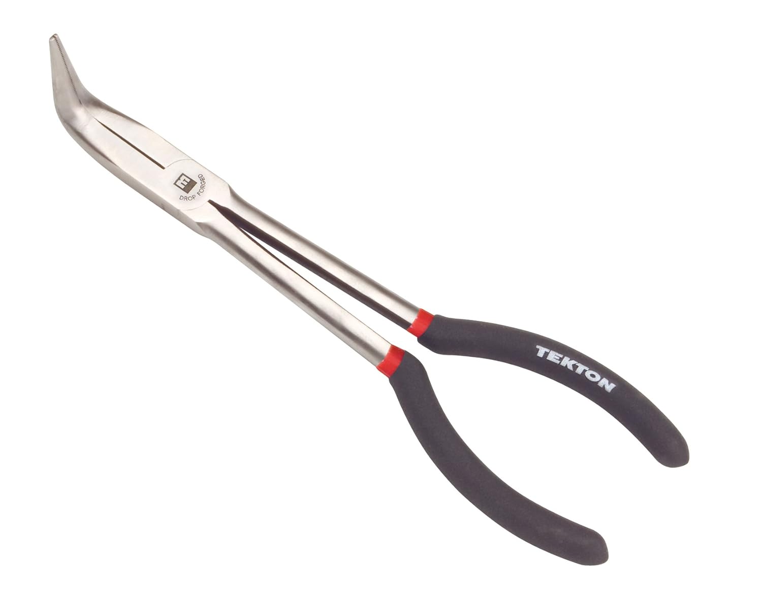

Do you have any tips to share?  That's one of the most frustrating tasks I've experienced working on an FJ.  I do it before mounting the carbs, but getting that cable threaded around the back of the mechanism and into the hole is a major pain.  I've used needle nosed pliers, tweezers, hemostats and it's always a chore.  What's your technique

Sorry Hooli, I just did it last night but can only recall that it involved a pair of these:
A pair of long bent needle nose pliers and wedging the butterflies open with a screwdriver handle. Other than that I would have to do it again take note of what I do.
BTW, those long, bent needle nose pliers get a surprising amount of use around the workshop, very handy tool.
