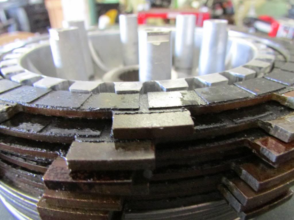

Just replaced the friction plates on 86 model.  The new ferodo plates were right at the upper limit for thickness.  The old plates were well below the minimum.
But when I put it all together, the clutch lever does nothing.  Seems like there is so much material in the clutch that there is no room for clutch release.  Lever has free play for most of the throw, then super stiff for the last little bit of squeeze.  Something is not right.  Need advice!

Thanks Ed, but I already tried that to no avail.  Next I removed 1 friction plate and 1 steel plate to allow room for clutch release and now the lever works fine, but I know it is not correct to leave it that way.  I want to have all the plates in there.  I just found a big write up in here about clutches.  Gonna read that and see if I come across anything.
sovrin
Here is what I know now:  The new friction plates measured .118" which should be perfect.  Service book calls for .114-.122 range.
If I install the whole set, it fills the clutch boss, and then there is no clearance to install the pressure plate to get the teeth to engage
into the clutch boss.  I just figured out that my 86 is a "California" model.  Does anyone know if they have different clutch than all the rest?
I thought the main difference was pollution stuff.  I just dont like knowing I have 7 plates instead of the 8 that should be in there.
I'm baffled.  Open for advice.  Anyone?

Previous owner must have removed the wire ring.  But the new clutch discs have 2 narrow and 6 wide.  Exactly the same scenario as I removed the old ones.  Alternated them with steel plate between each one.  But when all said and done, just too much material there.  I took it apart a 2nd time to see if I got the order wrong, and all is correct, but for some reason it cant hold them all.  Makes no sense whatsoever.  I put the narrow ones in like bookends, 1st and last spot.
I just stacked a clutch boss and the pack is almost flush the the top. But the recess of the pressure plate teeth as well as the recess for the clutch disc allow it to engage.
I wonder if your slave cylinder spring pushed it out too far and now the piston is cocked not allowing it back into the housing. Just for a try, remove the clutch pushrod and see if the pressure plate goes on properly.
If it does, then you have a slave cylinder issue.

Quote from: sovrin on May 05, 2014, 06:15:12 PM
Unfortunately that is the case with most aftermarket fiber replacements. Barnett, EBC etc. I only use OEM plates whether it is Honda, Yamaha, Suzuki or Kawasaki. The OEM plates hold up under dragracing and roadracing conditions and they fit everytime. The older style Barnett fibers threw a lot of clutch dust into the hole too. This is very visible when you disassemble an engine and see lots of scratches on the piston skirts...you can imagine what it does to the oil pump rotors.
