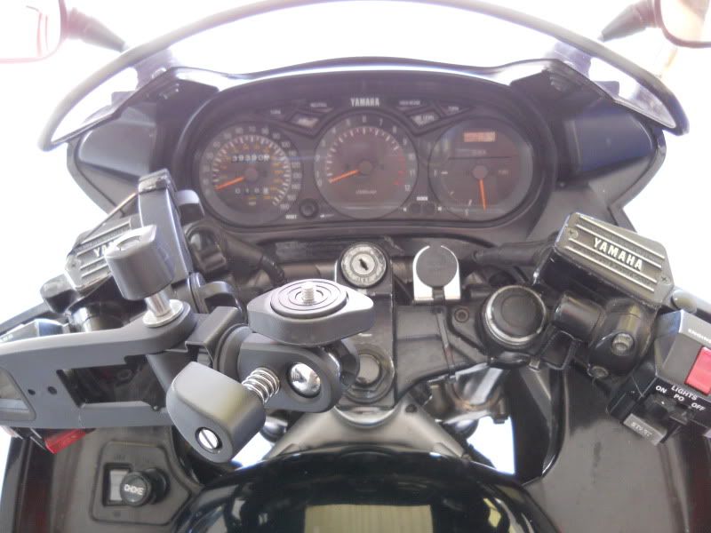

I have by far the cheapest rednecked $4 plug - zip-tied just to the right of the ignition switch. I put an inline fuse in it near the battery. I have a tank bag that houses the GPS.
That clumsy contraption on the left is my camera mount.
