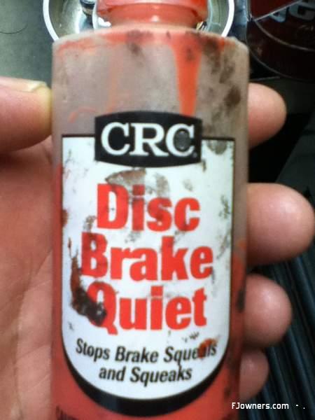

Leon, I use a rubber-esque anti-vibration "fluid" on the back of the brake pads to prevent this.  I do this on all my vehicles and it does  the trick.  The stuff I have I purchased at at Kragen (now Schuck's Auto Parts).  It comes in 6-8 oz semi-clear bottles, and is fluorescent orange in color.  Your auto parts man will know what you're looking for.  Obviously, put it on the non-friction side of the pad, per the directions on the bottle.

Ed, is that stuff a spray or brush on material?

Consistency is more like toothpaste than spray or brush.  I typically squeeze a bit out & use a spreader to distribute to the piston contact areas.  That'll do it  :hi:
OK, I'm home and took a picture of the stuff.  Sorry it looks so bad, but this bottle is a few years old.
