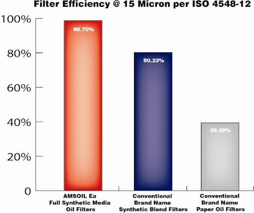

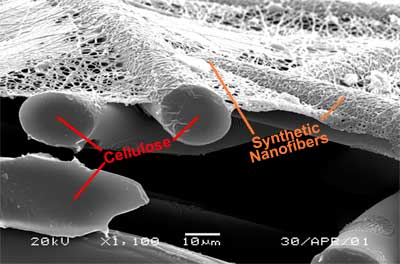

This thing filters to 35 microns???  Why bother? If the oil filter has to filter out pieces of sand, your bearings are T-O-A-S-T!  And that's where you are getting your oil pressure from.
Amsoil filters filter to at least 15 microns, regardless of what anyone else claims for 'Most other filters".  They (Amsoil) even credit the 'typical filter' as being at least somewhat efficient at 15 microns, not the 100-ish microns that Scott's put out.
Further, as I understand, most wear occurs with particles from 4 to ~ 20 microns.  By the time you get to 35 micron particles, the party's over.  And for the record, most of the contaminants in the oil arrive through the air filter.
This is the Amsoil air filter media, but it is very similar to the oil filters.  Now do you REALLY think a piece of 304 stainless screen is going to filter out more crud than this media?  And who cares if the media is good to 600ºF?  By that time, even Amsoil is cooked, let alone ANY dino-oil.

My limited research draws the same conclusions.  Here is a good link:
http://www.calsci.com/motorcycleinfo/Filters.html
They specifically talk about the Scotts filters and say:
QuoteThere's a new type of filter being marketed, the "laser cut stainless steel filter," which we're told is "good for the life of your vehicle."
These filters typically have 35-40 micron holes, which is really not acceptable. They typically have 30-40 square inches of filter material, which is really not acceptable. A paper based element is a 3 dimensional filter - when a particle gets stuck deep in the filter element, oil can still flow around it. The stainless steel elements are 2 dimensional - when a particle gets caught, one of the holes is clogged up.
I don't see how you can assure that all the holes get cleared out when you clean these. Certainly simply soaking the filter in kerosene is not going to release particles that have been jammed into a hole at 60psi. Blowing the filter out with air sounds good, but a motorcycle filter is too small to let an air hose inside.
These stainless steel filters cost about $120, about 25 times what I pay for a Pure One. Since I use my filters for about 8,000 miles, that means I have to go 200,000 miles to break even. I've never put more than 60,000 miles on a vehicle.
I don't think this technology is ready to use yet. When the holes get down to 20 microns, and the surface area up to about 100-150 square inches, then I think I'll consider using one. Meanwhile, "good for the life of your vehicle" is not an impressive claim if the device shortens the life of your vehicle.
This Amsoil website has some interesting information: http://www.pecuniary.com/faq/micron-rating.html
Of note:
QuoteMicron Ratings are arbitrary values assigned to filters or media. Although a "micron" is a length (1 millionth of a meter), a "micron rating" is not actually a measured value. The micron rating for a filter quotes a particle size without establishing the filter's efficiency at removing that size of particles. A window screen will remove some 1 micron particles, but it will not be very efficient. Since a micron rating cannot be verified, filter manufacturers are safe in assigning any number that they want. AMSOIL does not recommend comparing filters based on micron ratings.
