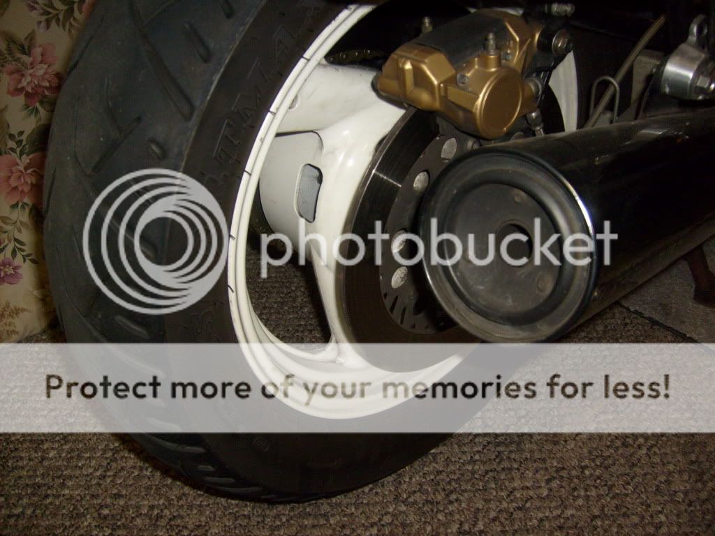

I found at (of all places) 99cent only stores, a large bottle of this stuff called Pro Power Stainless Steel Cleaner.  This stuff kicks a$$ on the rear wheel grease like no ones biz.
Take a look at my white wheel
I have a few rides on this without a cleaning.  When I do clean it, the grime comes off real easy with minimal work.  Use rubber gloves when you use this stuff.

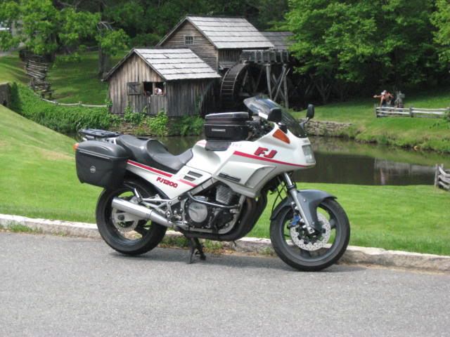

Here's a 2005 shot of my '84:

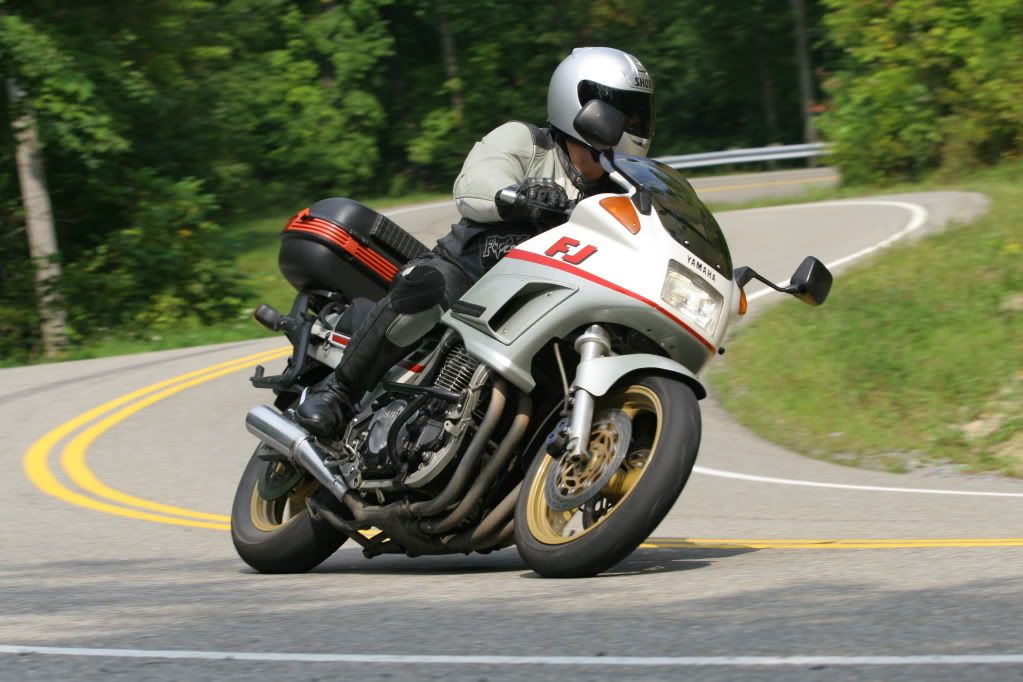

Here's my '92:
