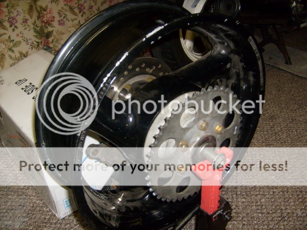

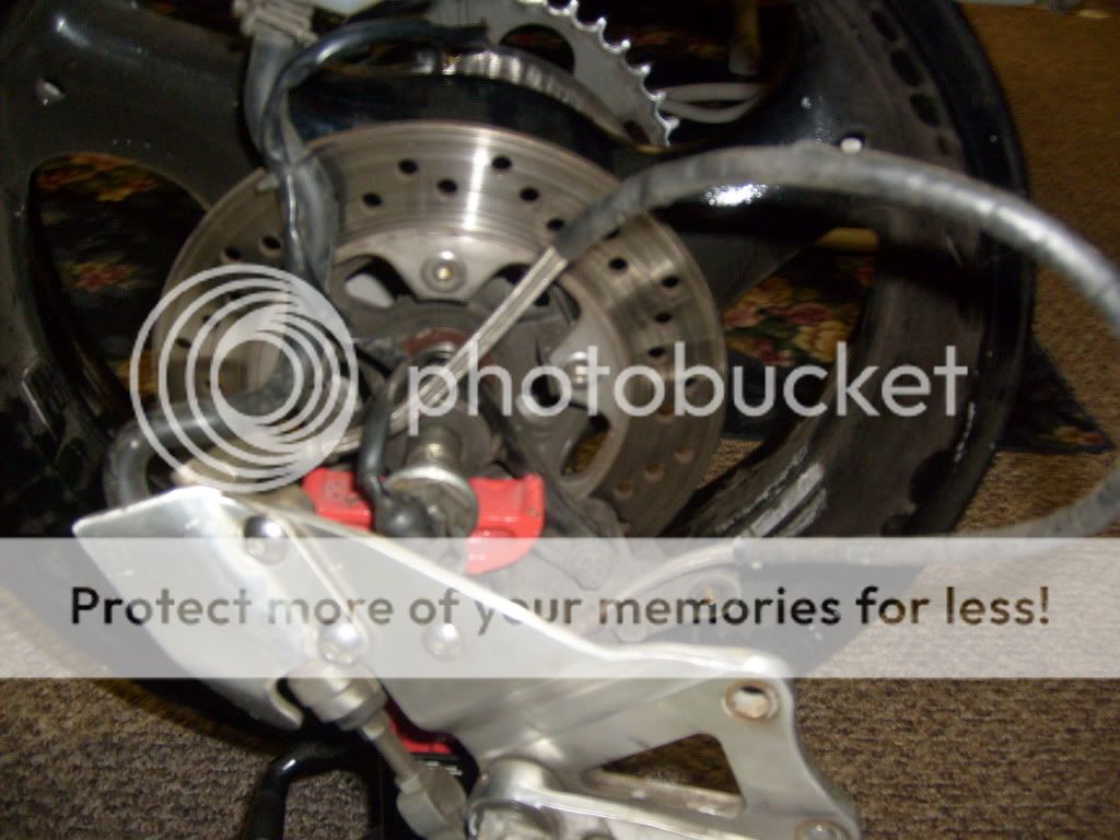

OK Guys,
My GSXR wheel has arrived, :yahoo: however, missing the spacer between the caliper carrier and the wheel.  Also the brake arm.  No worries as I contacted the seller and he will send them along.  Should have them next week.
However, the sprocket is worn out, and I need to replace it.  Need a 530 40 Tooth.  Any suggestions under $60?  Steel or Aluminum???  Is AFAM a good name?
Also, my wheels are white, this one is black and has a better finish than the front.  Decisions
, decisions, paint the front black or paint the new one white???    :scratch_one-s_head:
CraigO
90FJ1200
CraigO
90FJ1200
