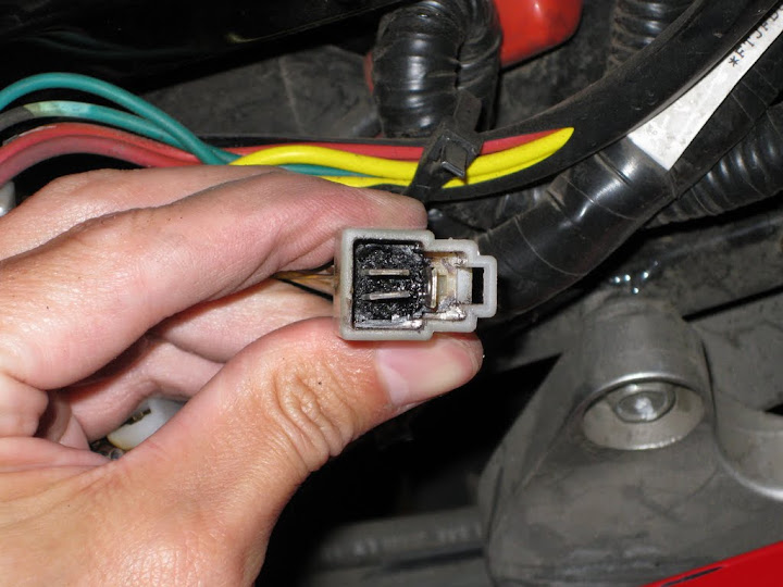

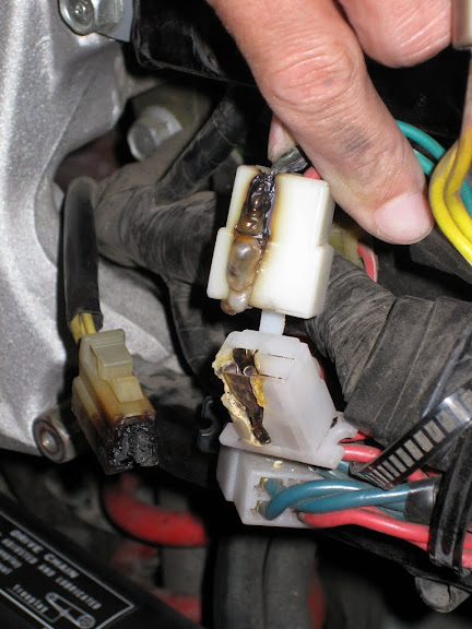

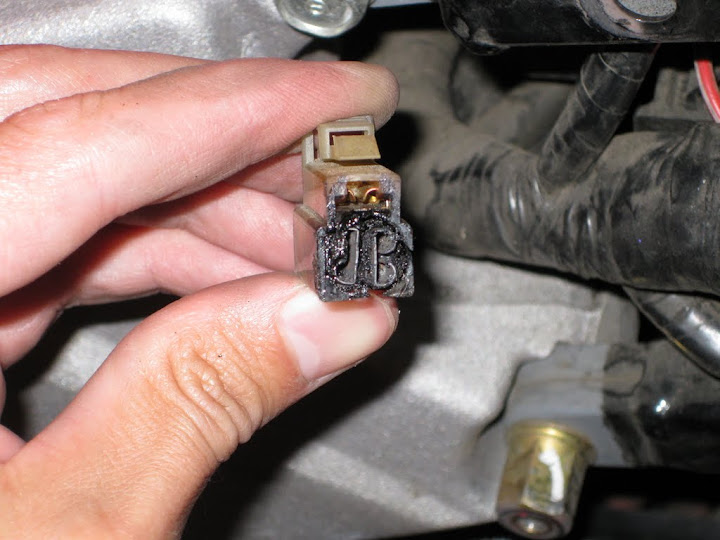

oh... I'm fully aware of the R/R issues..  :dash2:
The bike has the upgraded harness built by the guy at www.wiremybike.com installed but there are deeper issues.  Appears to be a grounding issue, and the cooked connector from the stator to the R/R is a common thing.  Others have cut the stator wires as far back as they could then solder a heavier 12awg wire and that helped the overheating problem.
I am in contact with the person who made the "VFRness" wiring harness and he's sending new connectors and pins.  Stator seems to be ok, but the state of the R/R is unknown.  The ground wires on the R/R are very stiff and not all that flexible, but the A/C in and D/C out are fine.  To think I rode it 3+ hours back here, and the PO did a multi-day trip on it and it was still running.

When I went and looked at the bike the PO didn't set off my scumbag alert.  Just an average Joe who needed to pay the tax man.  He had an Aprilia Falco before and sold it because he wanted out from under the payments.  Then bought the VFR with the profits from the Falco.  He's an active member of a forum dedicated to riding in the PNW.  I didn't get the impression at any time he was being at all dishonest.  Only had the bike 9 months and put a tad over 3k miles on it.  This sadly is a common thing with these bikes and sometimes takes a bit to get it all sorted.
I can fix this, it's just a matter of tracking down the root cause.  I already plan on beefing up the connections from the stator to the R/R and the grounds.  I've been doing a lot of reading on the VFR boards and upping everything to 12awg wires helps a lot.  Many have used a late model R1 R/R as a replacement and report it runs much cooler and the overheated connectors and wires are no longer an issue.  Plus the R1 part is way cheaper on ebay than a new aftermarket one.  It's looking like the grounding inside the R/R is bad.

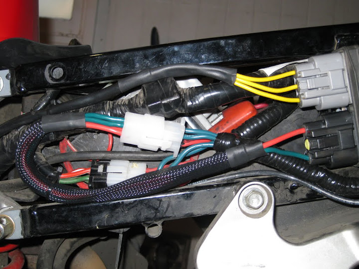

Things are much happier now.  I used a newer mosfet R/R off a ZX-10, and got the factory connectors for it.  All connecting pins are crimped and soldered.  No melted connectors or wires and very stable charging.
