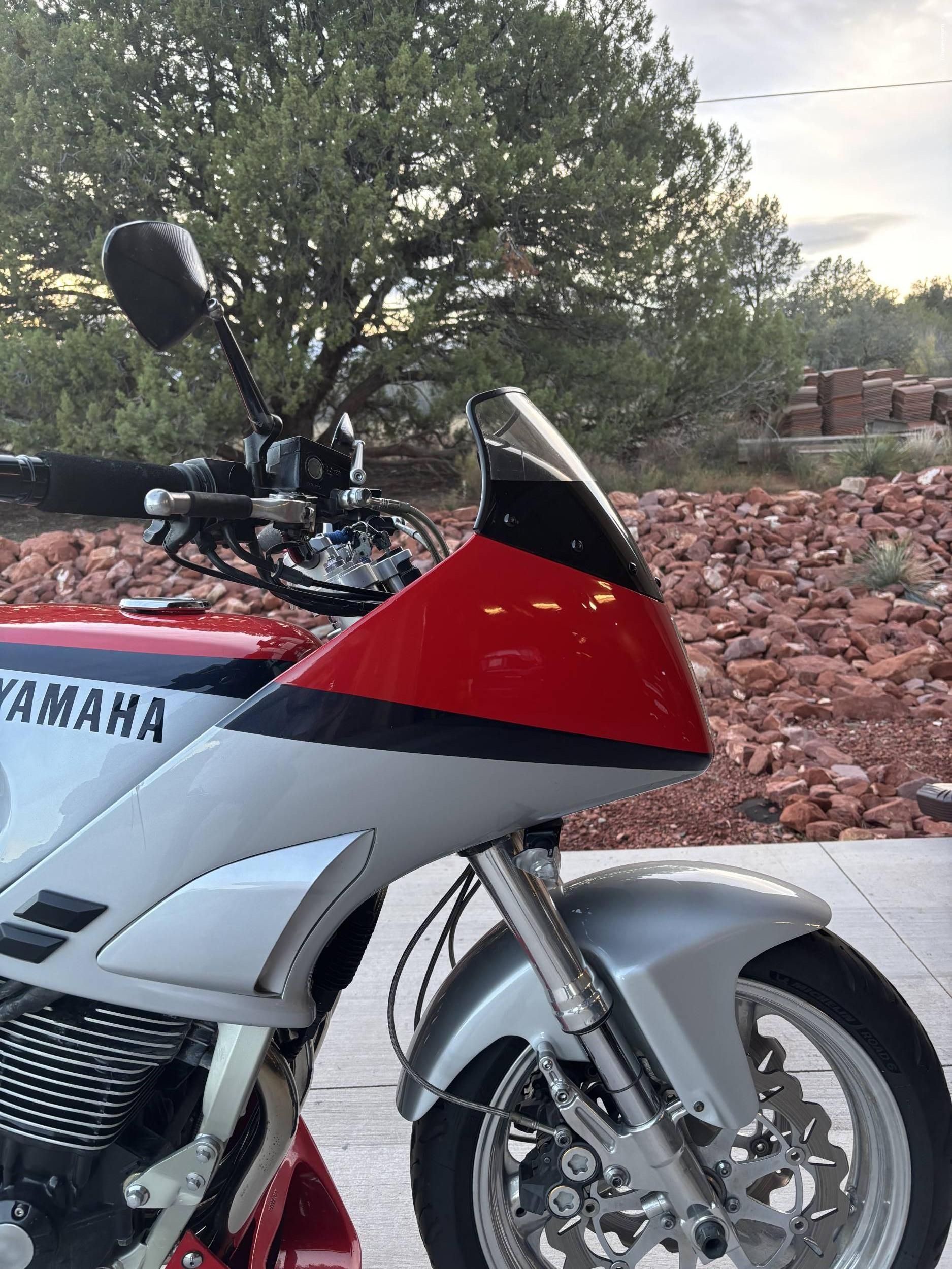

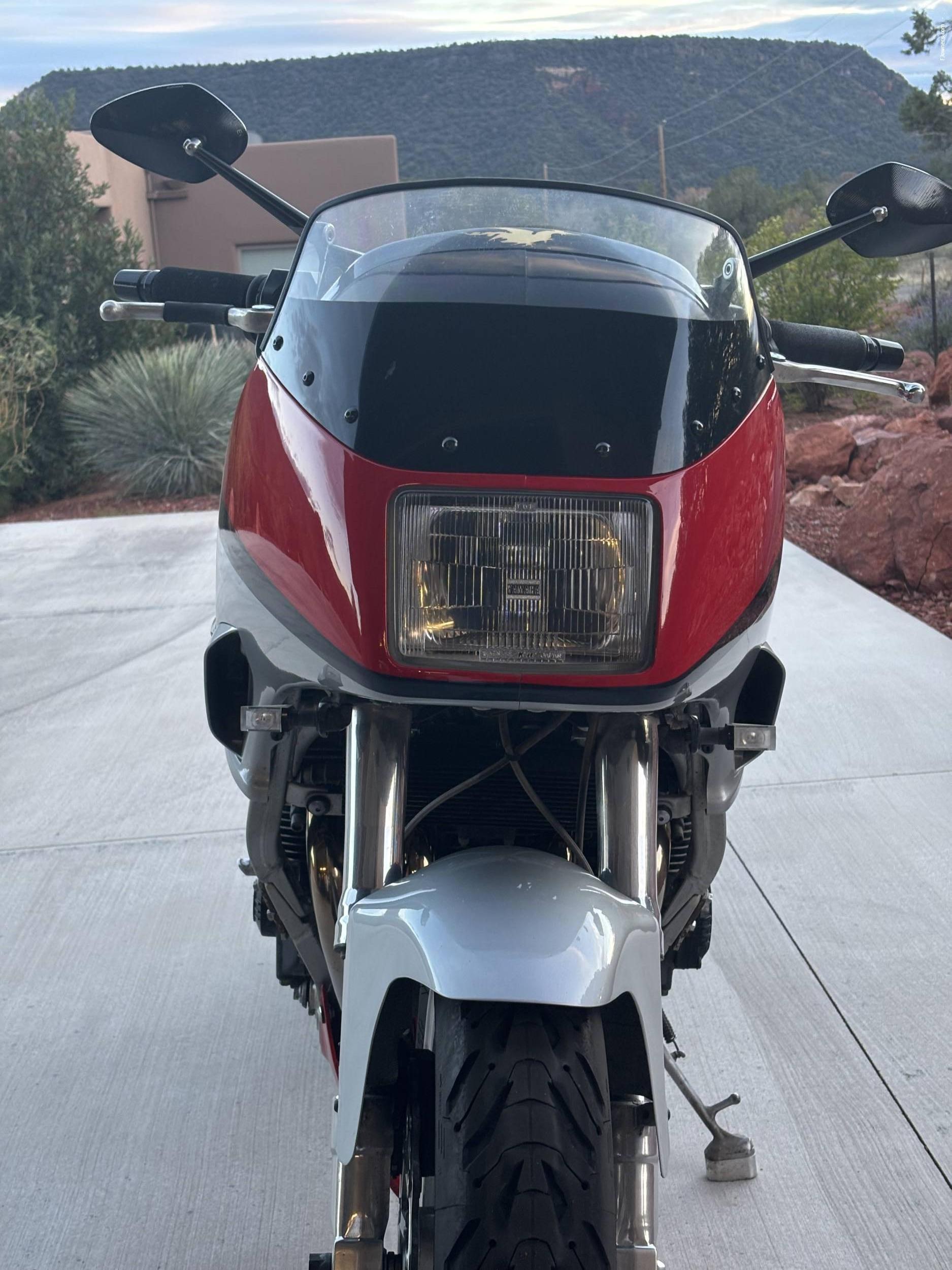

I had a cracked oem windscreen I decided to do an experiment with...I cut off the top 10" were the crack was and cleaned up the top line of the screen.
Here's what it looks like:
This moves the wind line down to my mid chest area and the result is my helmet is in cleaner, quieter air.
The Rizoma mirrors also move the wind turbulence down and further outside of my torso vs. the oem Mickey Mouse ear mirrors.
I still have my oem height windscreen. I'm not sure I like how this short screen looks. Just not used to it.
However, for my height, it is a noticeable improvement in lower wind noise.

Quote from: Pat Conlon on Today at 12:59:43 PMHere's what it looks like:
My Helmet is just above turbulence, only problem with taller screens is that you don't get any cooler air.

Before you trim your windscreen you can remove it to see if you like the effect.  I did on my '84 and liked the free air so ended up trimming mine as seen.
