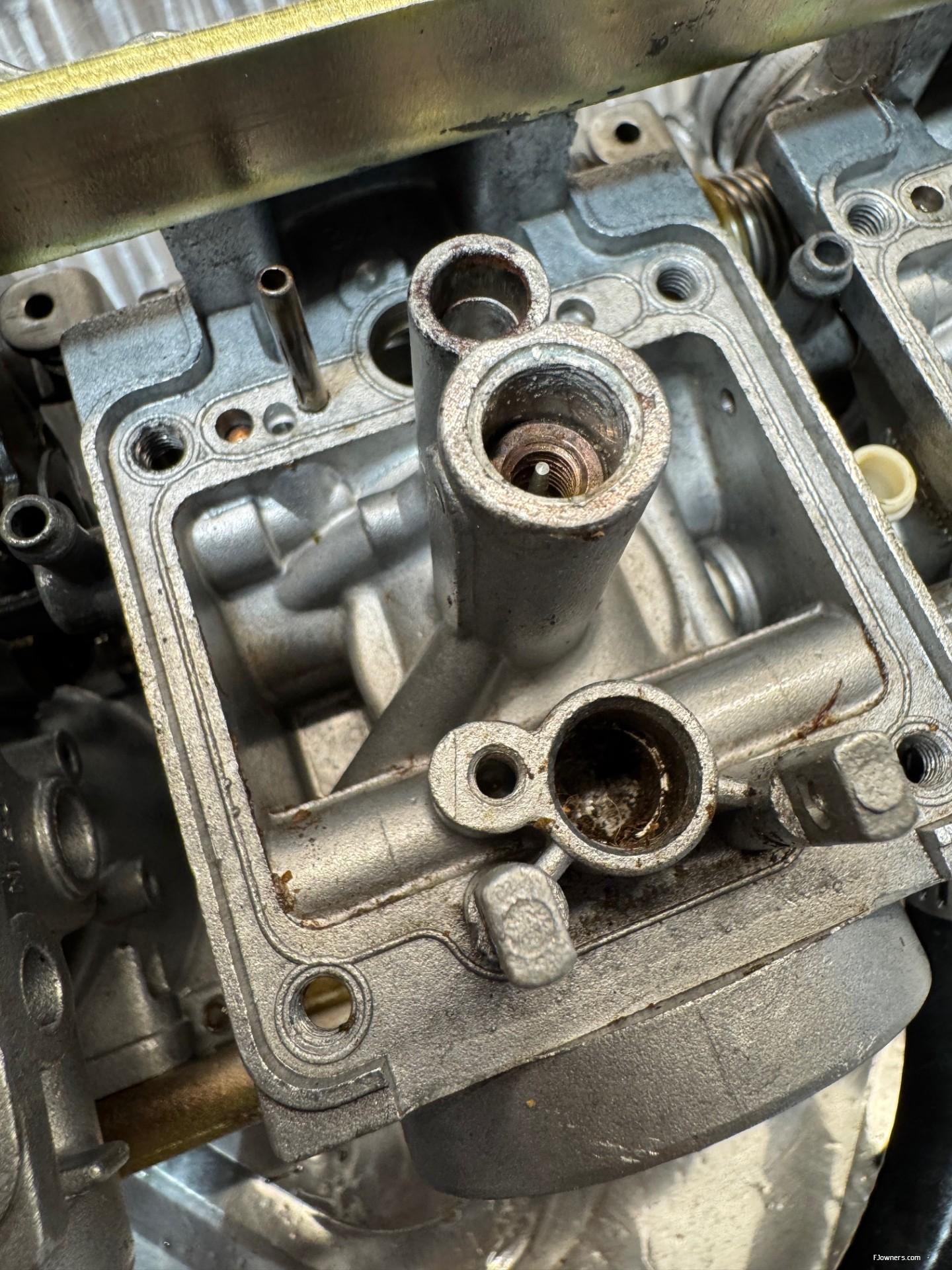

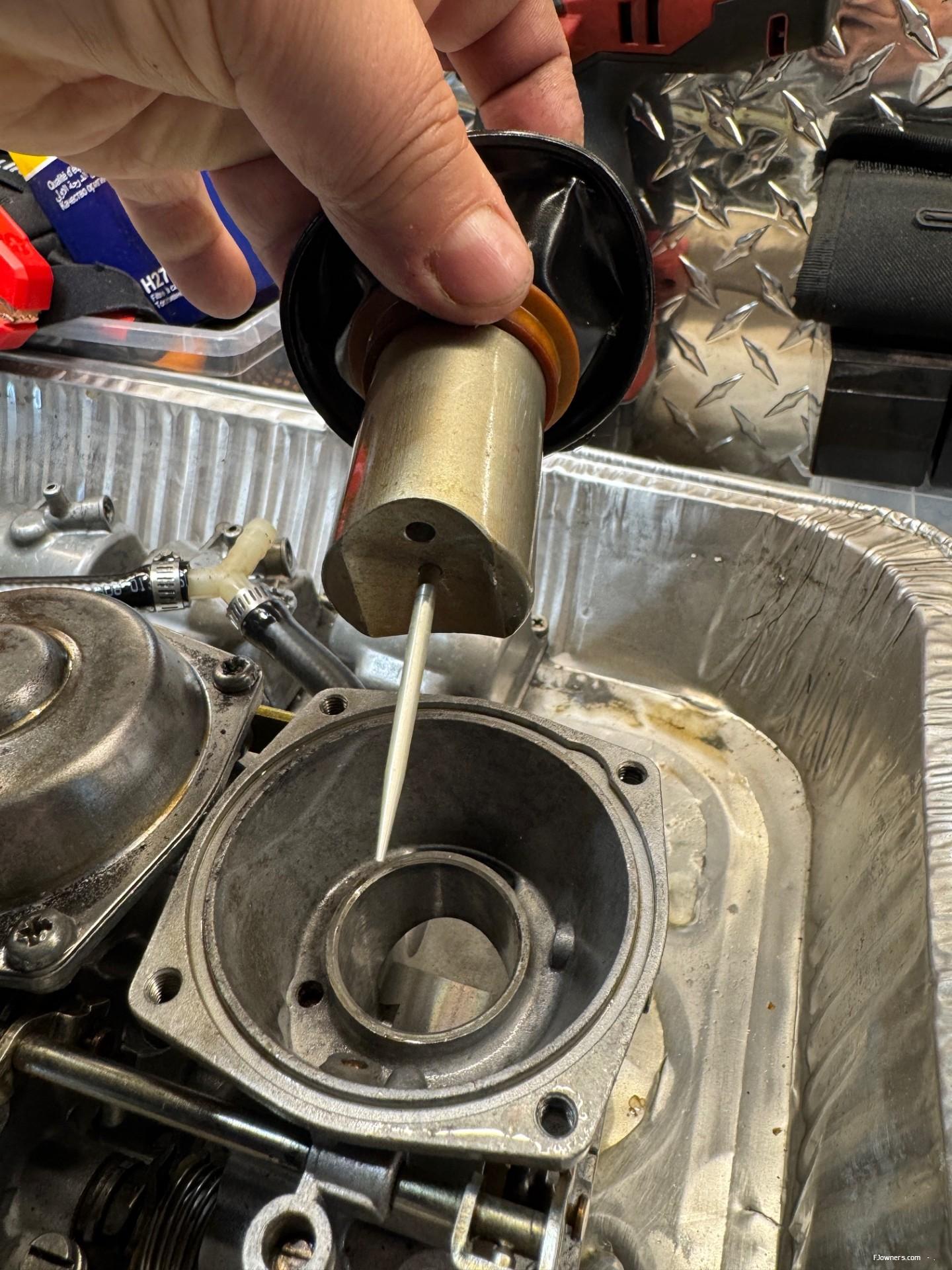

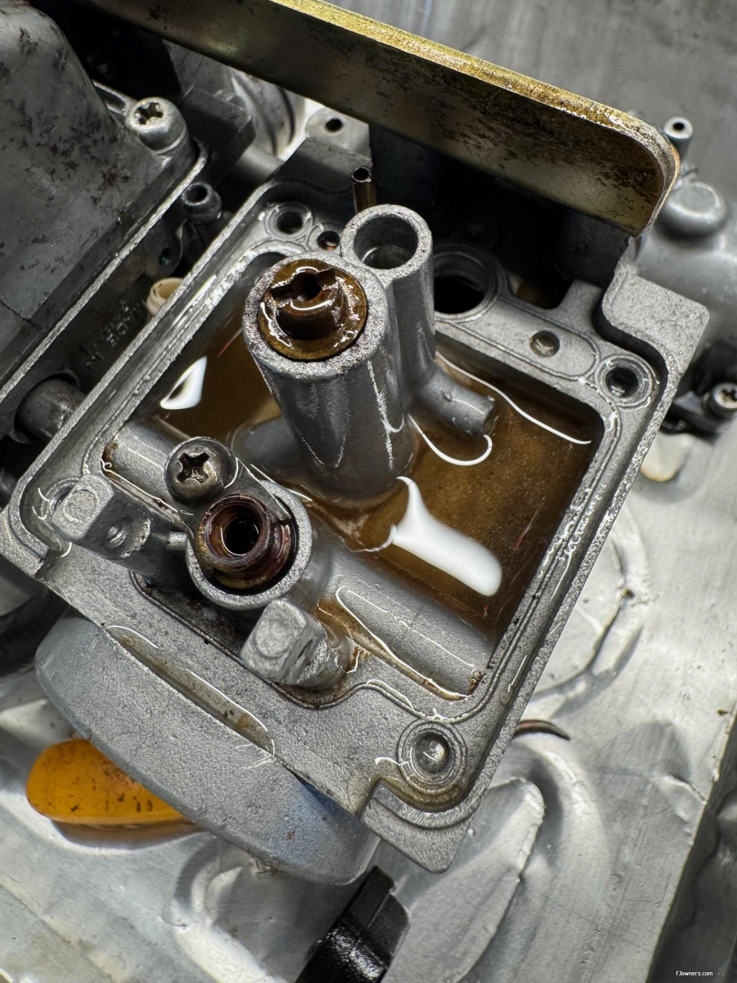

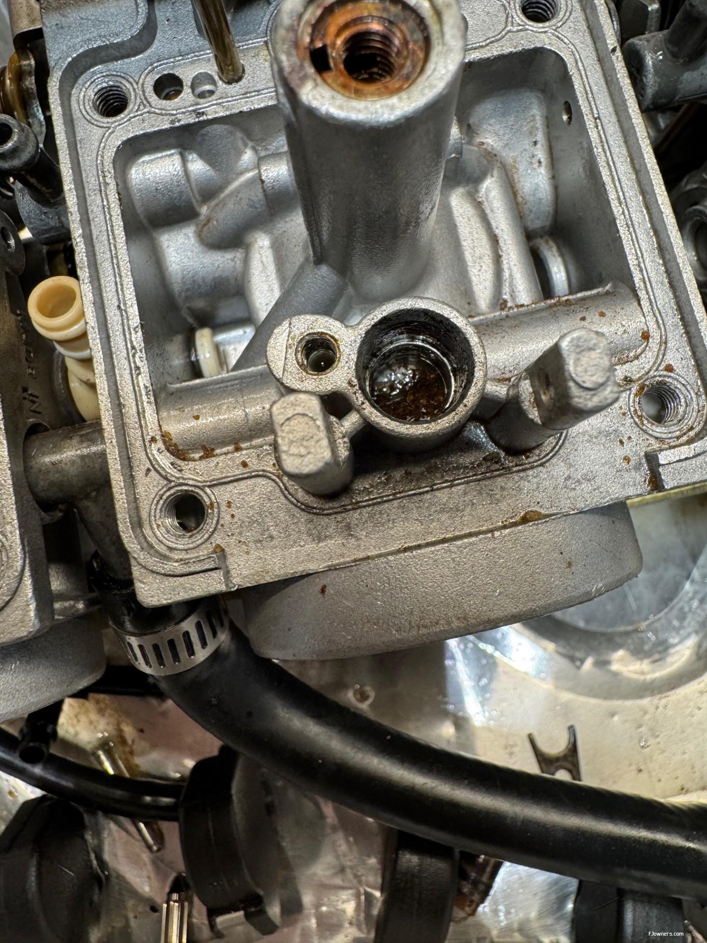

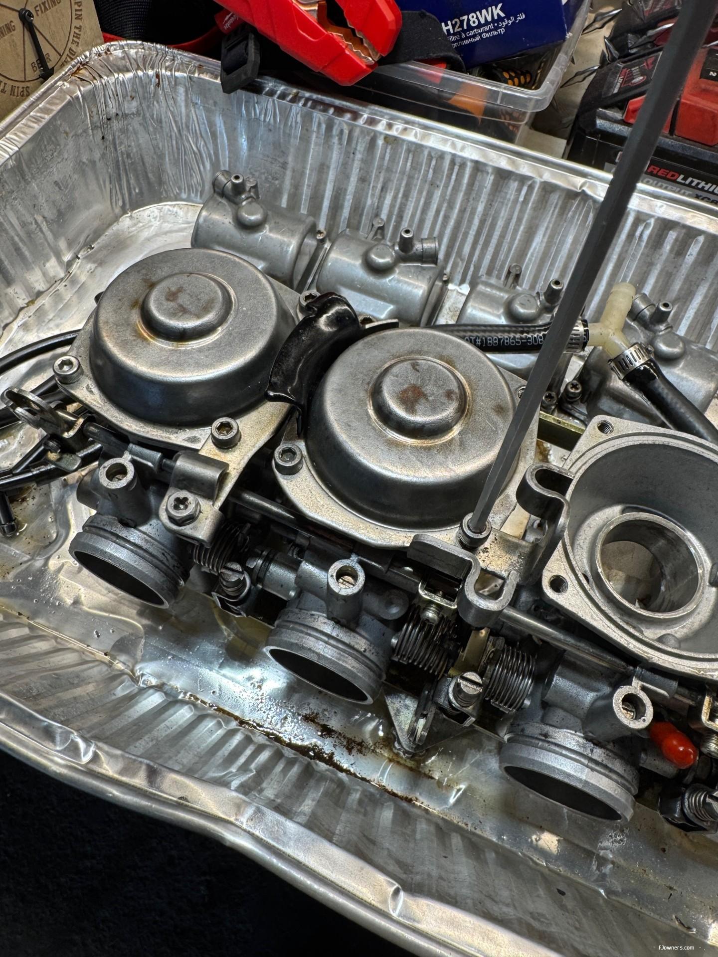

Time to get to carbs. Previous owner said that they were rebuild and adjusted.
Doesn't look like he did good job  (popcorn) . Probably one of the reasons that carbs are so bad is tank.
Will take them completely apart. Ultrasonic cleaning will be next step.  What do you guys use to have them clean to factory condition?
Next step order rebuild kit and jets. Carb body looks good and tight.
Already spoke with Randy and will order 117.5-120/40/155 jetting plus rest of the parts as a kit. Maybe add UNI_PODS. I don't like KN filters at all.
Since this is gravity feed, how you guys run fuel line if you want to add fuel filter?
Cheers!

That being said, tank will need to be cleaned up and maybe sealer installed. I will see after cleaning tank what I am dealing with. And petcock has screen.

axiom-r
Quote from: MarioR on Yesterday at 12:07:55 PMWill take them completely apart. Ultrasonic cleaning will be next step.  What do you guys use to have them clean to factory condition?
This is a great question. I too am interested to hear what others use in their ultrasonic cleaners to get the right "look" on the carbs.  I have asked about this before (elsewhere) and have never found any firm answers.  Who's an expert on ultrasonic solutions their effectiveness for cleaning and the sheen that remains?
Cheers!  tim
RPM - Robert
Quote from: axiom-r on Yesterday at 07:23:59 PM
Cheers!  tim
Chem-crest 235 @ 180f
