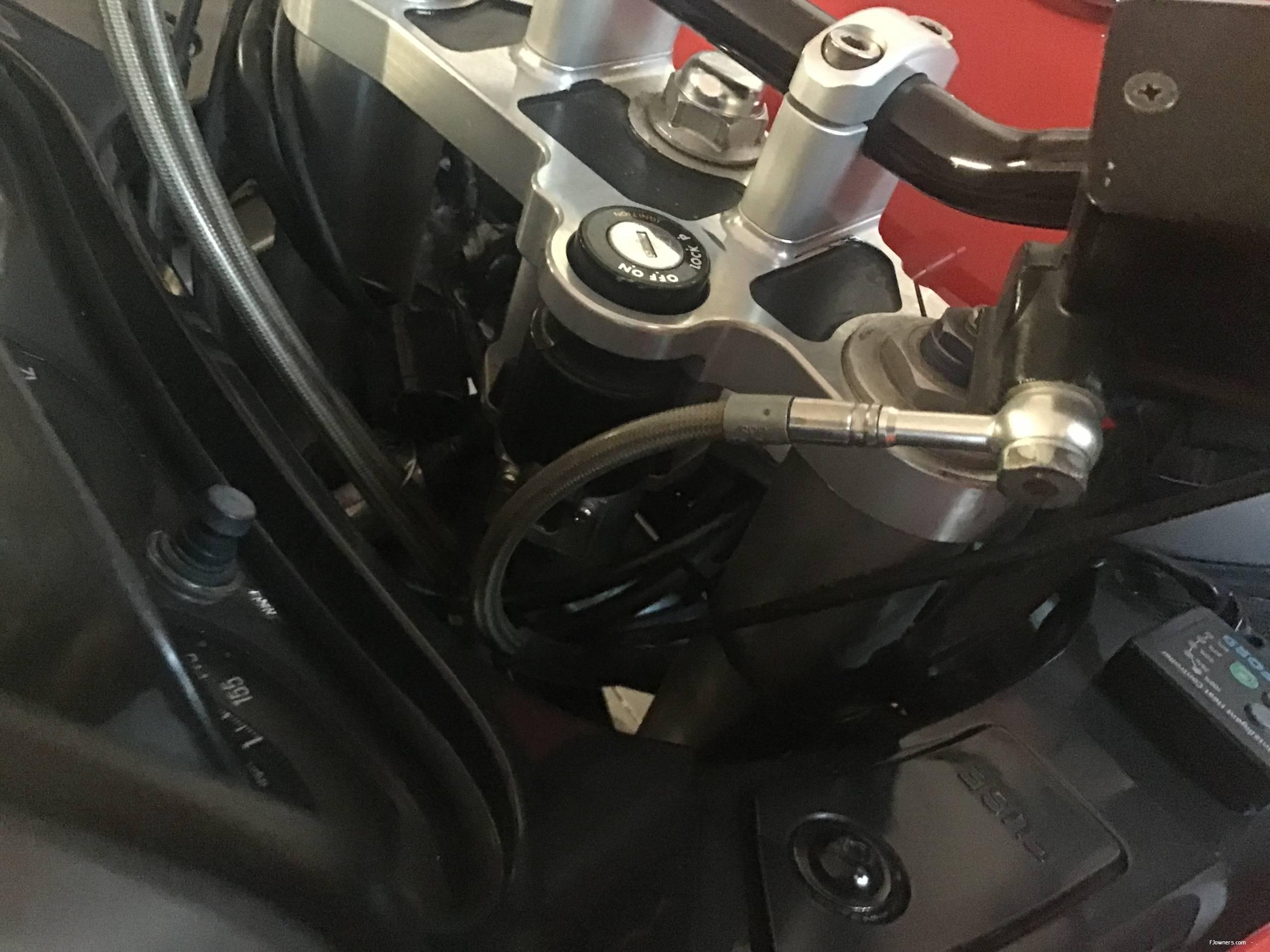

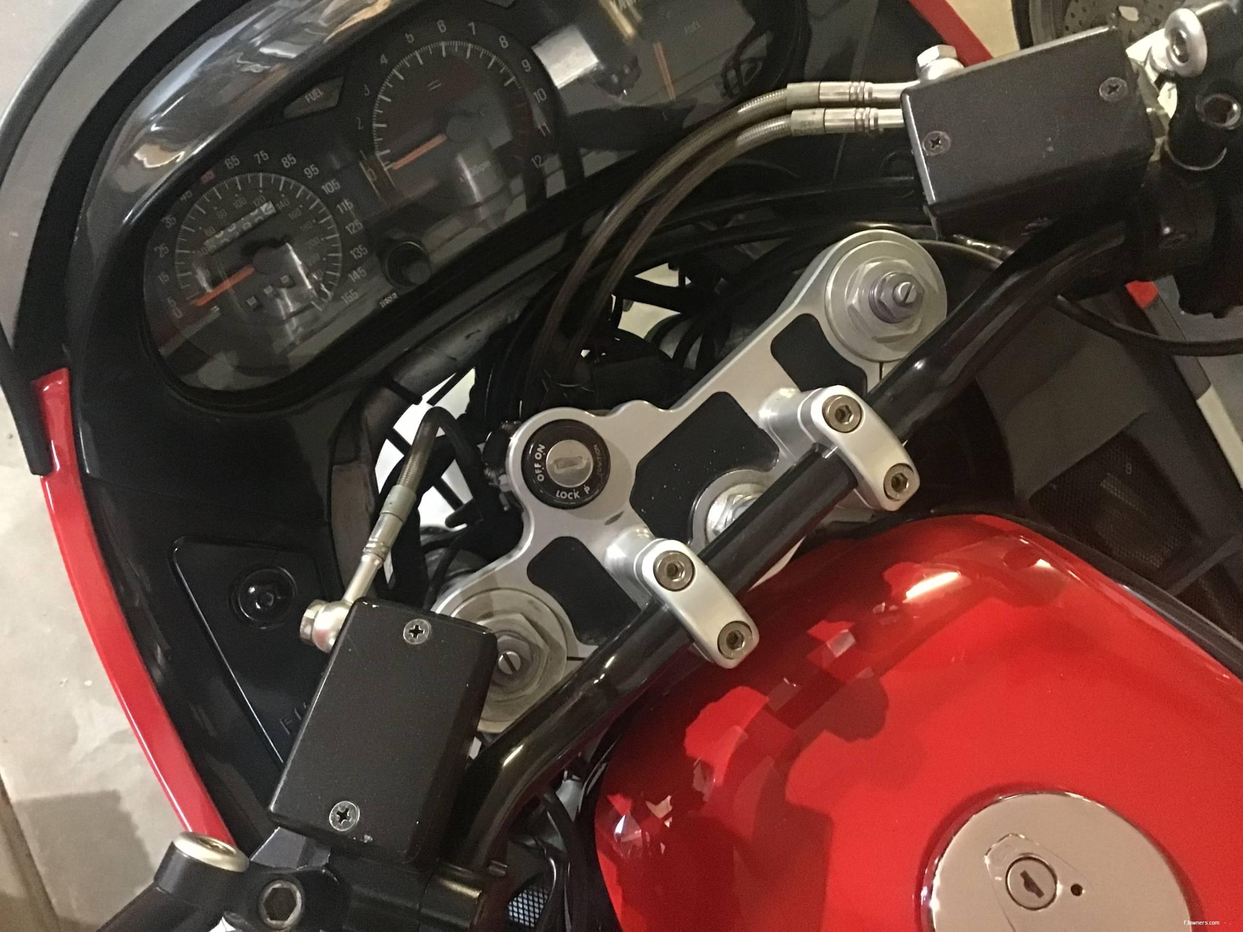

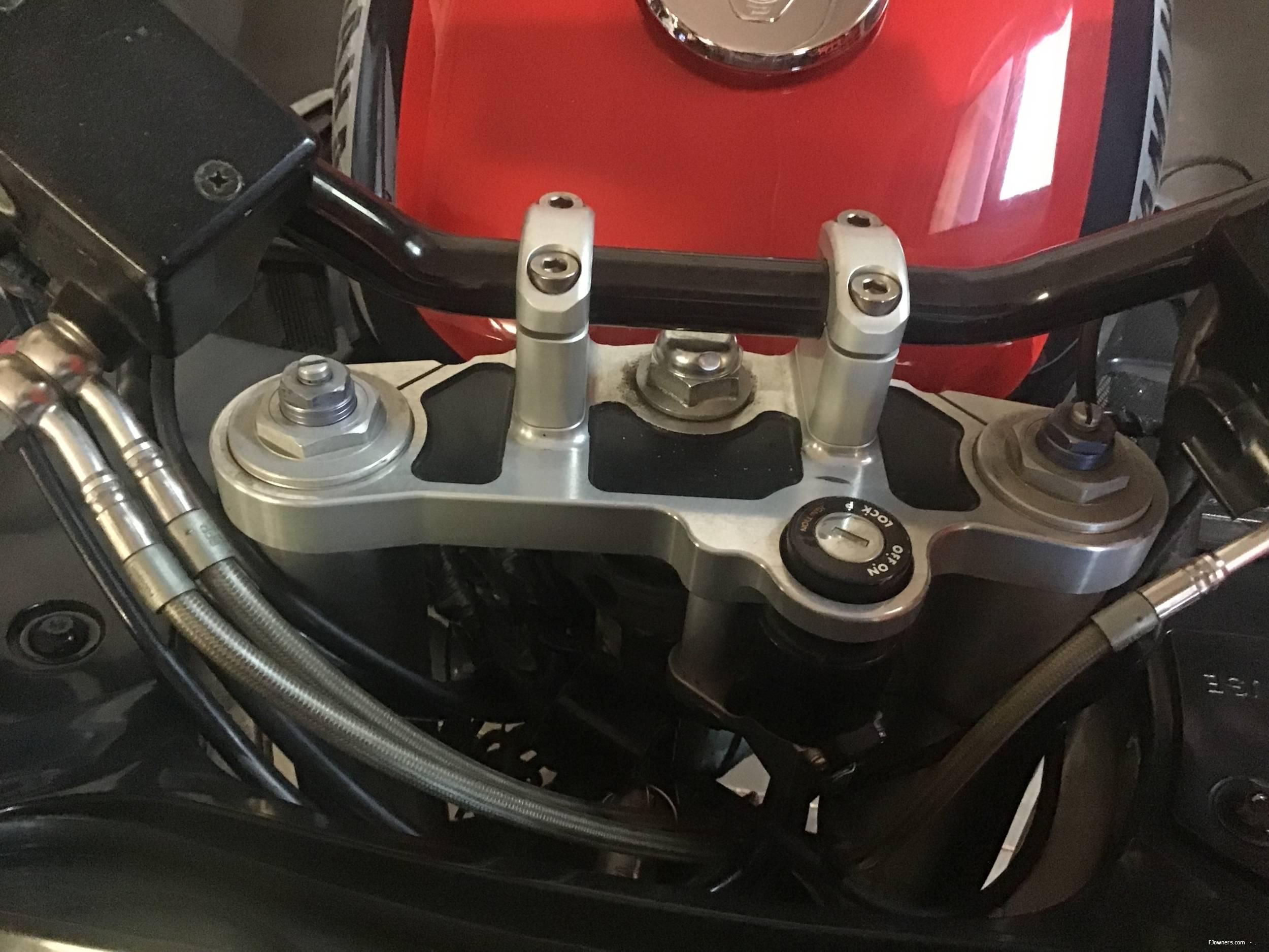

The LSL top triple had the ignition switch offset to the left. I had to shim the barrel of the lock to fit in the larger diameter hole on the top triple.
Of course, with the offset, I don't have a fork lock anymore...no big deal.
I'll try and snap some pictures.

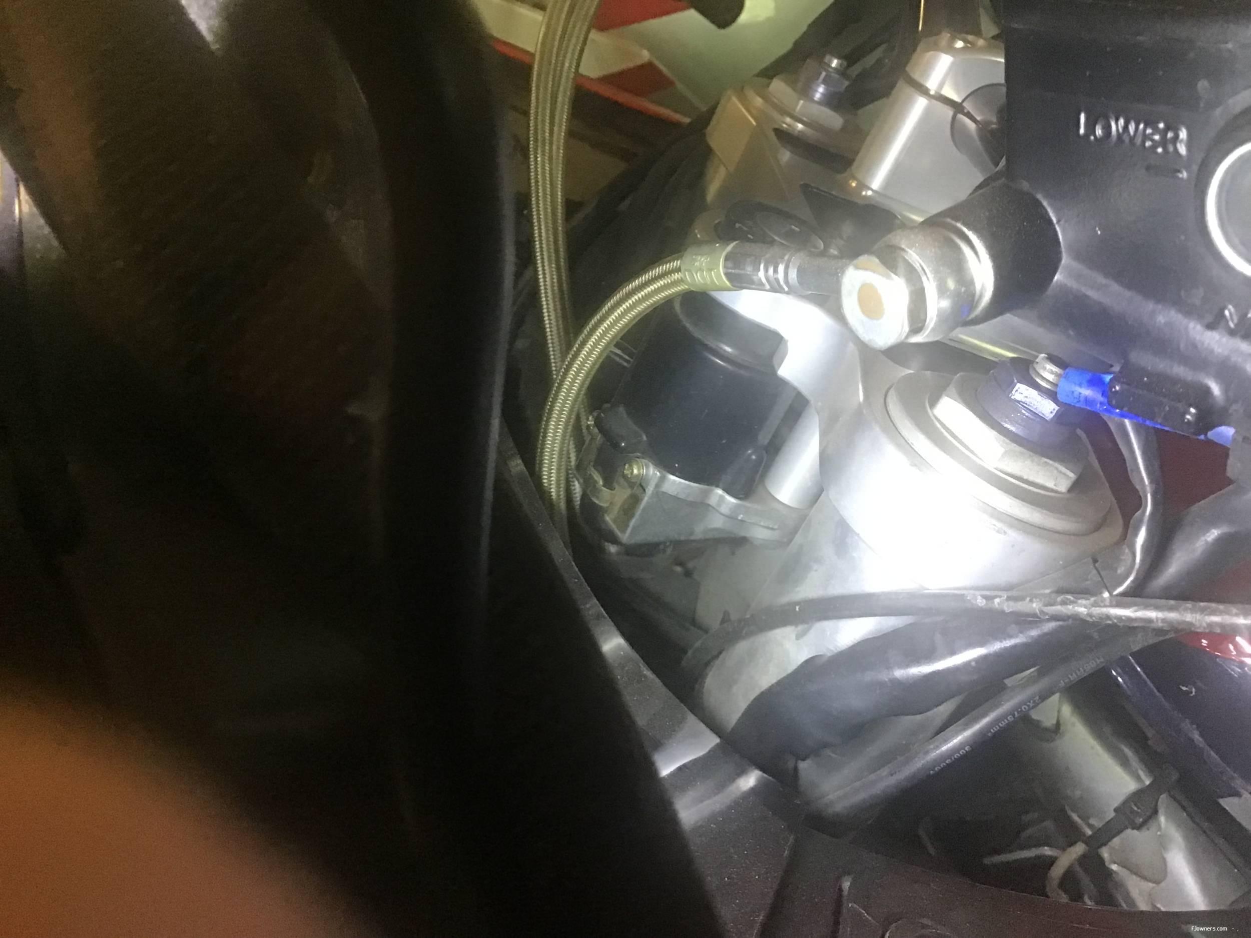

 To be honest I can't even tell what you did. Looks like a 100% factory install.  :hi: Did you have to modify the mounting lugs on the underside? Or did the switch mount up at the correct height? I have never once used my lock, so no loss there.

Thanks Daniel...
I think that's the best compliment...a finished mod that looks oem.
I didn't need to modify the lower mount on the ignition switch. You see how the top of the switch barrel pokes thru the LSL mount ring? So the barrel length is not critical...it ends up where it ends up...no need to mess the lower mount.
