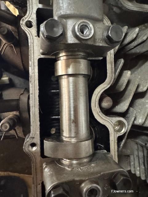

Just picked up spare engine 1200 with 25km only. Engine is clean stock with 160-165 compression across. Stock cams were taken away to legend car however I got as a replacement racing cams. No info about cams. Looks like old stock inventory, brand new. Nothing I can find on the cams them self's. So I measured them yesterday and looks like intake lift is 0.375 and exhaust is 0.365 (raw measurement with caliper so there maybe a bit tolerance). Looking for the cam lobe profile, nose is pointy and overall base shape is slightly bigger than stock. Looking through out webcams, megacycle, Yoshi, Kent, etc. and it is hard to say what I have....
1. Based on the measurements, do I need stronger springs? I think I do...
2. Since cam brand is unknown, how to find tolerance for shims?
3. What shims should I start with to set it up as a beginning?
4. Can someone clarify shims on top vs under? My understanding is that stock design motor has shims on top. And for example FZR1000 motor has small shims under bucket. That being said, with high cams conversion is needed to shims under?
5. What about cam sprockets? Does it need to by modified to adjust timing?
Thanks :drinks:

Cam base I think is slitty bigger than stock but to be completely honest, I do not have spare cam to measure. This is just observation based on looking it from the side of the lobe, where material is added. To be checked and confirmed. Will try to post some pictures.

Those a definitely welded cams. They will have a stamp on them someplace is done by megacycle or web.
Yes, you should use slotted cam gears to set the cam timing.
The stock shim configuration will work fine.
Don't turm those cams in that motor, the one photo ahows there is no shim in the bucket.

Yes, there is no shims at the moment, there are in my box with shims :good2: Eagle eye
Can not see anything stamp on the cams, however I will pull them out and double check including measurements.
What tolerance should I follow if no stamp brand on the cams???

With .375 lift - sounds like megacycle 268-00 grind.  I think these are a great street cam.  They could also be web cam 540 grind at .385 lift.  I have read issues with an earlier web cam grind with same lift and duration - 163 grind - but they tended to float the valves and put the closing ramps on the cams.  Supposedly the 540 grind replaced the 163 grind and had better valve train control.  https://forums.13x.com/index.php?threads/web-cam-hard-weld-camshaft-problems.307587/  (See post #13).
Would be really good to find the markings on the cams.  I've seen them marked on the edge of the mounting boss for the gear, and have seen them marked on the shaft itself between two of the lobes.

Cam shows at the front 555 009, other end P9C

Like I said before, I was able to find is this number 555 009 on the front of the cam. Nothing else. Measured cams so I know approx, what they are.
